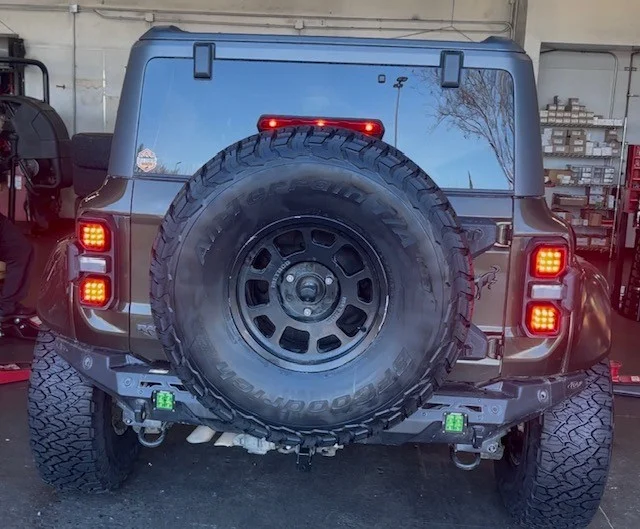

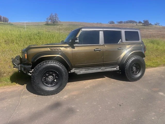

UPDATED: They were able to squeeze me in yesterday am. A couple shots attached for some valentine's day eye candy!! Can still see my tail light.. woot.

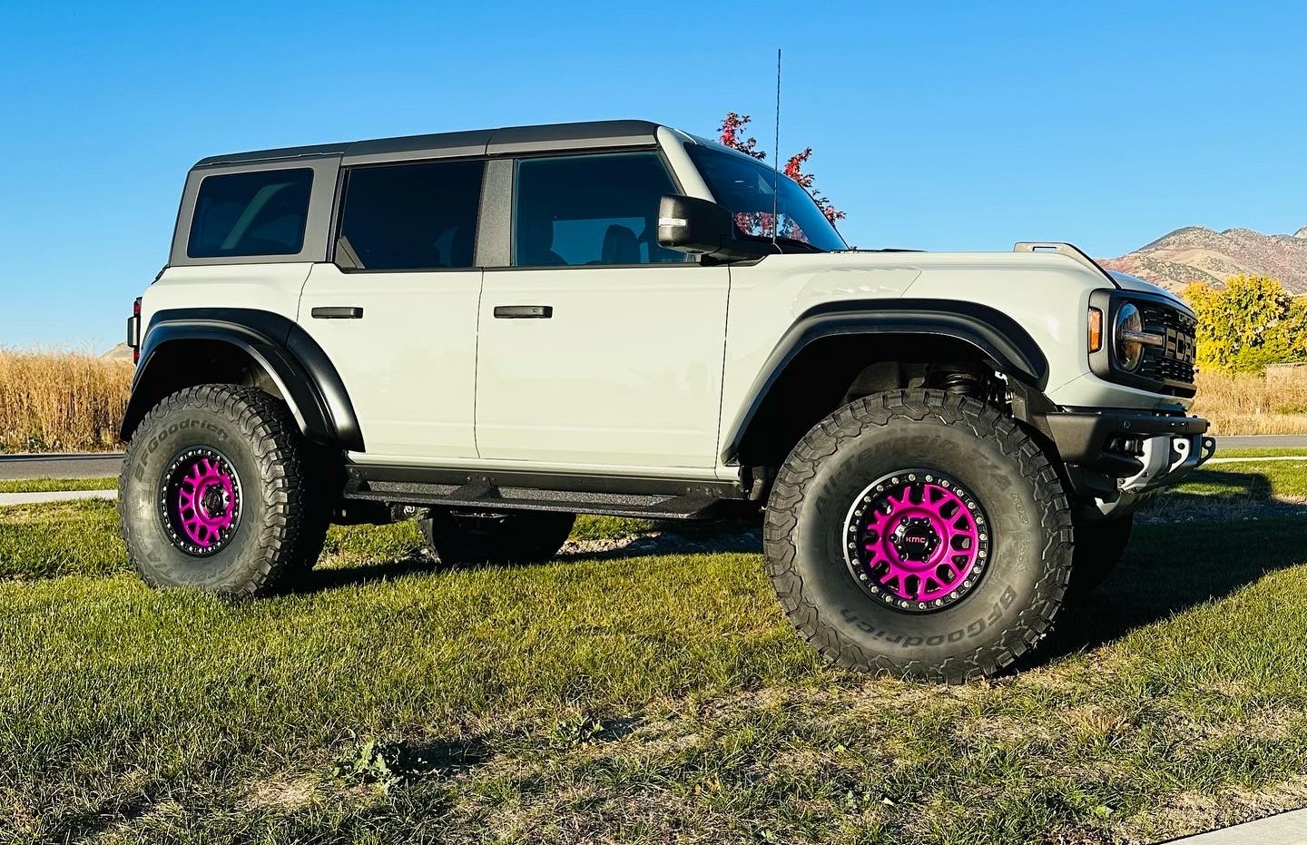

@Tye has been running the 39x13.5x17 BFG K02 tires for several years with +18 offset RTR wheels and collars. The +18 offset places the inside of the 39's in the same location as the stock 37's tires & wheels, which is ideal. I mentioned him here so hopefully he'll chime in for you.

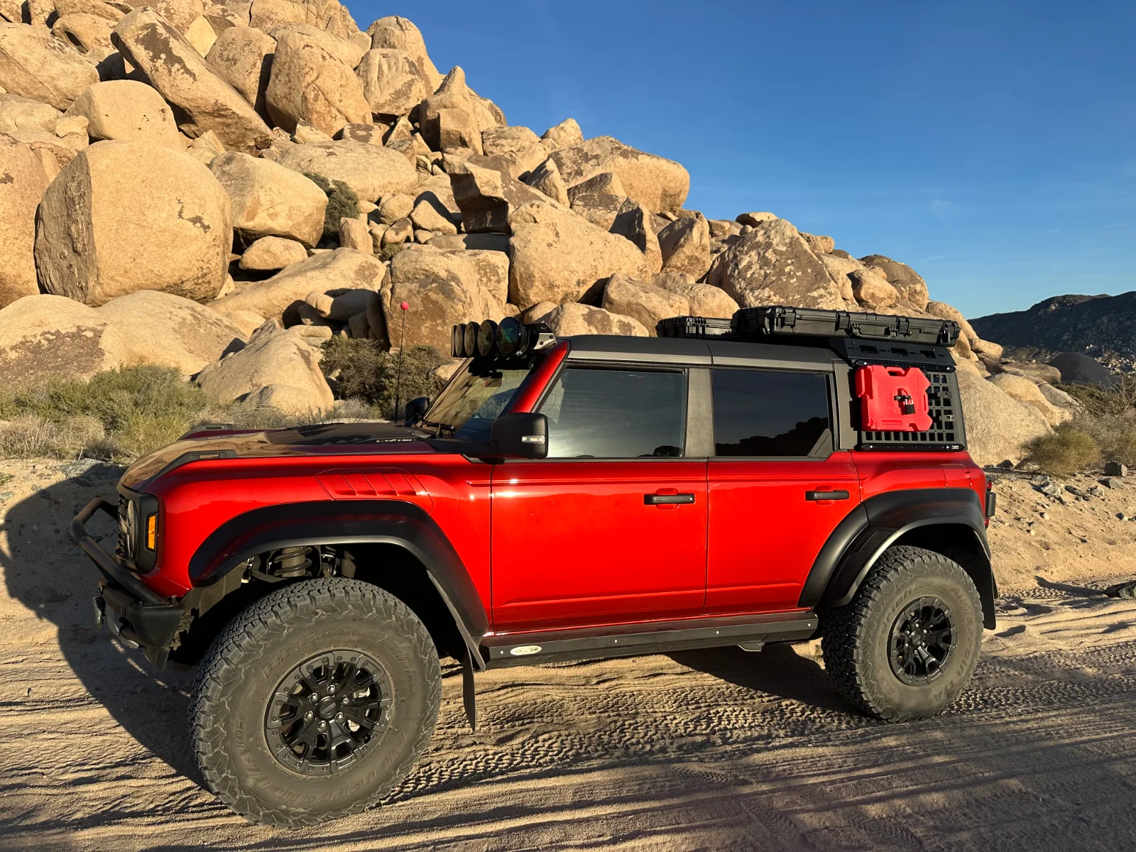

Ive been running the 39" ko2 and rtr wheels since 2022. I do not rock climb but I do baja run. I have had zero issues with rubbing or the stock steering rack. I run foutz half tie rods. Lift collars or equivalent height increase is absolutely necessary. I drove around for a week before I added the Lift colors and the setup will rub even on the street in the right circumstances.
Thanks @Tye. What lift collars did you use? Seems like the cheapest solution that I am seeing online.. Appreciate it.
RPG 1.5″ front, 2.25″ rear

Looks killer. Interesting on whether or not the front will or will not blow the fenders off at full squish. Im pretty sure they will. A lift will not stop that. But, it will help with daily and “normal” off roading. Bfg 39s, I feel, work well because they run smaller and look just right. I think if you understand the possibilities of blowing the fenders up, then you just run it to the limits you know will make that contact. So no 5’ jumps for the gram, lol.
I have jumped mine many times and have had full tuck and not blown the fenders off.
Here is another guy that ran 39s early on, wheels his really hard, and had no issues
Nice! Very interesting to see the different real world experiences. Fenders can pop off with 37s at full retard squish. Lucky you!! But, to be honest, I haven’t seen any videos or pics floating around with 39s being hucked and landing and all is good. On a dirt track with jumps having a nice down slope landing is where I feel the fenders have a chance😂.

Awesome, lol! Definitely not a deal breaker. I may want to go bigger down the road, as well. What I do like seeing are all the Braptor being sent hard and fairing extremely well on landings. Fenders are the least of worries. I bet a lot has to do with offset of wheels.

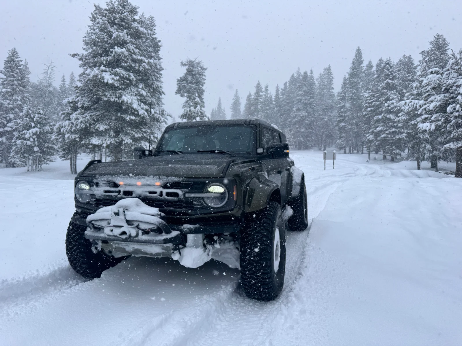

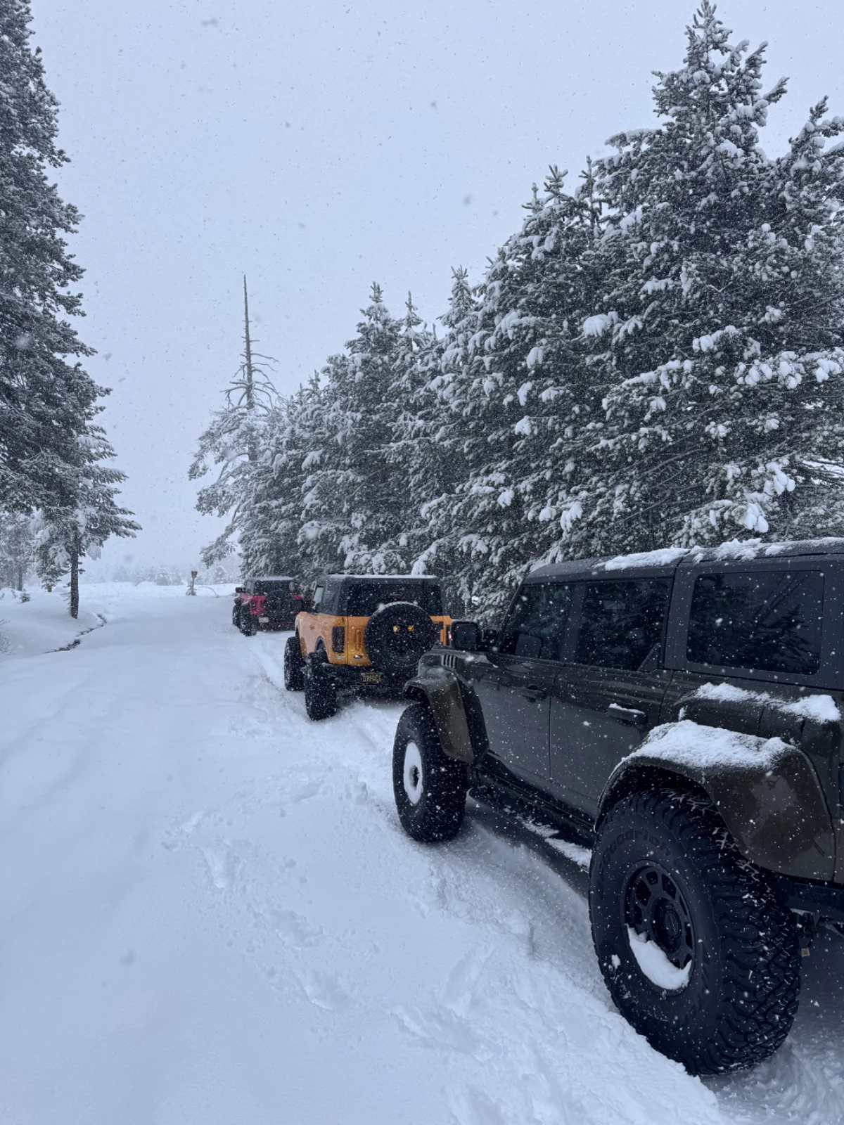

UPDATE: Had the opportunity to snow wheel in the Sierra Nevadas yesterday with johnnygalt and another buddy. Everything being stock other than tires and me taking the fog light section of the front bumper off the day before, because I mashed the front end last June on a rock and my right front didn’t have clearance 🙄.
After foggy light removal plenty of clearance, again running 0 offset method bead grips.
We wheeled all day with some decent articulation at slower speeds and the only flare that rubbed was my rear right due to my having obliterated it several times already.
So solid first report. Once I’ve got the springs and top hats on will send it and report back. Stay tuned!
