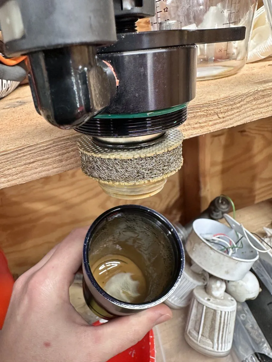

Just emptying my catch can and this is what I find. Is this normal? Not only is it in the can but if you look at the filter it’s cover as well. I have a few other catch cans on my vehicles and haven’t seen one like this before

Yes, occurs in cooler high humidity climates, those in the southern states don't have the moisture mixed into the catch.
Awesome thank you so much. I am in the PNW and it is getting snowy here.

The engine oil will be the anticipated black at oil change time, not milky, as it shouldn't have the added moisture.
