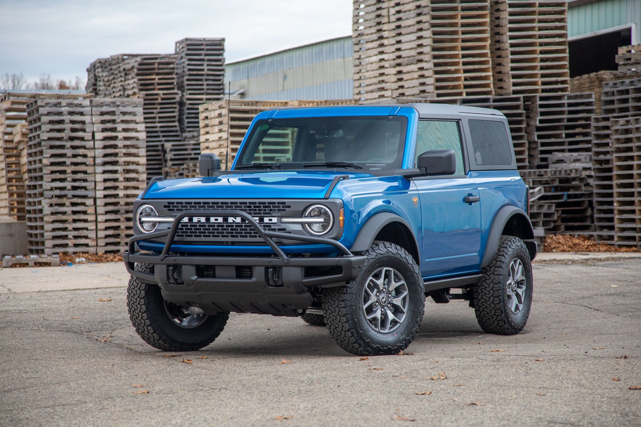

First, meet Larry. Larry is a 2023 Cactus Gray I picked up used with 13K miles from my local Ford dealer. I literally stumbled on Larry just after being traded in and before being cleaned up and presented for sale. I purchased Larry on 12/31/24 with a Ford Blue certification despite having a mold in top that had one crack and not having the rear window glass recall done. And Larry came with an aftermarket blowoff valve, Rockslide Engineering Step Sliders and a number of smaller convenience mods throughout. I admittedly scored despite the crack in the MIC and I went in eyes wide open.
Larry, relatively stock and Jolene, left, not so much.

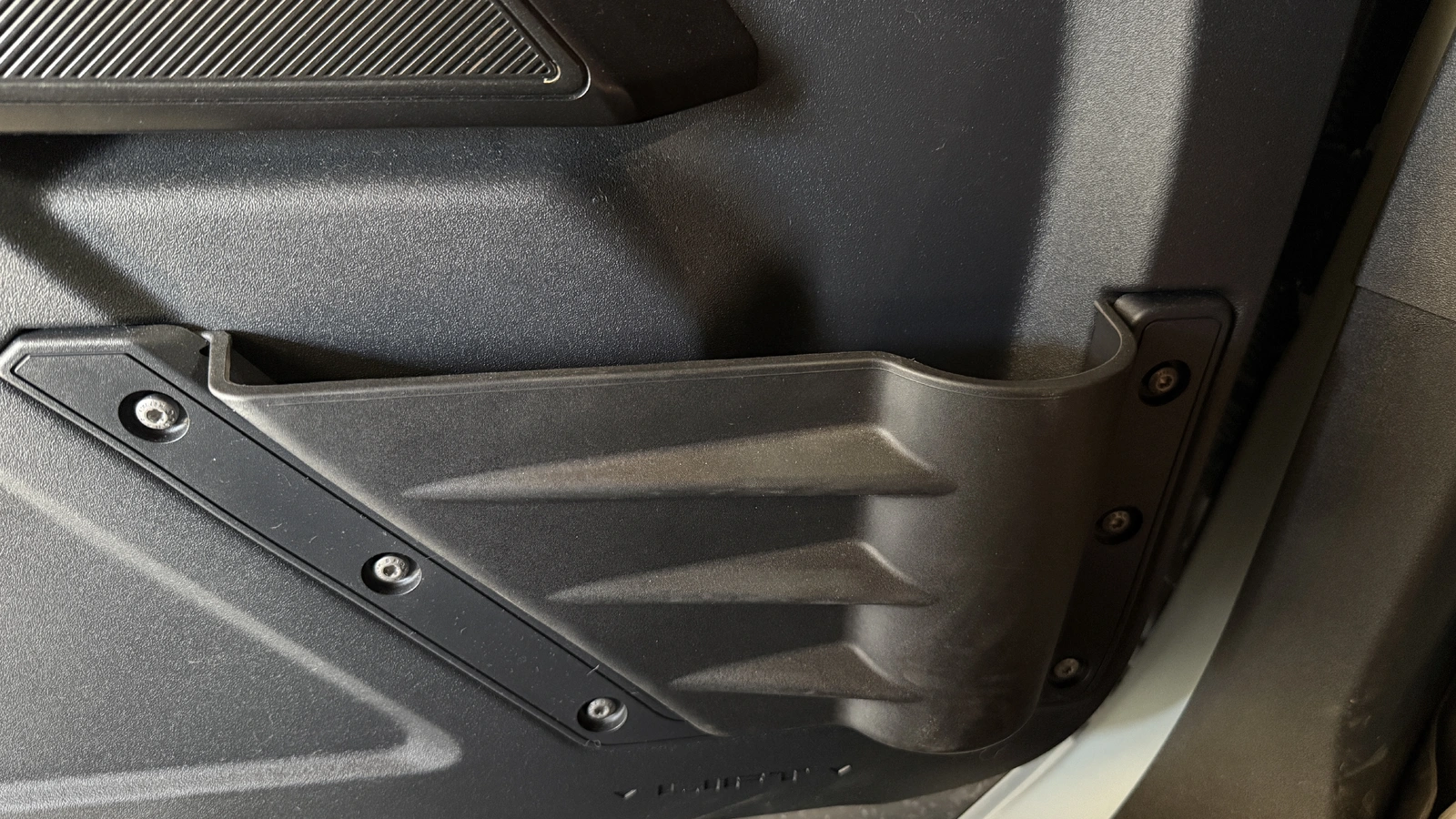

A bunch more cheap mods. These are basically commuter/passenger convenience mods for holding stuff whether it be drinks, sunglasses or whatever.
Front door pockets replace the nets.
I thought these would be a bit more handy than they are but I don't use them. Plus the included double-sided tape doesn't really stick. They stay put for the most part.

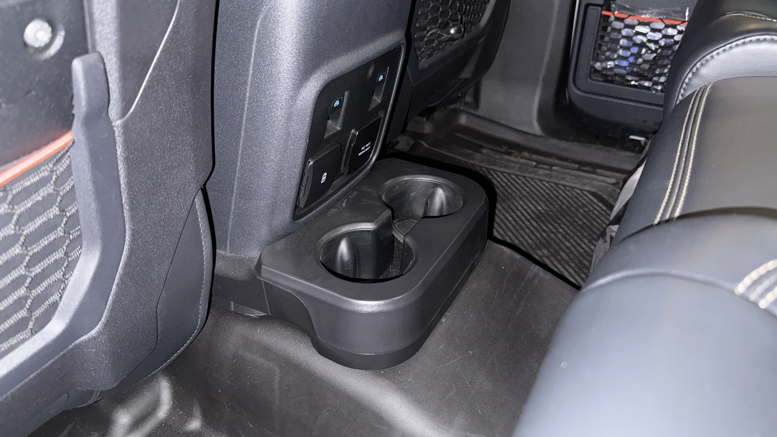

I rarely have rear passengers with two legs but why not. Made by Mabett. It's removable and a bit finicky to get locked in place. Also, the rear seat won't fold all the way down with it in place so I find myself removing it often. If you simply put it on the passenger seat floor, the seat will collapse fully.

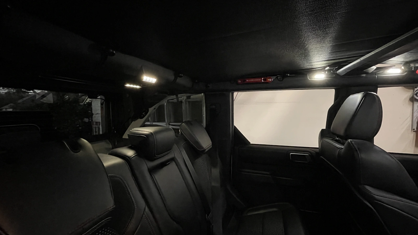

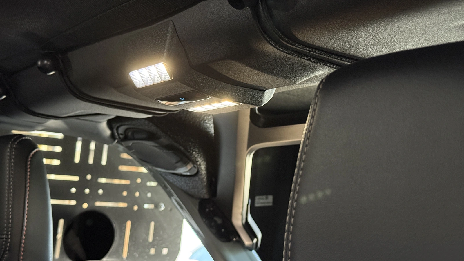

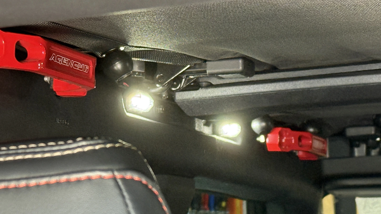

Lighting! This was probably the second or third mod I did. The Bronco's interior is dark and the lights are wholly inadequate especially at this price point/day and age. The rear dome light has threel LED banks so you get light directed forward down and into the cargo area. The installation is super easy and I did it at the same time as the side dome lights. Combined, they provide a fairly massive increase in lumens inside the cabin.
The Mabett side dome lights took a bit more effort to install but they plug in at the rear dome light so there's no cutting/splicing and the installation is far easier than some other, more expensive kits out there.

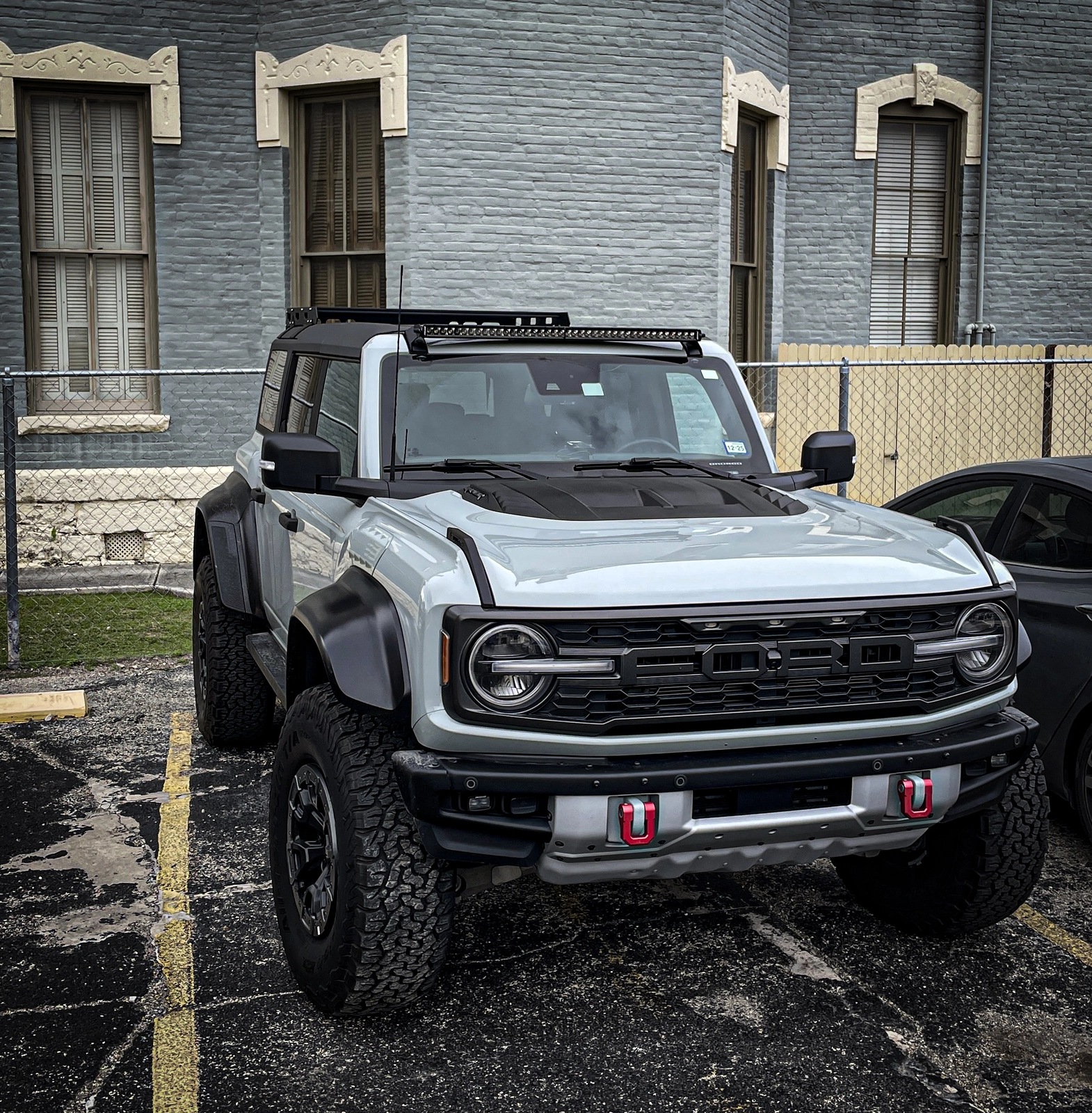

Lights! I spent way too much time researching lights and ultimately I stumbled across a deal for a new, uninstalled light bar as well as a new roof rack from another Bronco owner that I could not pass up. Ultimately, for me, it was the right choice so I sort of lucked out. .
Initially I tried an inexpensive bumper light that ended up not fitting despite being "made" for the Bronco with the modular bumper. After that experience and thinking about the whole cooling issue, I decided to to with a roof-mount setup despite the potential for noise and possible light spill/flaring on the windshield.
I came across a deal which included the Rigid 40" SR Pro "Midnight" light bar as well as the JCR full rack with light bar cutout.
Link to the light bar: https://www.rigidindustries.com/sr-srs-pro-40-mdnt-940214blk.html
I had been looking at the JCR for a couple of reasons including the ability to run a half rack setup and remove the front and passenger roof panels with it in place. I'm running the half rack configuration during the cooler months and the full rack during the summer when it's too hot to consider taking the top off.
For the half rack configuration, I ordered the Rigid light bar roof mount for the half rack configuration. It comes with a sound dampener which eliminates whistling, along with the brackets themselves and the mounting hardware.
The "midnight" editions have black PCB's so with the full rack configuration, it integrates really well if you like the sleeker look.
Half rack configuration:
I'm going to come back to the full rack later as I don't have a good photo of the full rack/light setup. It's currently in that configuration so soon!

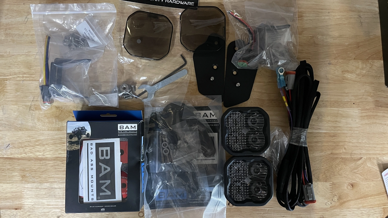

Moving on, I wanted pillar lights and did a lot of research ad nauseam and it came down to the KR Flex Era 3's or the Diode Dynamics SS3 Pro's as I thought both offered the most bang for the buck.
Both have amber "backlighting" and both can be modified at a later date to a different beam pattern. The KC's were easier to adjust but ultimately I got pushed towards the Diode Dynamics by a vendor. At the time, Diode Dynamics was also having issues with delivering products which didn't sit well. The pro's were back ordered with no arrival date but the SS3 Max's came in stock and I paid a bit more and snagged a set. I chose the driving combo lenses but may go flood. https://www.diodedynamics.com/ss3-sae-white-max-led-pod-pair.html
For mounts, I'd asked the vendor to nix the KR mounts but they arrived with my new lights anyway and I of course got charged for them. Anyway...I decided to do the Bad Ass mounts and I couldn't be happier with them. I've heard they'll "vibrate" but I've not experienced that. They've been rock solid and I like the aiming flexibility. In addition to the above, I purchased smoked lenses for the DD pillar lights to protect them day in and day out when not in use. The highways in my neck of the woods can be brutal in terms of debris. I also installed anti-theft hardware on everything, the mounts, the lights, all of it. Ultimately if someone wants something they'll get it but this'll deter the opportunist or at least slow them down dramatically.
Smoke translucent covers: https://www.diodedynamics.com/ss3-l...082&gbraid=0AAAAADEIEYhoRcPYlGLiIFXBZ9eE-SSIR
Security hardware for DD SS3's : https://www.diodedynamics.com/ss3-s...zT45-Fm-b-zLEJ_ppj38fNWpZmy7EYKEg1Oth8s51QRd8
Security hardware for the Bad Ass mounts: https://www.amazon.com/dp/B0C6HMZ6HY?ref=ppx_yo2ov_dt_b_fed_asin_title&th=1

Back to the JCR rack. Here's the full rack installed. I do believe I'm going to purchase purchased their black hardware kit to replace the uncoated stainless screws. I also purchased the side racks which I just leave installed as they're a pain to re-install without complete disassembly. They're quite heavy and honestly, they should be made out of aluminum instead of steel. They'd still be more than strong enough to hold whatever is needed.
JCR Full Rack: https://www.jcroffroad.com/product/BR6RK-HT-F.html
JCR Half Rack: https://www.jcroffroad.com/product/BR6RK-S.html
JCR Side Racks: https://www.jcroffroad.com/product/JSAP.html
Note: The full rack can be run in half rack mode but doesn't come with the wind deflector. Honestly, unless you like the look with the deflector installed, it's not needed from a noise perspective.
When the front half of the full rack isn't in use, I hang it from the ceiling with another manual pulley system. I can hang both the cargo roof and front half of the rack at the same time. My garage ceiling looks like Circ du Soleil at times.
With the full rack installed, I'm using the integrated light bar brackets to house the Rigid SRS Pro 40" Midnight light bar. https://www.rigidindustries.com/sr-srs-pro-40-mdnt-940214blk.html. The PCB boards are black and the reflectors are also like a black chrome so it integrates into the roof rack and doesn't protrude at all. Slightly stealthier look that I think I prefer.
For mounting the Rigid light bar by itself, without the half rack, you'll want their kit. True, you can likely use any mount for a 40" light bar but Rigid includes harmonic dampers which eliminate whistling noise. Without them, you'll get a noticeable whistle. I basically go back and forth between the rack mount and the Rigid mounting brackets depending on how I am running the JCR top rack (or the roof is off altogether.)

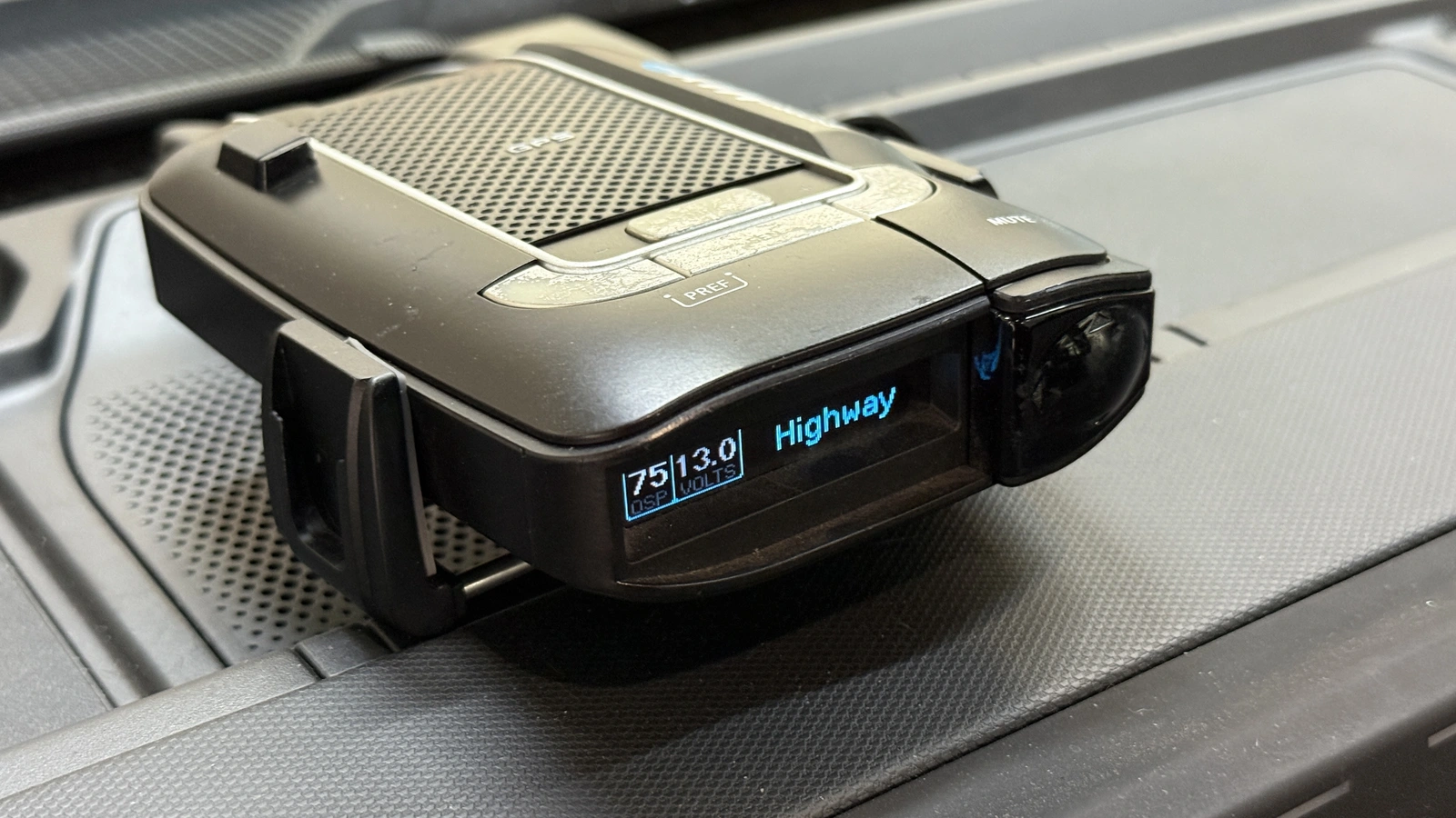

I live and die by the radar detector. I've definitely slowed down due to moving from a sports car to the Braptor but I still like to know when I'm being zapped by a radar gun. I use the dash accessory mount and what is essentially a phone holder to position the detector and a USB to RJ11 power cord to run it off one of the USB ports on top of the dash. I leave it plugged in when I park and it seems to power down after a bit.
This is the power cord I use: https://www.amazon.com/dp/B0CL8WHYTN?ref=ppx_yo2ov_dt_b_fed_asin_title&th=1
Here's the clamp for the radar detector: https://www.amazon.com/dp/B0B5SV81JS?ref=ppx_yo2ov_dt_b_fed_asin_title
I'll be replacing the Escort with a Valentine One here soon. I've had the Escort for some time and while it does still work, the screen is no longer visible in bright daylight and only the forward direction indicator error works. Been a pretty typical experience with Escort. Their stuff never really lasts or you have to send it in for service every few years and loose it for six weeks.

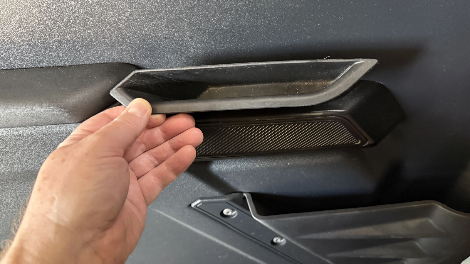

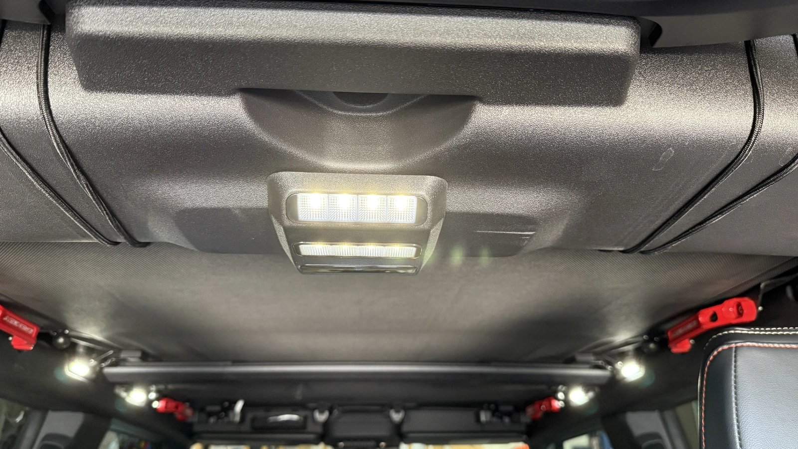

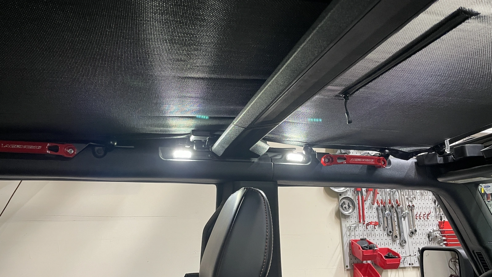

View attachment 15713View attachment 15714
View attachment 15715View attachment 15716View attachment 15717

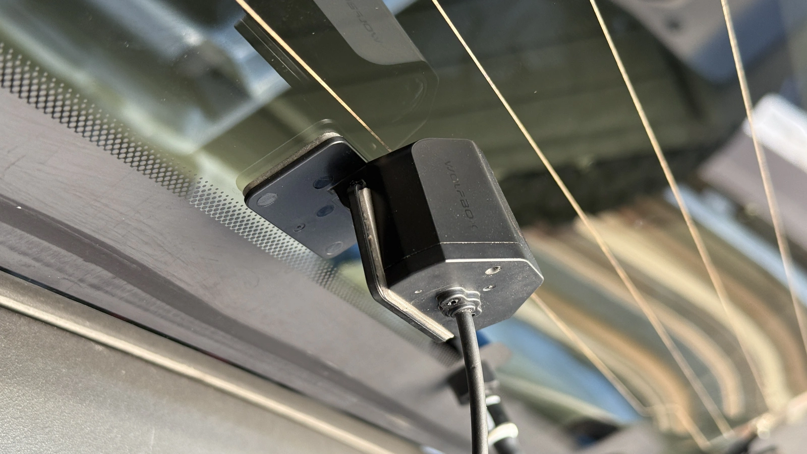

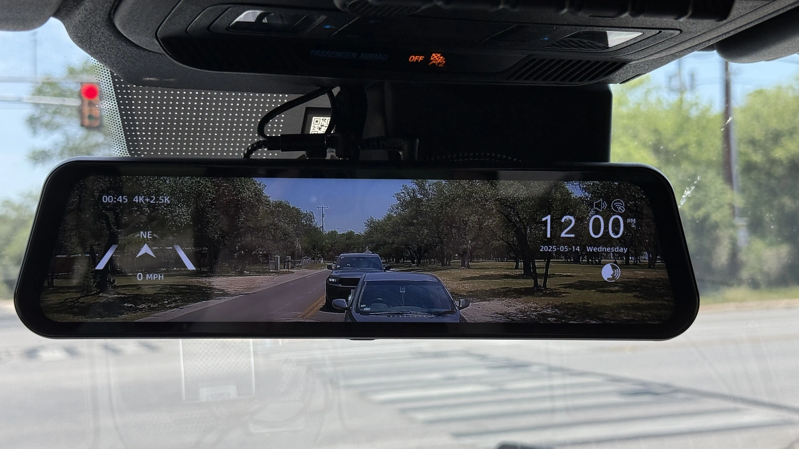

For rear visibility issues and to record stupid drivers doing stupid things, I installed a digital rear view mirror from Wolfbox. I ordered several additional parts related to the installation as I wasn't sure if I was going to run the rear camera inside or outside the cabin or whether I'd use a fusebox link to power it or use mirror power.
View attachment 15737View attachment 15738
In the end, I chose to mount the rear camera inside the cabin mostly so it'd stay usable in bad weather. The OEM rearview camera is worthless in the rain. I do lose nighttime visibility in terms of knowing exactly what's behind me but you can clearly see there's a car there due to their lights so it's a non-issue.
I have the G900 Pro: https://www.amazon.com/dp/B0DD78Y3L5?ref=ppx_yo2ov_dt_b_fed_asin_title
In addition to the basic kit, you'll need the following:
-Wolfbox mirror bracket. This'll allow you to remove the OEM mirror and completely replace it. https://www.amazon.com/dp/B0BN31MBZP?ref=ppx_yo2ov_dt_b_fed_asin_title
-Dongar dash cam power adapter. This'll allow the use of the OEM rearview mirror plug to power the dash cam. https://www.amazon.com/dp/B088P4VFQ7?ref=ppx_yo2ov_dt_b_fed_asin_title
-Right angle USB cord makes everything a bit tidier. This'll go from the Dongar adapter to the Wolfbox mirror: https://www.amazon.com/dp/B092KF36T6?ref=ppx_yo2ov_dt_b_fed_asin_title&th=1
-Mount for the rear camera (for inside the cabin): https://www.amazon.com/dp/B0CWRTH5W7?ref=ppx_yo2ov_dt_b_fed_asin_title
-If you do want to mount the rear cam outside the vehicle, you'll want a longer wiring harness. Otherwise the included harness is long enough. https://www.amazon.com/dp/B082RZNJFY?ref=ppx_yo2ov_dt_b_fed_asin_title
-If you want to run power from the fuse box, you'll want this wiring harness: https://www.amazon.com/dp/B09X9F8GMT?ref=ppx_yo2ov_dt_b_fed_asin_title
The harness will also power the camera 24/7 so you can use "sentry" mode and it'll record if there are loud noises, it senses motion, etc...
Overall I like the improved rear visibility but I do have some issues with it. First, it's not the same perspective as a normal rearview mirror. It's wider. I also need reading glasses so while I can see cars just fine, I can't always tell the make and model. With a normal rearview, I can spot a cop 400 yards back. Not so much with the LED mirror. It does record front and rear on a loop so I'll have video evidence if another driver does something stupid which is the main reason I have it. Oh and it acts as a normal mirror if you turn the power off.

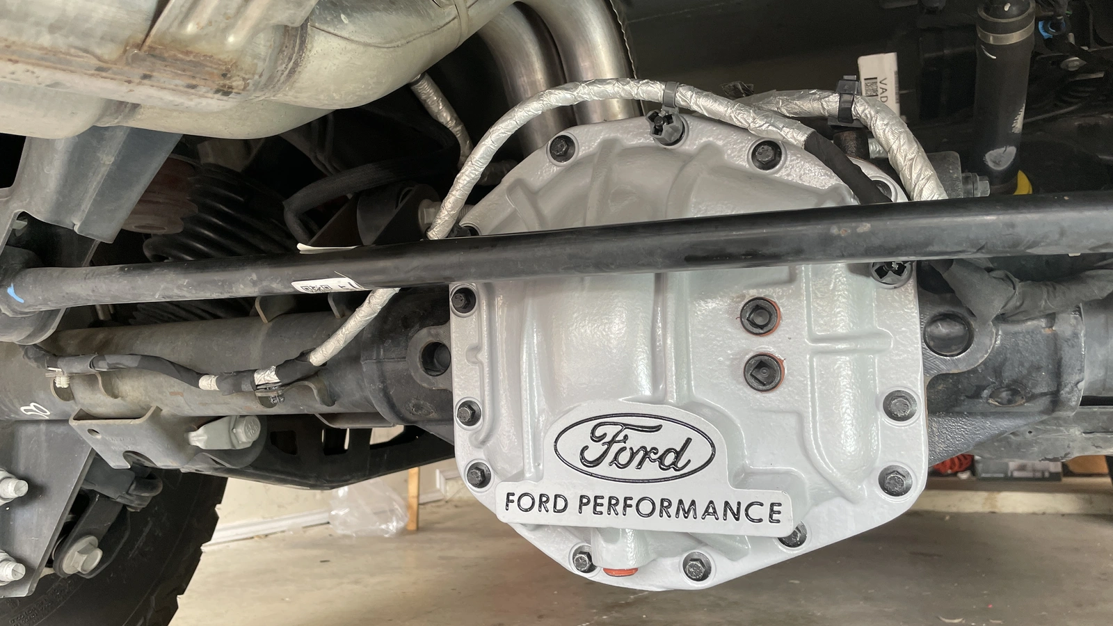

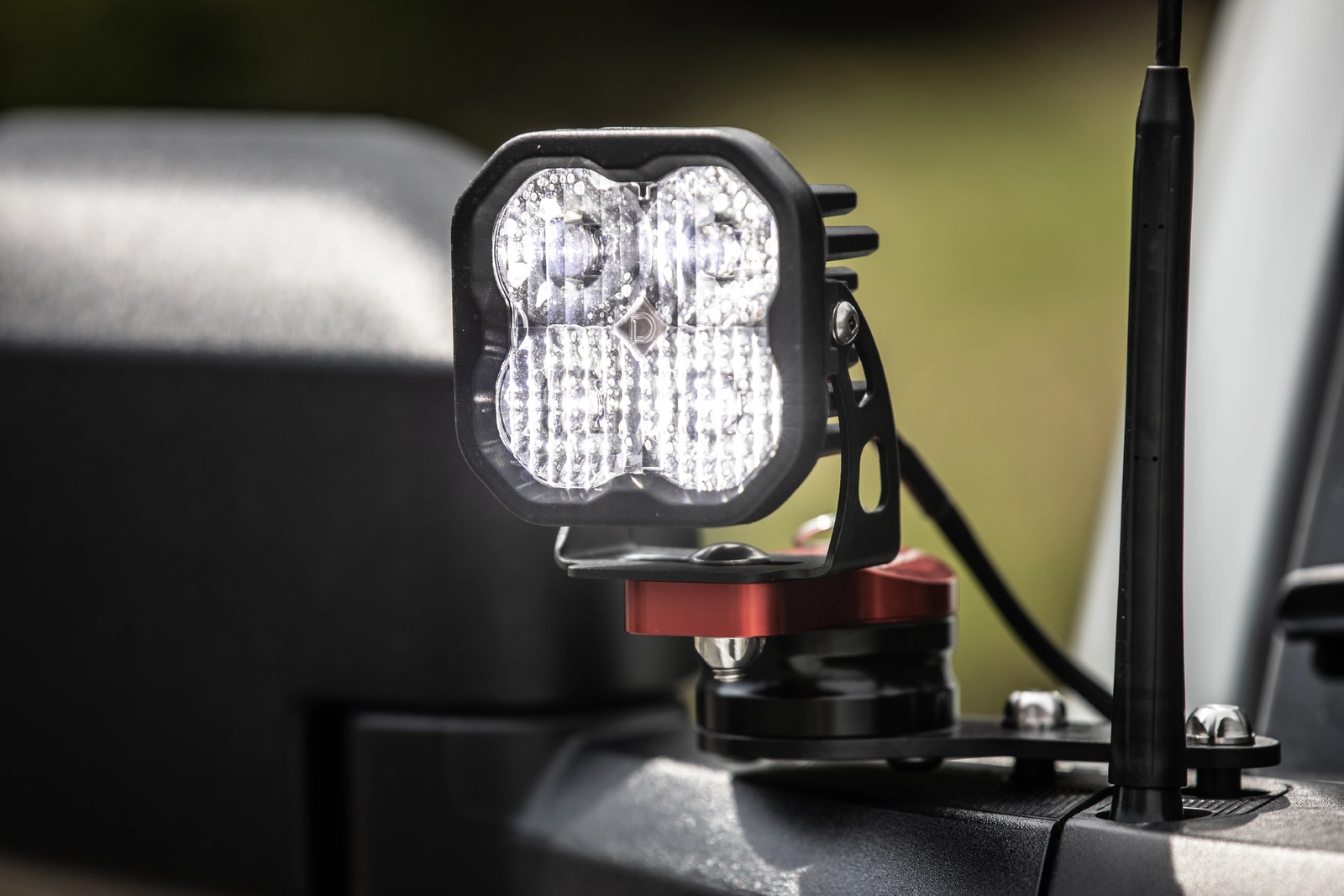

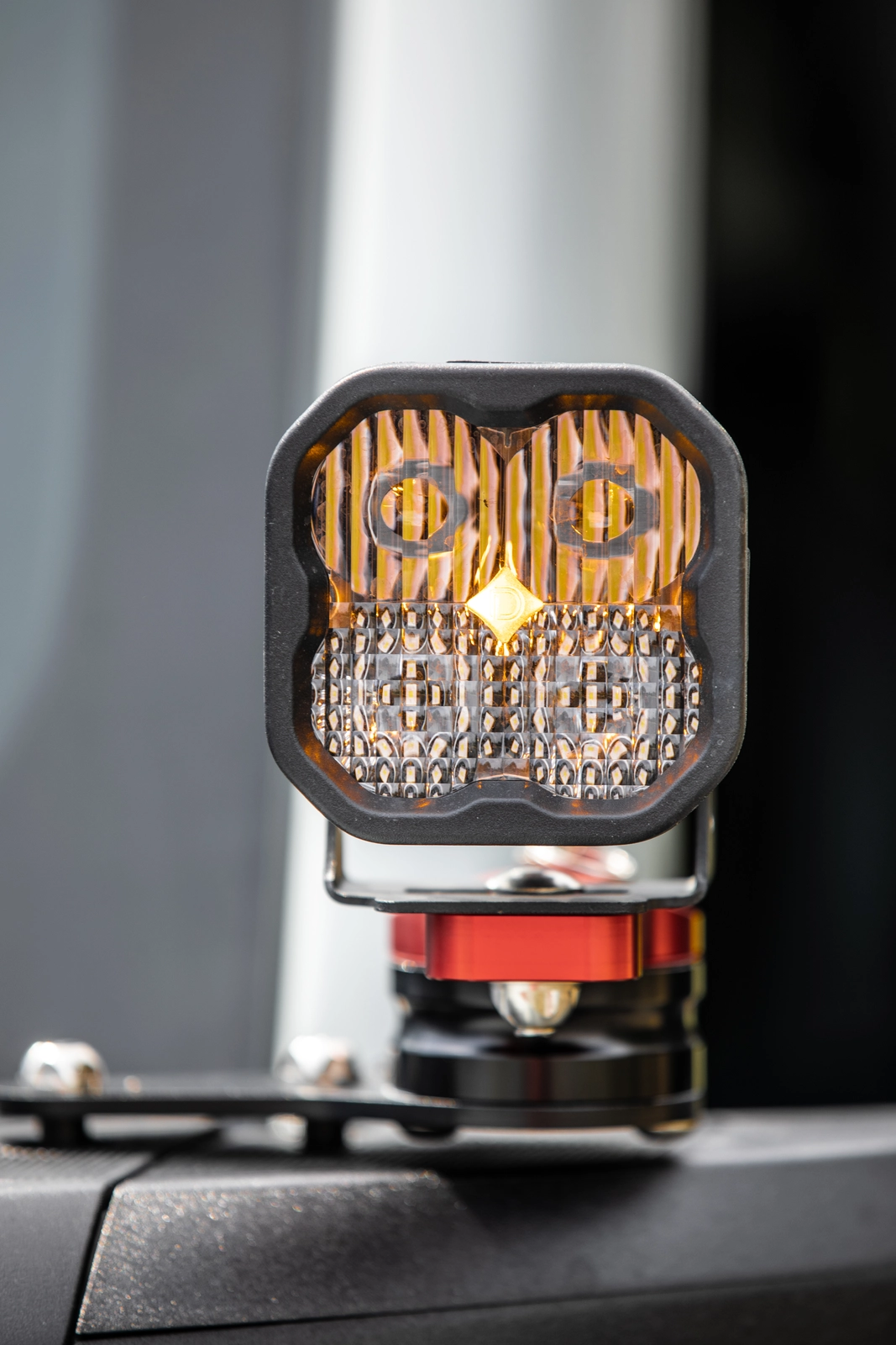

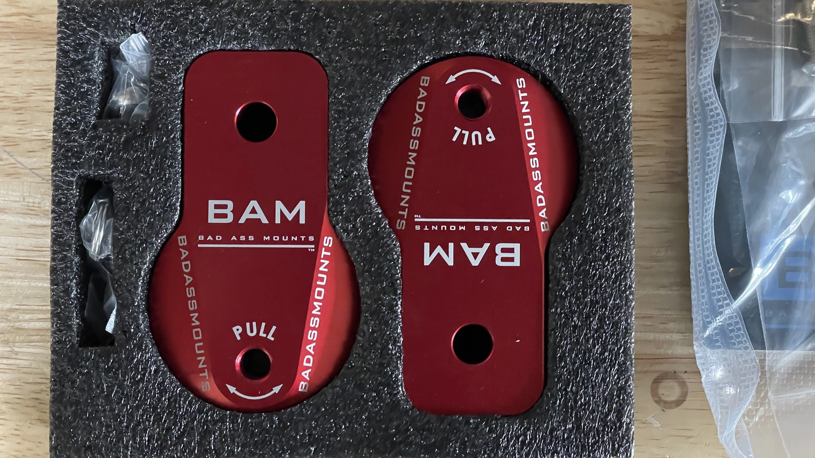

I decided to change the fluids in the front and rear differential as well as the transfer case out of an abundance of precaution. I tend to do "performance" maintenance intervals on my vehicles. Knowing I'd be changing the fluids more often, I decided to purchase the Ford Performance rear differential cover since it has a built-in drain. I didn't want to remove the entire cover each time I changed the fluid so I thought this'll be a great mod!
Guess what. The OEM rear differential has a built-in drain that's visible from directly below. It's in the housing itself and not the cover. So...if you don't want the extra strength/rigidity of the nodular iron Ford Performance cover, no need to replace it. I did a full writeup of the installation here:
https://www.broncoraptor.com/thread...nsfer-case-fluid-swap-how-to.2312/#post-20080
