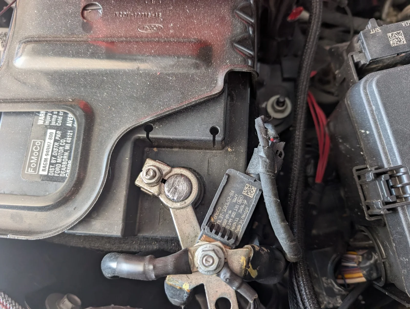

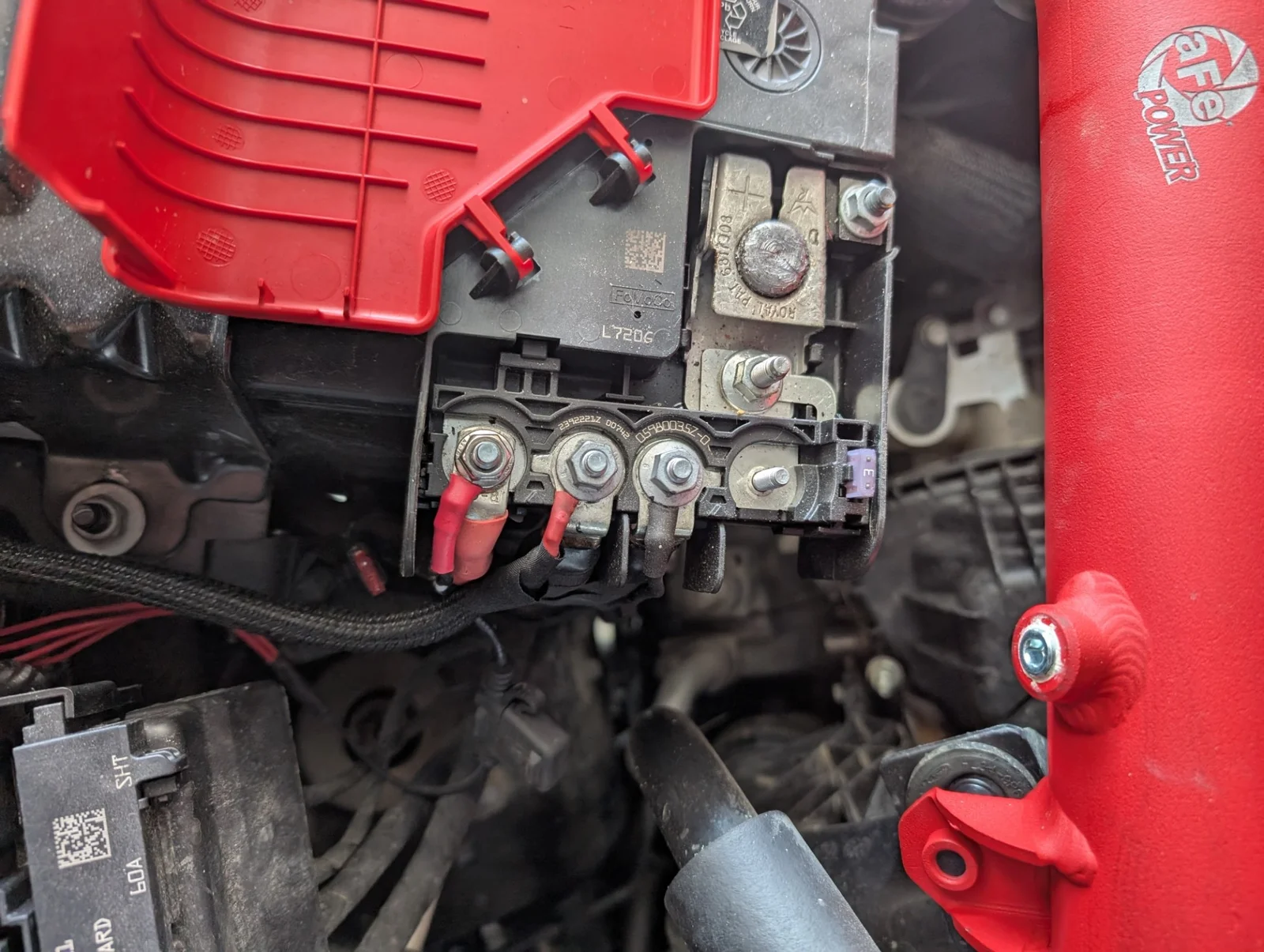

will this battery work with the existing
add on positive and negative connections?
adding photos of my Braptor stock battery set up.
Yep, they make batteries in a multitude of case sizes and off the top of my head, the Braptor is an H7. So it'd be the same case dimensions with terminals in the same place.

Also this should be a clean swap, no software changes or battery connectors needed?
I'm only a dealer for Antigravity. I've never heard of Dakota batteries and looking them up, they look a little basic to be honest. I didn't see anything they offered as being a direct drop-in replacement with the proper amp hours.
