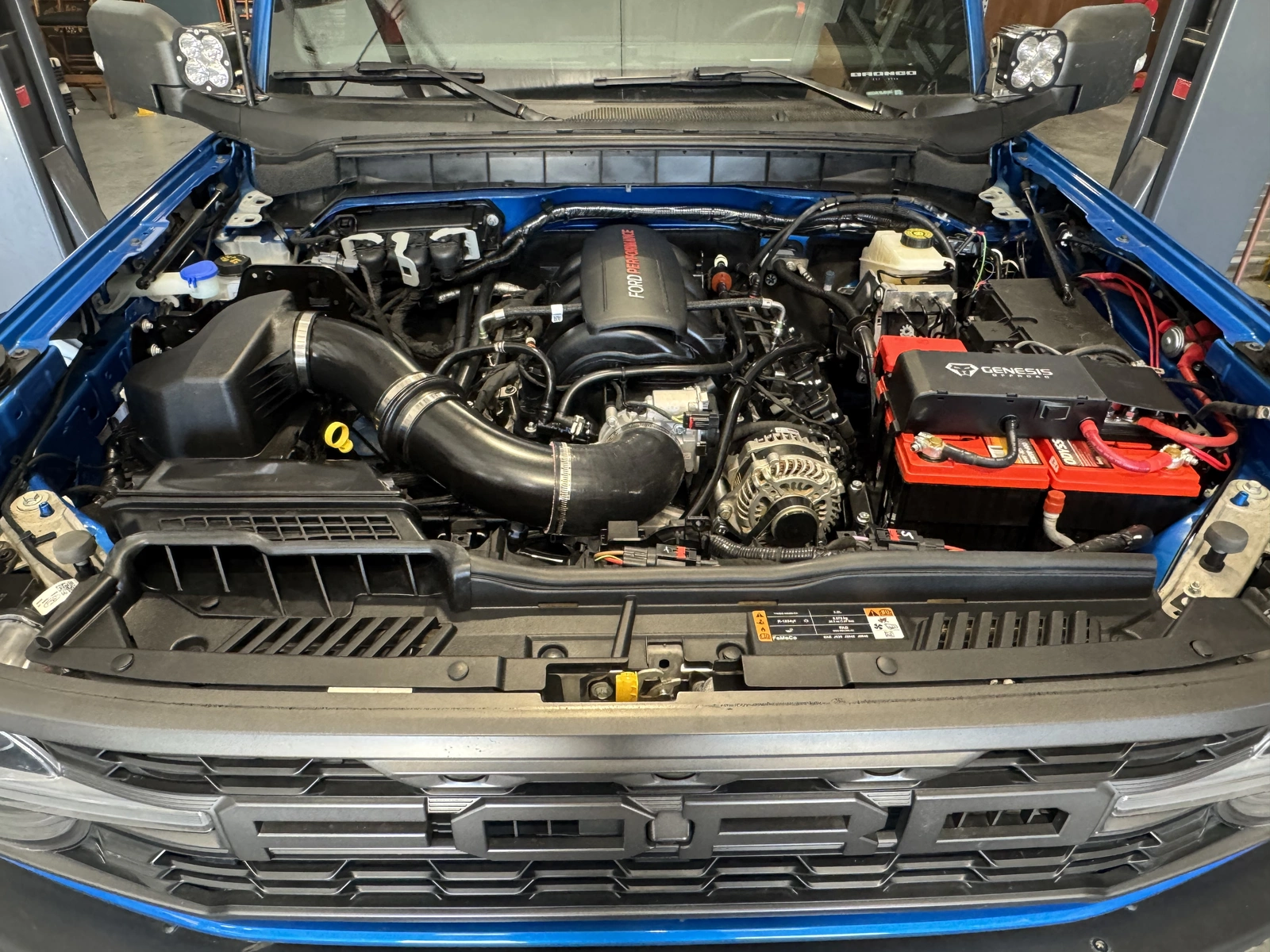

Happy to report that a project that was started in September 2024 is finally close to completion today with the Godzilla V8 conversion in my 2022 Bronco Raptor coming to life today.
I wanted to share here for those of you who aren't aware this is possible in a Braptor, this is the first time a Godzilla conversion has been completed in a Braptor and is being performed by Juicy Motorsports.
Here's a photo of the engine bay, notice how OEM this looks -- how I wish Ford had offered a V8 option from the factory!
It's running a stage 2 cam, Megazilla intake, OEM Braptor air box, custom headers, high-flow catalyst converters, OEM Braptor muffler, and exhaust after muffer.

Engine tuning and shakedown is up next but by and large, this project is in the home stretch.
Wow! Congrats on the first Godzilla V8 Bronco Raptor and great choice with the Godzilla 7.3L and upgraded stage 2 cam providing increased torque. Large displacement, in this case 445 ci, engines with headers sound so Amazing!
Please keep us updated on this super cool project as it advances to completion. I'm excited for you, your Bronco Raptor sound will now equal it's aggressive looks. Talk about intimidation... :giggle:
Now you can actually ford water of reasonable depth given the alternator is up high ;)
Cant wait to see final numbers and glad its in the home stretch!
Hopefully there will be a pair of godzilla braptors in the bay area :)
That is fcuking SWEET @22broncoraptor
I am totally stoked for you - what an amazing project and the final result looks top notch. Kudos! 👍🏼
Ballpark figures on a conversion por favor.
From my discussion with Juicy, its about 65k if you stay built motor, and 85k if you go supercharged route.

65k for stage 2 cam build like the one in the video. 85k for 7.3 godzilla with Harrop Supercharger (what they did in their shop raptor pickup)
