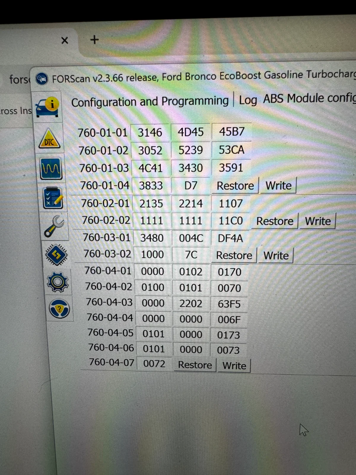

Thanks for this info, my ABS as built does not match the video though, my 760-03-01 line has 3480 in block 1, 004C in block 2, and DF4A in block 3. There also is not an option to restore or write, am I doing something wrong?

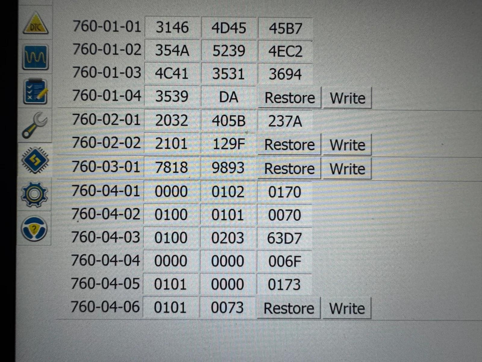

Can you send a pic of your ABS As-Built? Here’s mine..
I’ll try to get it hooked up and take a photo of it later today, but my 760-03-01 line reads across as follows. 760-03-01 3480 004C DF4A
Here is what mine looks like, I undid my changes and put it back to factory, so everything is working currently (when I tried to change and add stop and go, my cruise became unavailable).
