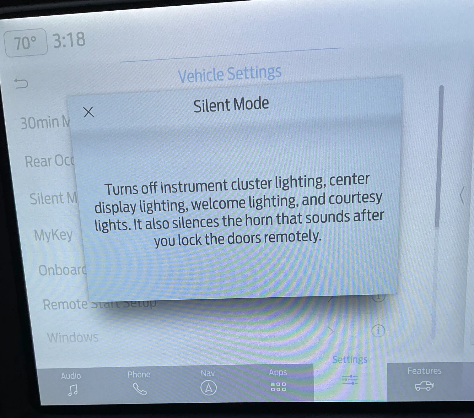

“Silent Mode” stops the Parking lights, DRLs, puddle lights and interior lights from coming on. It also stifle chimes. Thus I can slip out and back in without alerting the three state area,

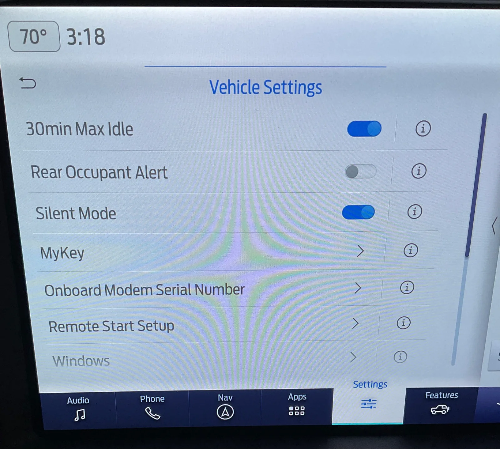

The cool thing is the Forscan changes put a Silent Mode on/off switch selection on the Settings>Vehicle screen in the center LCD screen. Click it to “enable” and everything’s off, click it “off” and you’re back to default lighting.
Once you connect forscan to your vehicle, you only have to modify two modules (IPC, APIM). You can make the changes in the easy mode. Select IPC module, press “run service procedure”, once the table is displayed, locate “Silent Mode Control” in the module, choose “enable”, verify the change, press “Write”, verify that, the cycle the ignition switch when prompted.
Repeat that same process for the APIM module. You’ll notice that the center screen resets when you complete this module.
Once you cycle the ignition back on and open Settings>Vehicle and you’ll now see the Silent Mode on off option. Choose accordingly.
