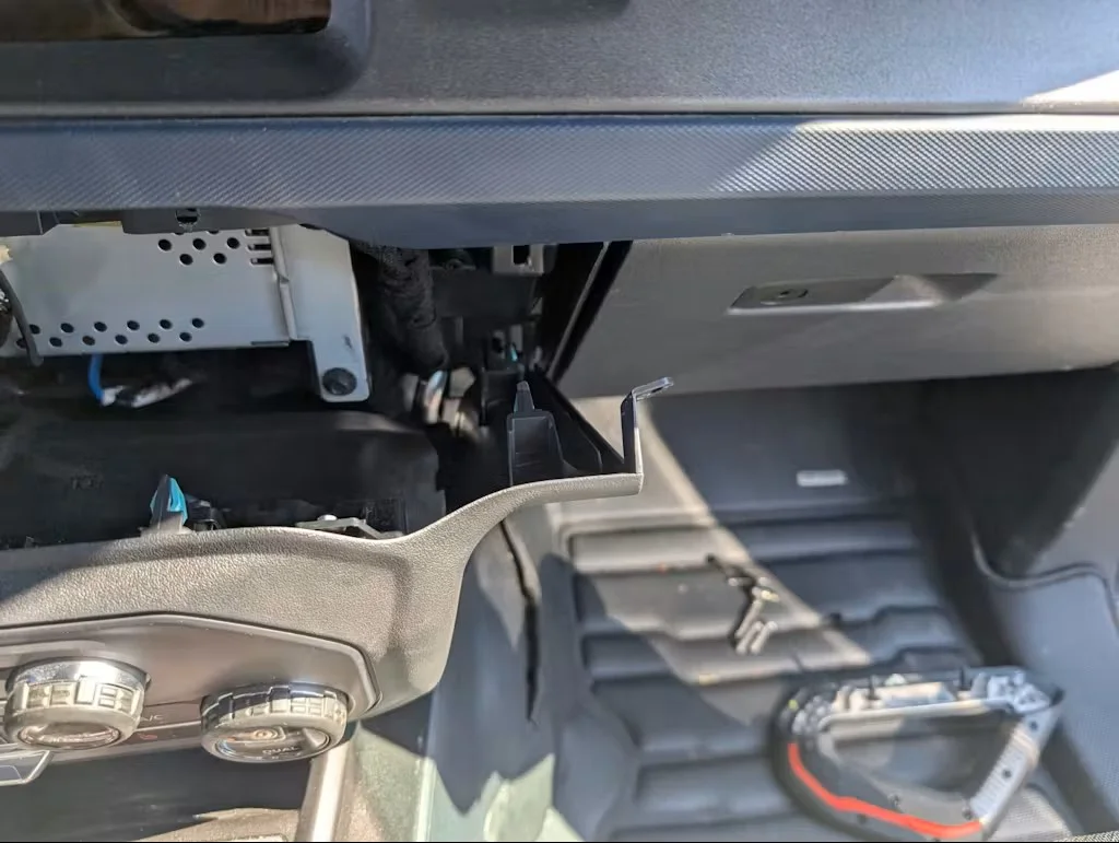

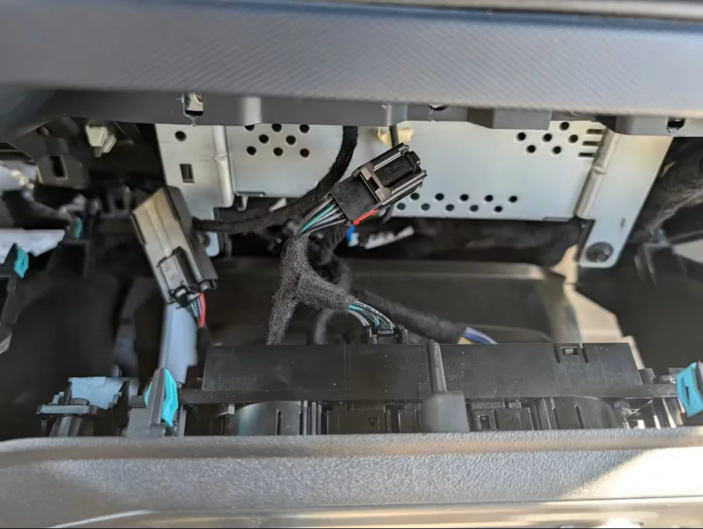

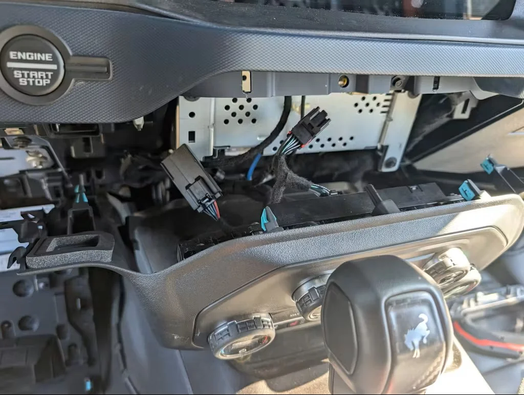

AutoStop Eliminator for 2021+ Ford Bronco & Bronco Raptor
This is what I used in my 23 works well. It recalls the last state stays On/Off.
listed below is an install video
The WORST Ford Feature & How to Fix it | Disable the Auto Start Stop for Bronco, Ranger, F-150
