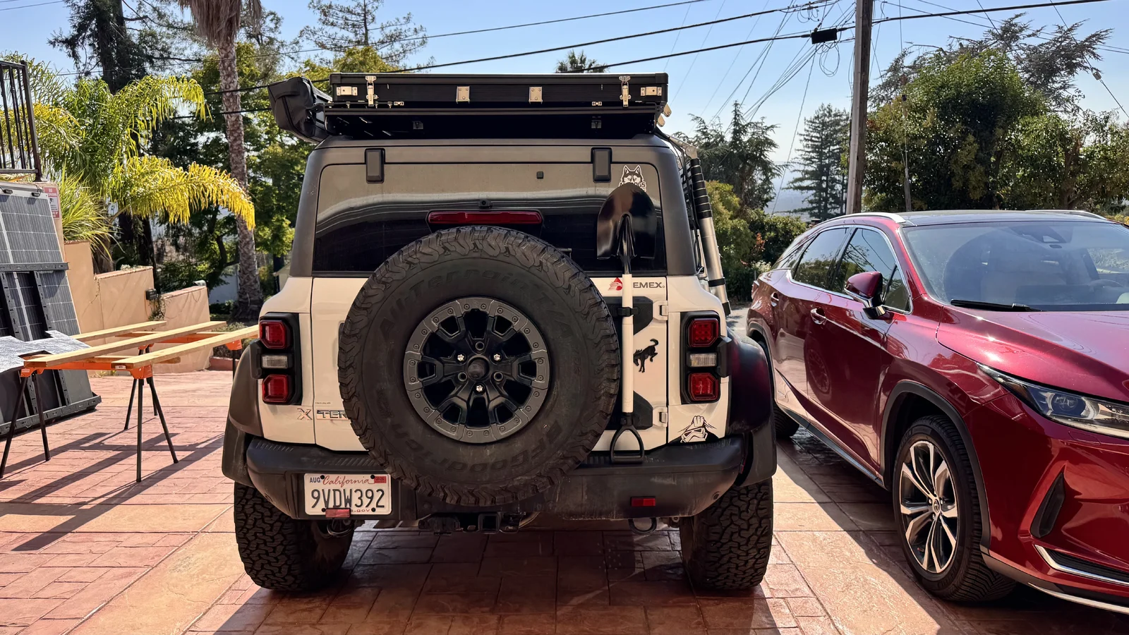

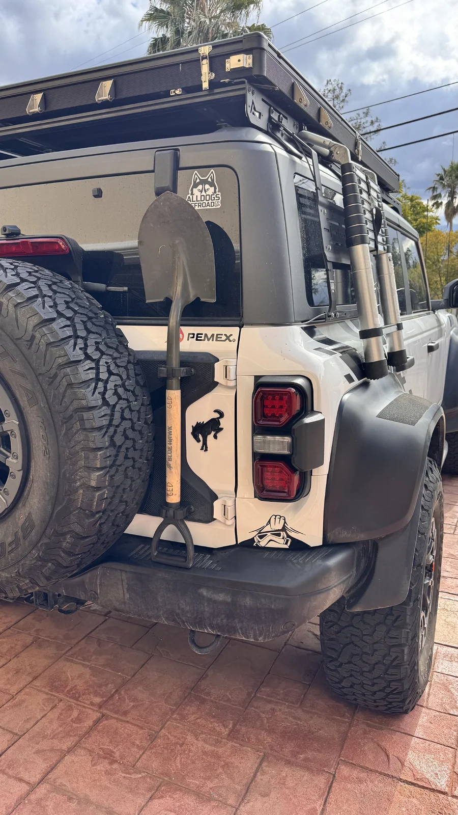

Shovel Install:
In California, as part of obtaining your Campfire permit, you agree to bring a Shovel to each campfire...
I used some Quick-Fists into the accessory mount on the tailgate.
The worst part was that the threads were completely gummed up with paint. I had to spend almost an hour with a M6 x 1.0 tap to clean the threads before attempting to screw in the rubber Quick Fists:
The shovel fit perfectly in the very limited space that is available between the tire and the tail light when the tailgate is open more than 90 degrees.
However I did not like how it look in regards to the Bronco, so I used a Sharpie to mark the line where the lift gate window starts.
I painted above glossy black (after having sharpened the blade's edge with a grinder), and the handle white. Looks much better to me:

Great aesthetic but oh boy is that first use of the shovel is gonna be bittersweet!

What quick fists did you use? This looks like a great. Fantastic use of some unused real estate. Winter is coming in the Sierras and I’m tired of my shovel sliding around in the back.
The paint job on the shovel looks great!
I finally got around to installing these and test fitting a shovel.
I found that D handle shovels (most short shovels have this handle) are tough to fit. The handle has to be short enough to latch within the lower fist. I have one, but as I open the tailgate the handle hits a rise in my ADD Rockfighter bumper.
My bumper (I see you have the stock bumper) may be the issue, so I decided I’ll just cut down a straight handled shovel. That would also have the advantage of cutting to perfectly fit the shovel below the roof line.
But…no… the shovel handle below the top quick fist contacts the passenger tail light (on the reverse light portion) when the gate is fully opened. Barely, but too much IMO. Especially as this was going to be my quick access for snow wheeling. Contact and cold weather on plastic seems dicey.
Have you managed to work around contact with the tail light on full extension of the tail gate?
