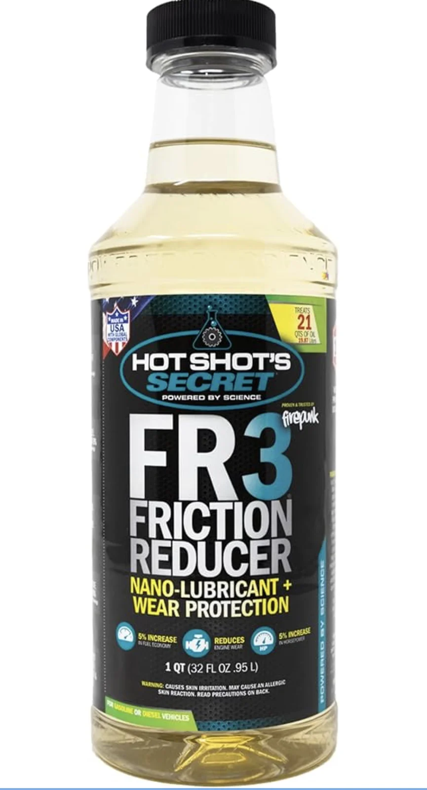

I know 1 person that used an oil additive that is a stiction eliminator product and it solved his cam phaser rattle. Ford does not recommend any oil additives so, if you go this route, caveat emptor. (although, personally, I would likely try this before a motor replaced).
I am trying to find the name of the actual product - please hold…

FOR INFORMATIONAL PURPOSES ONLY - USE AT YOUR OWN RISK
I am told that 8 ounces of Hot Shots 3 Friction Reducer added to the engine oil corrected the cam phaser issue.
Per my previous post, Ford does not approve any oil additives and I have not tried this personally but have witnessed positive results. YMMV
