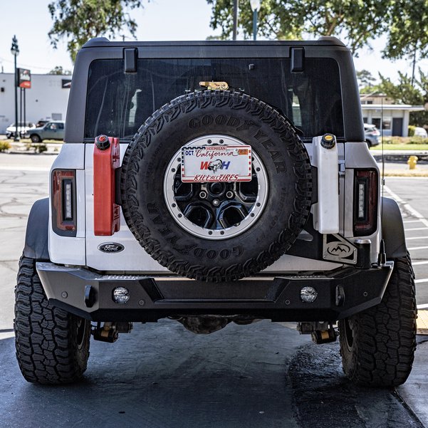

The RSE EZ Rack is a fantastic product - I have used mine for the past almost 20 years. The pro tip is to mount the strap around the spare as far away from the rear glass as possible so you can still use the handle to open the tailgate while it’s attached.
My former Badlands
Probably my next purchase for the Braptor is an around-the-sparetire gascan carrier like this one.
...or stay fairly close to home! 😏
A couple notes on the RSE EZ Rack….
You probably will not want to mount the Rotopax at 9 and 3 o’clock position on a Raptor. The passenger side rotopax will interfere/damage with the tail light (sticks way out vs typical Bronco). when you open the tailgate.
Try mounting at around 10 and 2 o’clock to get a position that clears the third brake light and the tail light when opening the gate.
Also, if you’re running stock +34 rims and 12.5” tires you need to make sure you position the strap as far out on the tire as safely possible to avoid the corner of the Rotopax contacting your tailgate under spirited driving conditions in off road driving situations.
I successfully identified the first issue above, but I learned the second, the hard way, on a 400 mile Mojave adventure just two short months after taking delivery in December 2022.
Otherwise, it’s a great product, reasonably priced, very handy and stows easily in the garage the 99% of the time you don’t need it.
The ding is kind of hard to see in the picture, but you can definitely see if took multiple shots from the Rotopax
You’re welcome. Looking at the picture of your truck it looks like you’ve reduced the positive offset, that should help a lot with spacing away from tailgate
10 and 2 works great, even when it's Boogie time. They do get close to the tailgate, but I strapped it a little off center like you said and it works fine. Pic is from this weekend's Mojave run in some elevation.
