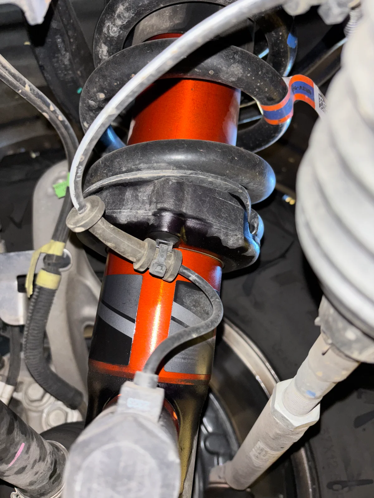

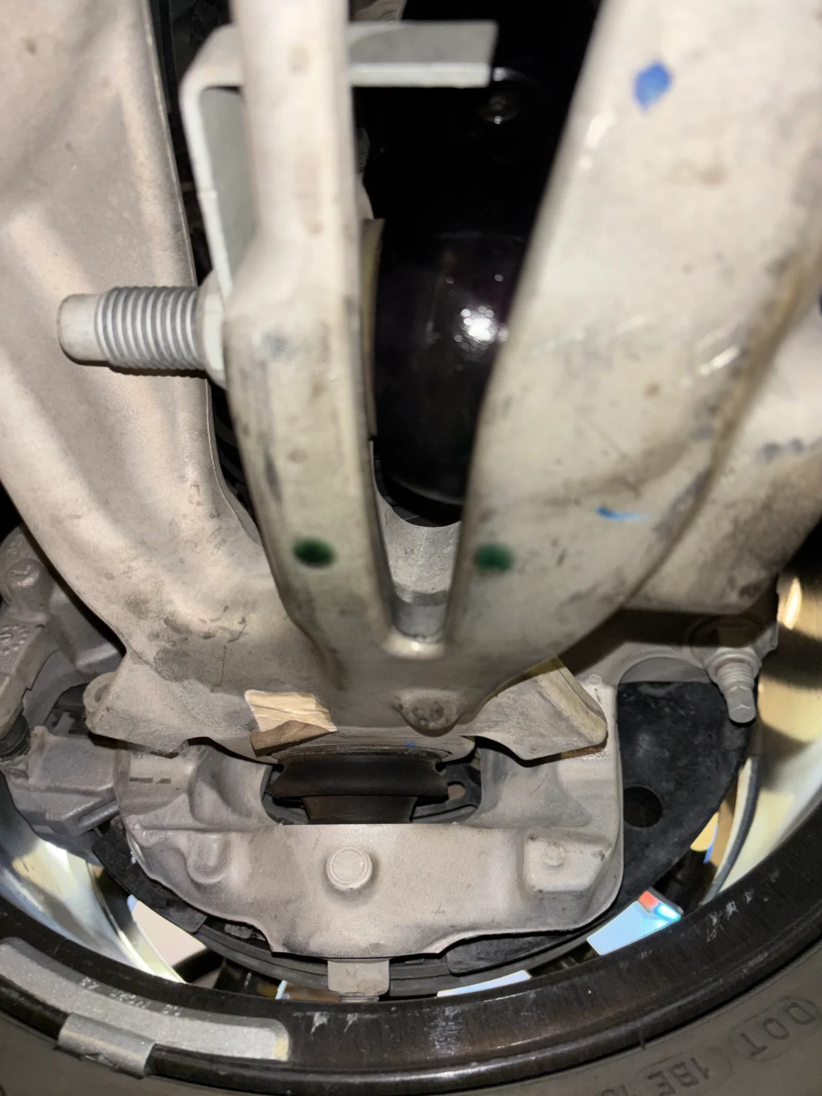

16000 miles, no hardcore off-roading and haven’t hit any hard bumps. Found a puddle of bluish-green fluid near inside drivers tire to find my shock has burst a seal it looks like. It seems I’ve only been able to find 1 other example on web for this. I hope this is just a one time unfortunate incident and doesn’t happen to the others after warranty expires. Anybody else know of or had this happen?

Welcome to BroncoRaptor.com. Unfortunately we have had several members experience Fox shock failures. So far, members have returned to their Ford dealership for resolution/shock replacement.
If your between 36-41 months since new it still qualifies for the Ford Protect new car warranty if under 36k miles.
Besides returning to a Ford dealership, since you’re out of warranty, I would also check with Fox Racing to see if it can be rebuilt or warranted by Fox.

I spoke with Fox at Hammers. They offer a rebuild service. Mail in or they have a shop available near Phoenix IIRC.
Intervals will depend on how you use your truck but the fox rep said a good rule of thumb would be rebuilding the shocks when replacing the tires.
