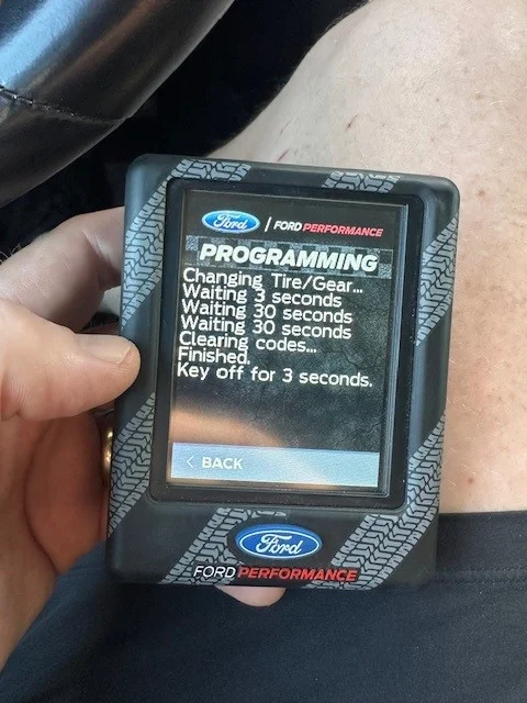

I get home and reflash to stock, same issue. I reflash the tune, same issue. Do a little research and I learned that if you tinker with the wheel and gear size sub menu on the ProCal module and do not let it complete its cycle, you will get the P160 code.
The fix was a 2 min fix. Motor off and ProCal plugged into OBD II, turn power on without starting motor. After the ProCal device settles, go into the wheel size and gear sub menu and let it do its thing. Once its done you will no longer have the code. Hope this helps folks!!
