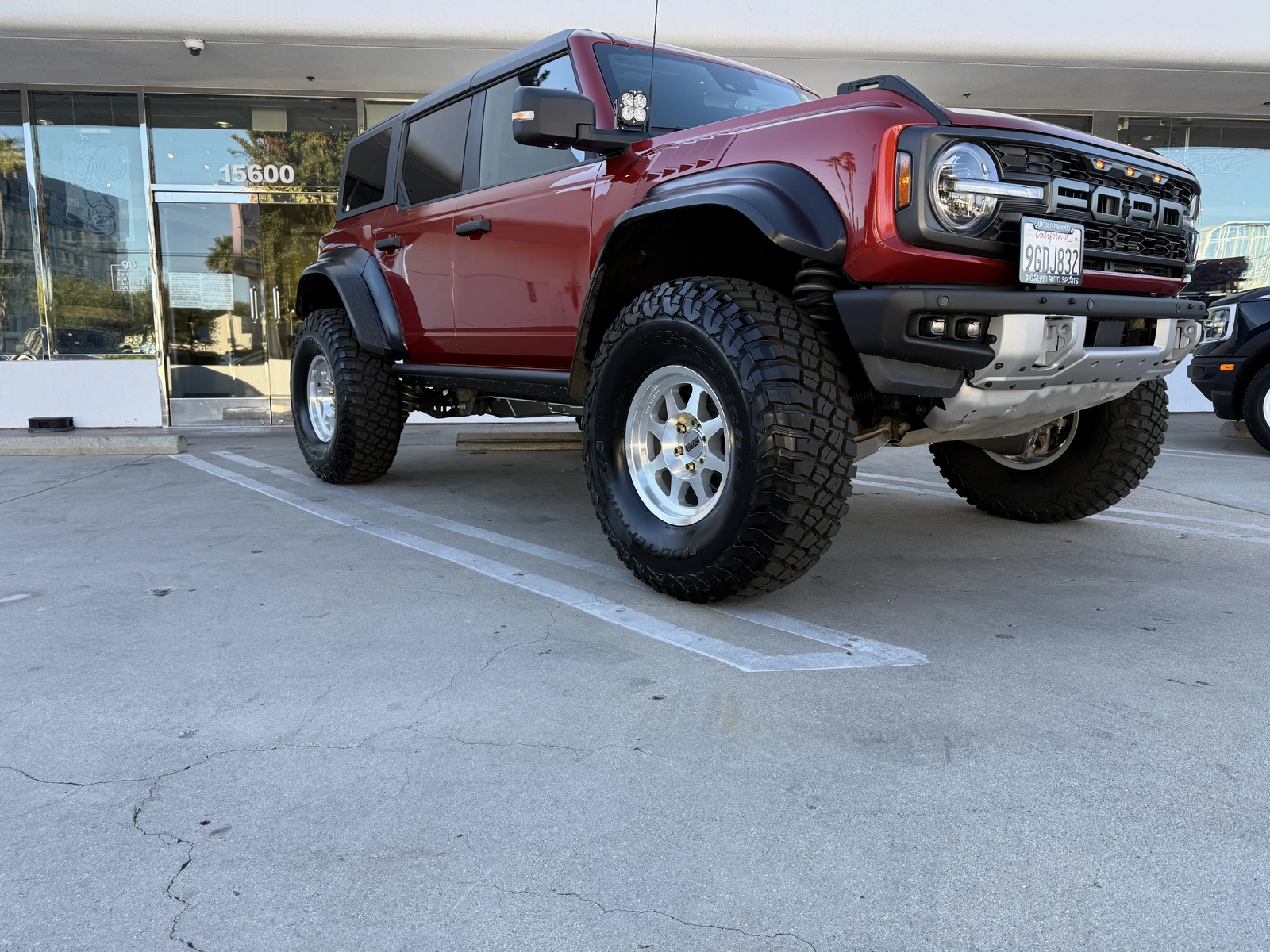

I went with the Method 703 Raw Machined MR70378516300 rim. I liked the raw aluminum look since anything with paint or powder coat really shows the scratches and scars. Also the internal locking ribs for the bead are legal for the street here in CA. The 39" spare did require a kit to extend the center brake light higher so it remained visible.
Thanks, it looks sharp. What size rims did you use?
Pretty sure there 17"x8.5". They've stood up very well to all my abuse for the last six months!
