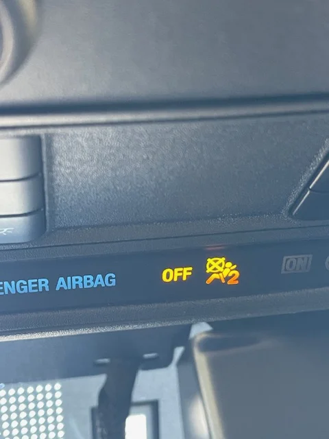

I can't figure out what it means.
Even if someone is sitting in the seat, it is lit.

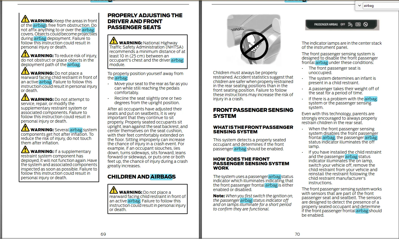

That light comes on when the airbag is turned off it’s based on passenger weight so if you have a child in the front seat, the airbag won’t deploy
Even when my wife is sitting there, the light is still on.
if your wife is over 100lbs you probably need to have the dealer recalibrate the seat. Other causes may be stuff hanging on the back of the seat, objects stored under the seat, heavy objects on the backrest molly panel. The picture a couple of post above has great info
Maybe look under the seat and verify everything electrical is plugged in and seated correctly…no pun intended.
