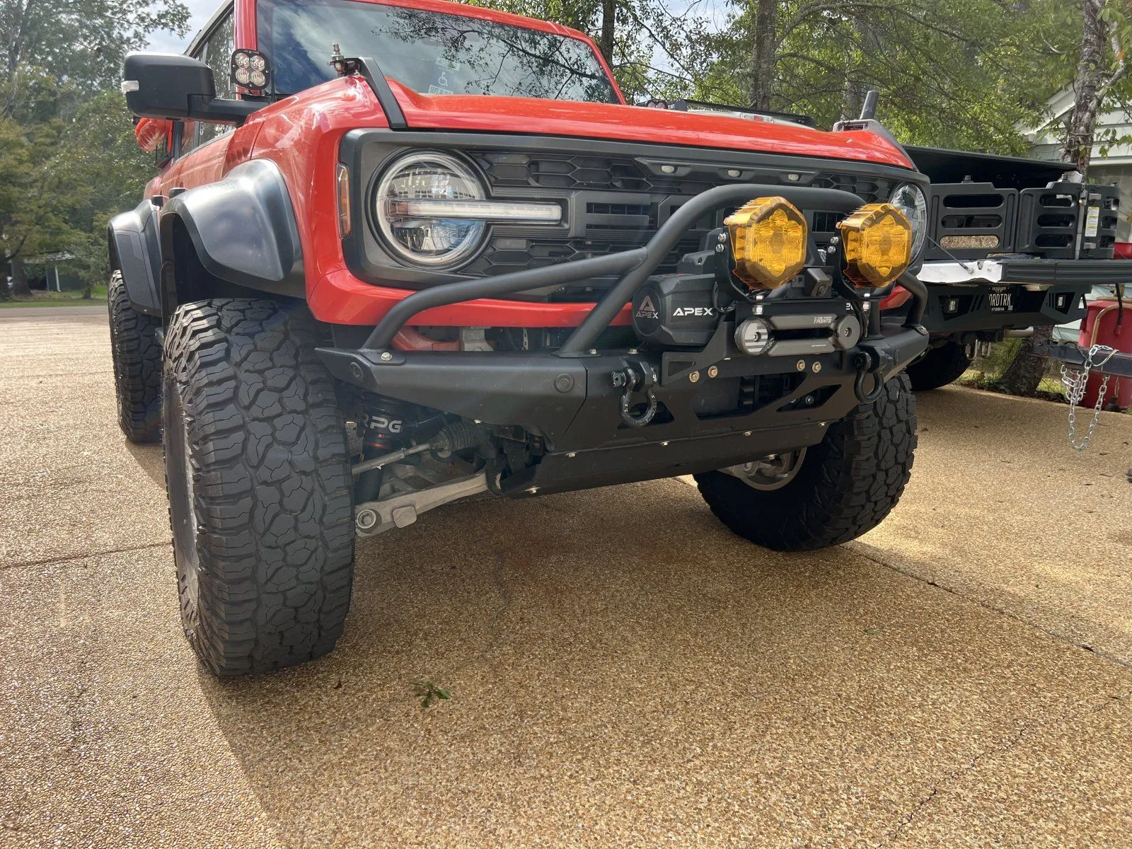

I use hitch winch setup on my 2022 Outback wilderness because the car was too new at the time and no one making a winch plate. I only use it once to pull other subaru out on a trail. it did what is does. However I found this setup is not so convenience. there are many bumper mount winch plates on the market for the Braptor to work with the factory bumper. you dont have to replace the bumper at all. even the ford performance winch kit can install on the raptor. but you need additional hardware to relocate the front cam and parking sensors.

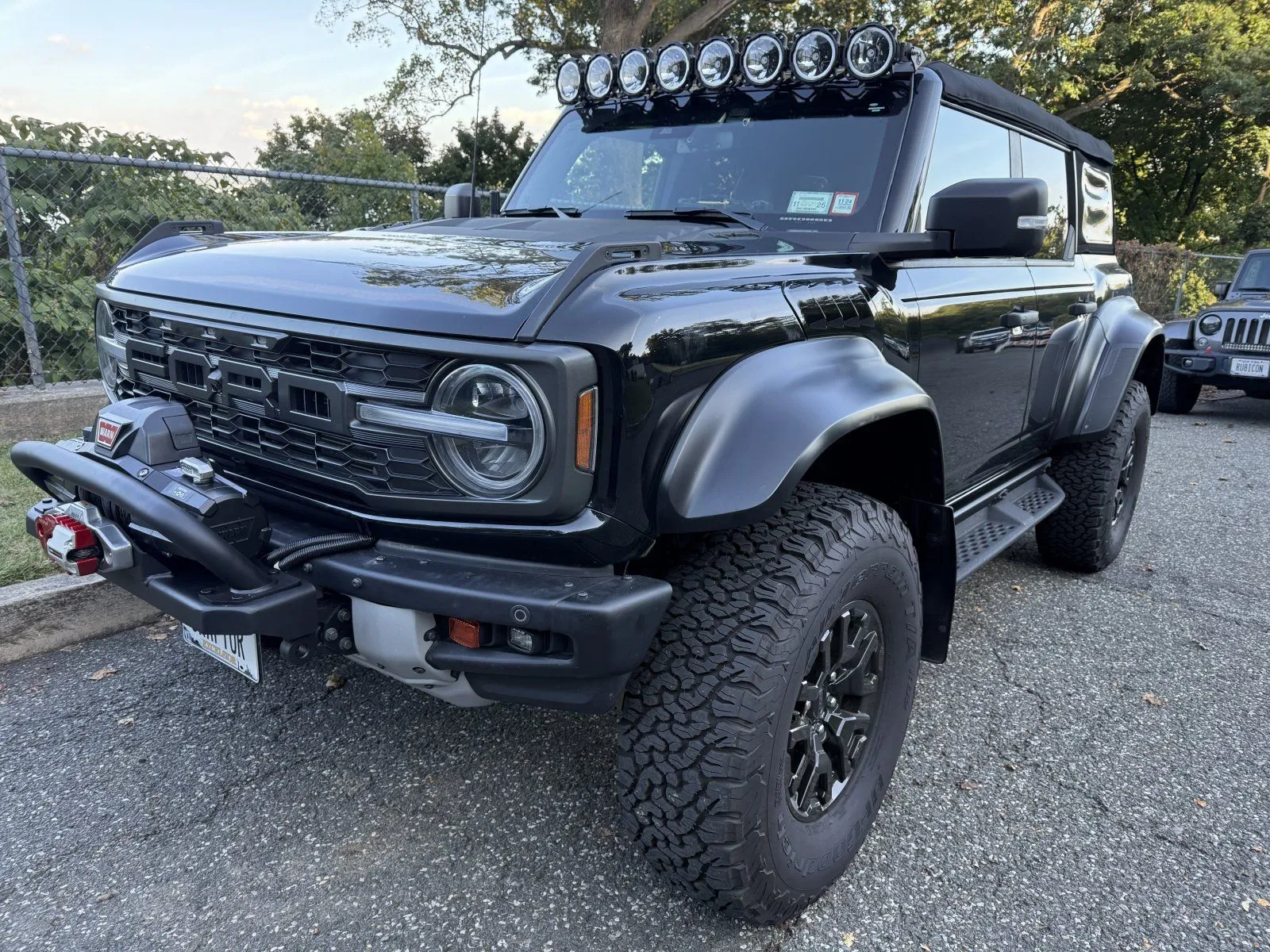

There was someone here or on 6G that installed the hidden winch on a Raptor. It required some mods but not too extensive. It does impact approach angle and it would sit in the mud if that's where you got stuck.
