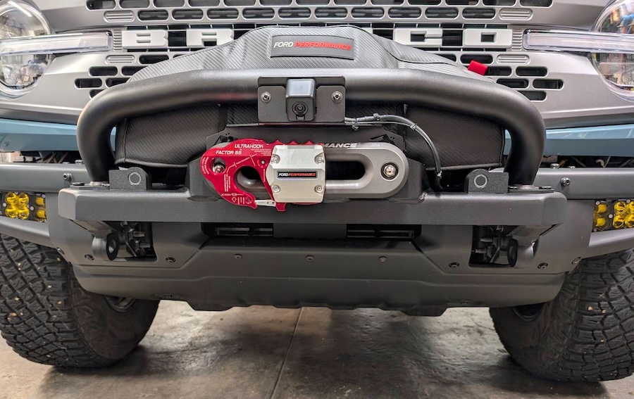

I recently installed the Ford Performance winch kit and but haven’t yet had the opportunity to to use it. I can however, advise that the price was right ($1050 and SAVE25 coupon code will reduce that by over $250). And, even though Ford says it isn’t compatible with the Raptor, it fits and installation was straightforward.

The one downside to the Ford Winch setup is there is no camera relocation kit for the front camera (that I am aware of). Also it blocks your parking sensors (also ACC if you have it, I believe). Read the fine print on the FP product site for specifics. .

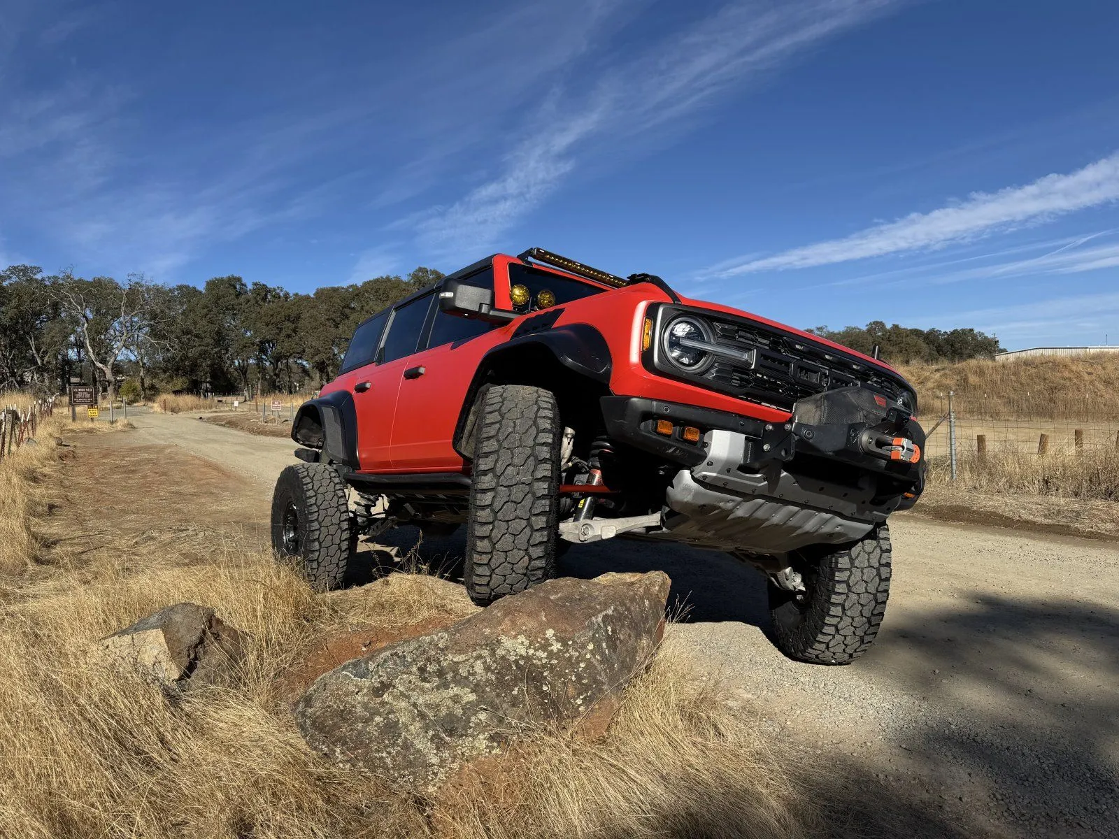

Hidden winches look nice, but they sit low where your bash plate should be. I’ve been riding passenger when the driver hit a berm, driving the winch into his intercooler among other things. I’ve bashed my plate in a deep water bar in the desert, it’s bashed but nothing else was damaged.

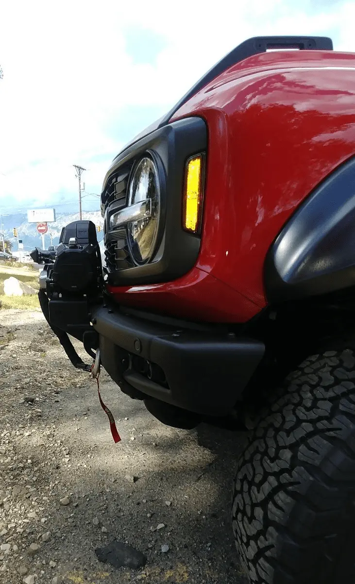

I'm partial to the Rough Country high mount (PN 51067) because of its tight clean profile, which does not impact the 47° approach angle; no impact to ACC, camera relocation, bumper sensor relocation, integrated light bar. Using with Warn Zeon winch. See my mods list.
