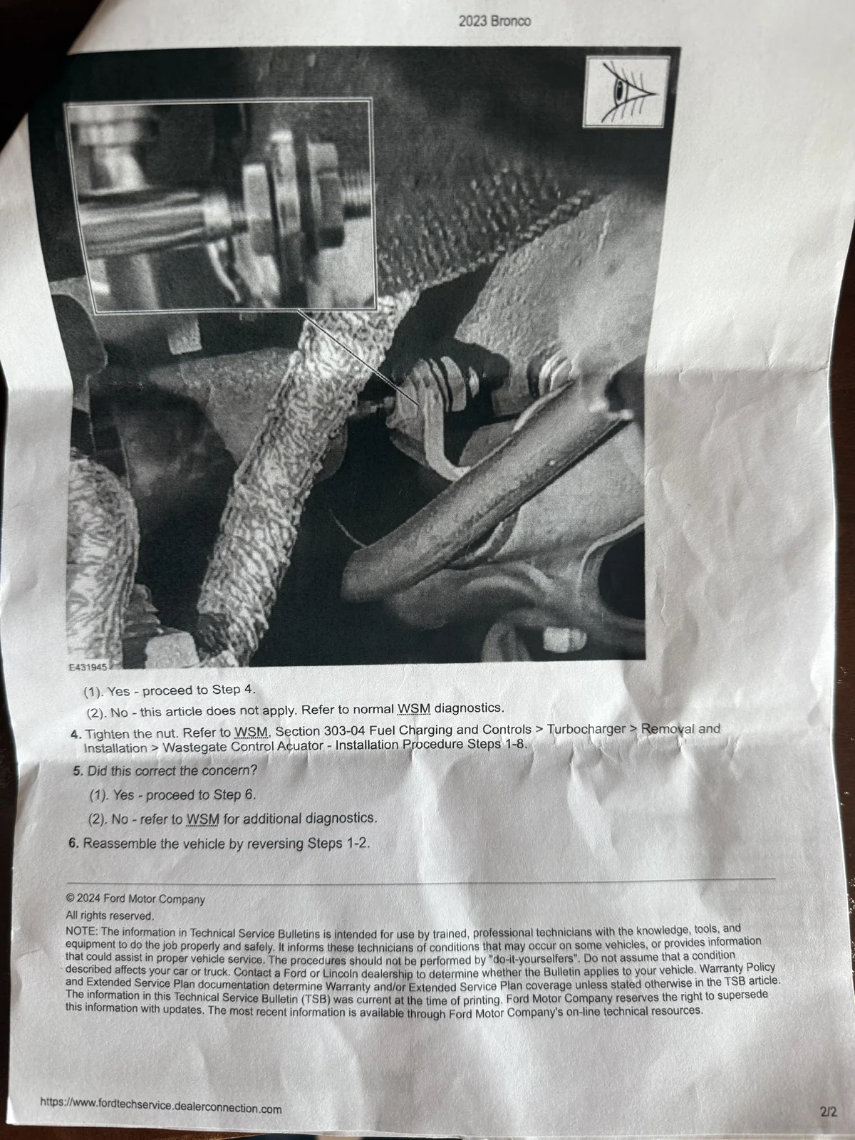

There is a bulletin that the Waste Gate may need tightening giving the issue described in this thread. The technician was able to turn the screw a a couple of times on the waste gate and that just may be the isse. Of course he took it out and it did not have the issue. The issue is so intermittent the chances of him having it are next to none.
Let's hope this is the issue and I won't have the power down and wrench or service engine light come on again.
It would be a nice easy fix and still under powertrain warranty
Here is the bulletin and fix. It seems it may have done the job. We will see. Also had a new rearview camera installed as per a recall.
