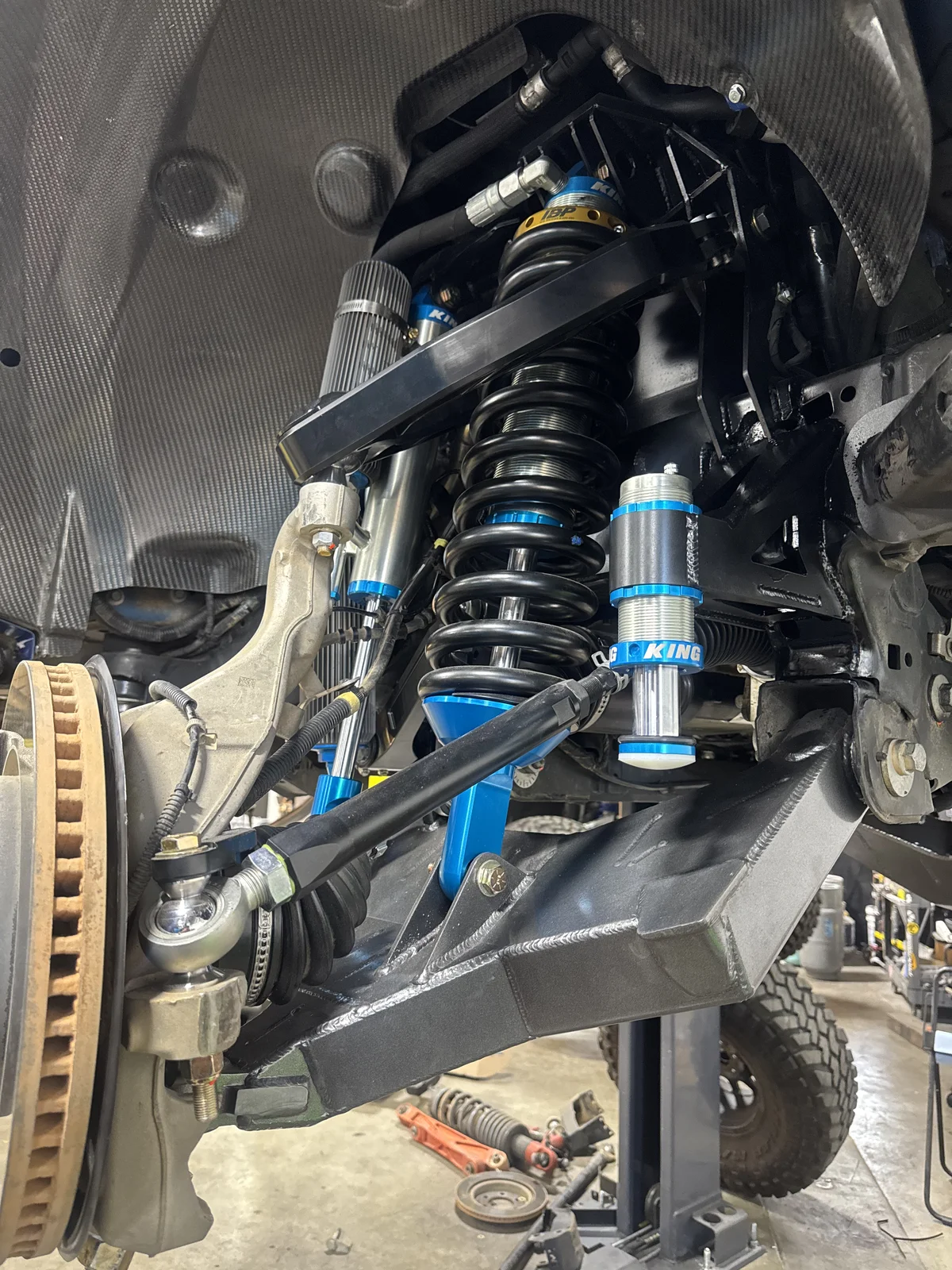

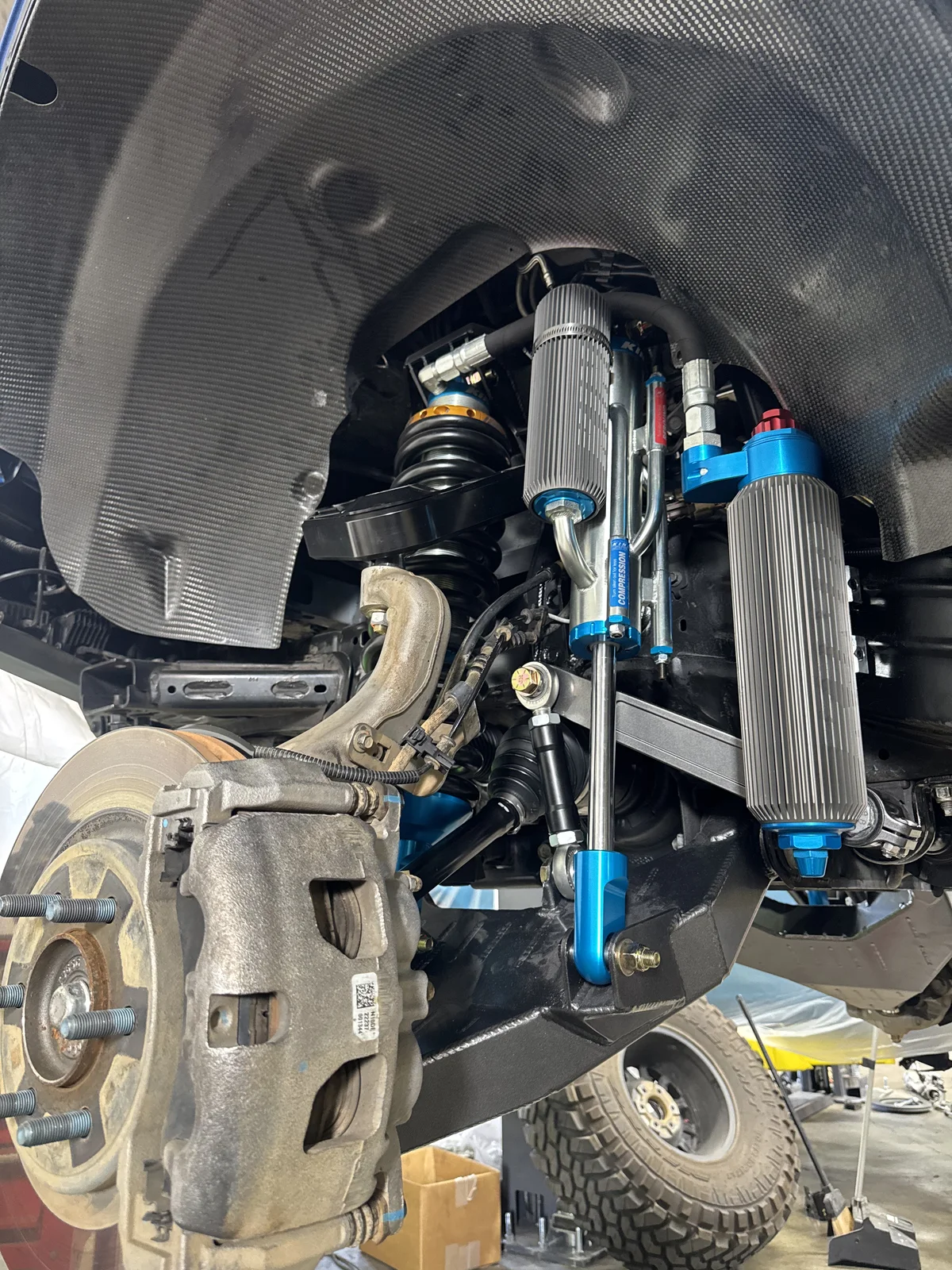

This installation is far along so I wanted to provide an initial post and to keep this updated for those interested in upgrading the suspension of their Bronco Raptor to the APG ProRunner Syspension System. This is being installed on my heavily modified Bronco Raptor with a Godzilla V8 Conversion documented here which already has the APG Carbon Fiber fender system running 40" Nitto Trail Grapplers.
12/16/2025 Update (Frontend is Complete):

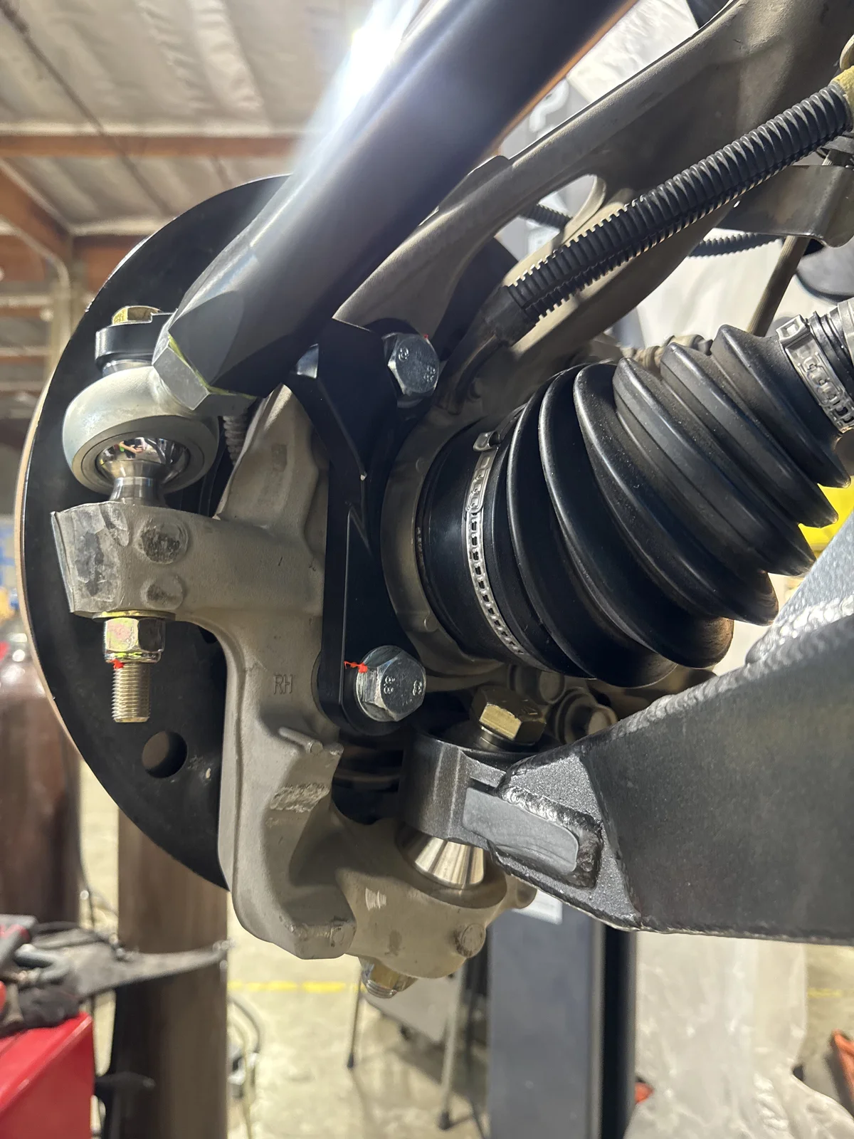

King 3.0 Coilovers, King 2.5 Secondary Bypass Shocks, King 2.0 Bump Stops, double-sheer billet aluminum HD tie rods, APG upper and lower control arms, and even the Braptor sway bar are all completely installed. This setup re-uses the OEM Bronco Raptor knuckle, too.
12/8/2025 Update (Original Posted Information):
Here is an in-progress update of the suspension partially installed on the frontend of my Braptor:
The APG ProRunner System details are as follows for the Bronco Raptor:
APG ProRunner Front Suspension:
