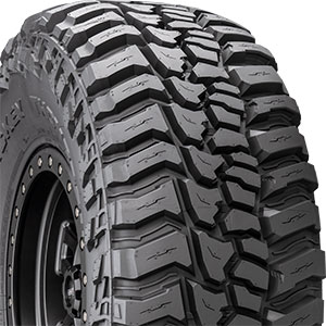

Ohhh this Baja Boss M/T is a killer looking tire! IMO looks much better than the K02's. I love this subject along with wheels so appologies in advance for possibly providing info your already well aware of.
Baja Boss M/T
Gaining 22 lbs but as you said could be offset some with lighter wheels. The extra weight could have slight effect on shock tuning, maybe noticeable in high speed baja running. The extra diameter may add extra stress on steering rack housing but can be mitigated by being cautious with tire side loads and when rock crawling. Unless you plan to baja race, I would expect the axles to be fine with the larger diameter and weight. My experience when changing tire diameters it's helpful to have a tuner that adjusts for tire size, thereby modifying trans shifting.
Tire tread sipes are very important in the snow as you want the tire to hold the snow as snow sticks to snow better that rubber to snow. Mud is just the opposite so mud terrain tires are designed to clean the mud out of the tread.
