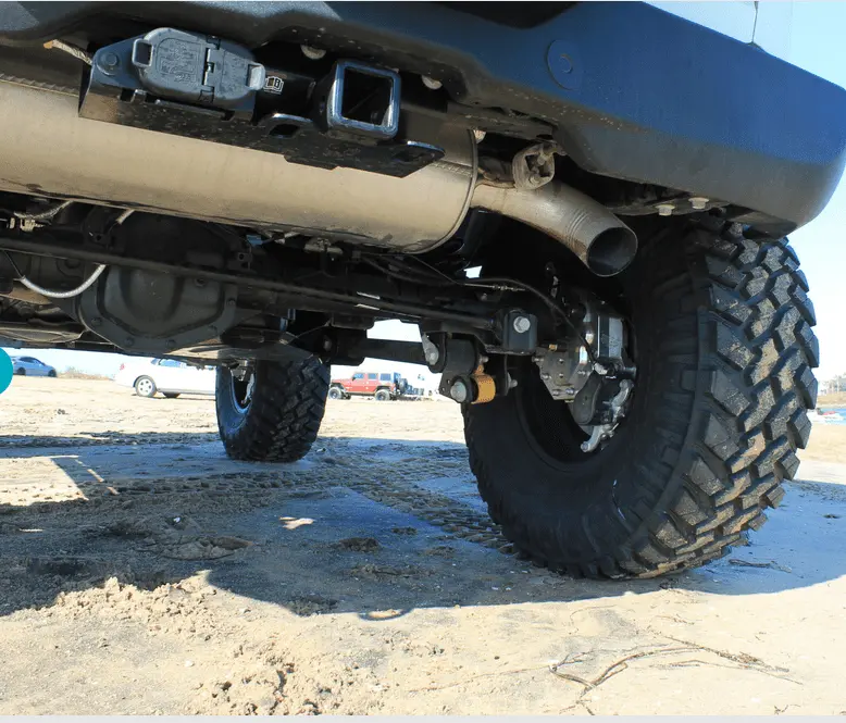

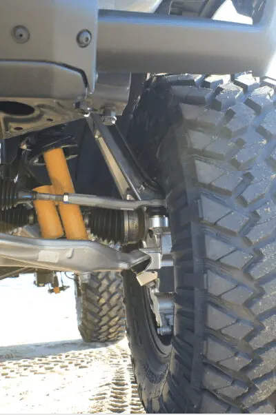

Pics of Bronco with portals sourced from 74Weld:
Notice the axle is now above the centerline of the tire/hub assembly, but suspension is still OEM.
Same for the rear solid axle
