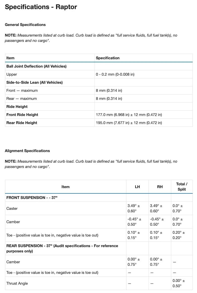

Been talking to several off road shops to install lift collars and align. One of them came back with this:
Regarding alignment, most offroad rigs like 3-5 degrees of caster, a 1/2 degree of camber, and a 1/4” toe, regardless of make, model or brand.
Curious to thoughts on this and what have you been using for alignment specs if you added lift collars?

My feeling is stay within OEM specifications, Ford tested these Bronco Raptors for years in all terrains. Sometimes the manufactures will have "track" alignment specs. I haven't seen anything like that for our Raptors but I haven't gone looking either.

Ive also been trying to find the OEM specs
In case this is helpful for everyone, here are Ford's Alignment Specs for the Bronco Raptor.
Excellent, thank you for posting. Did you get your Bronco Raptor re-aligned post lift collars?
Yes I did
Glad this was posted...having my Foutz Collars on order through a local shop so hoping to get them installed and then realigned very soon.
