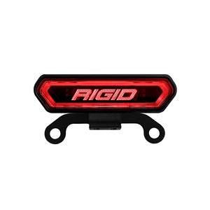

Has anyone mounted the Rigid Chase Pod light yet? seems to solve a lot of problems (rear visibility, better back up lighting, chase light functionality, rear work light) in a concise package.
Just need a bracket solution that is Raptor specific.
I’d also be interested in any wiring learnings. I’d guess the tail, brake, courtesy and reverse light’s works with the existing harness and. I’d need to tie into the Aux wiring for chase and work light functions (or maybe the zone lighting function handles that). I’d be very interested in a ready made pigtail harness…

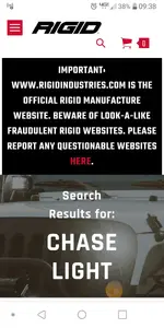

They don't explain the chase light option very well. Is it Amber?

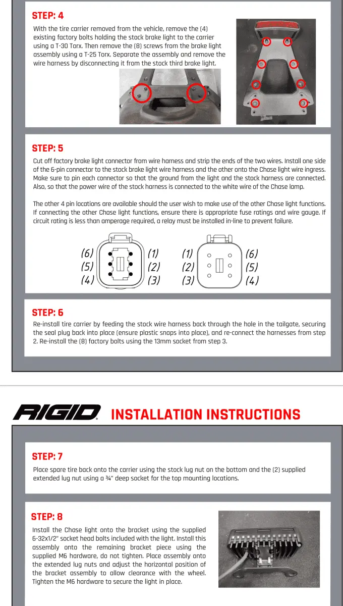

It's not easy to chase extra wire from the AUX switches, but it can be done. I'd worry about going out the tailgate. Maybe you could fish some wire through the OEM grommet.
View attachment 9225 View attachment 9226

They don’t explain anything related to these lights very well. I’m not sure how they manage to sell them.

CJ Parts does a pretty good video demonstrating the features. It appears that you can choose yellow or red light, but that color is the same for the brake light and the strobe. Thus I’d go red to best fit my requirements. The bottom courtesy light is handy if you relocate license plate to the spare.
