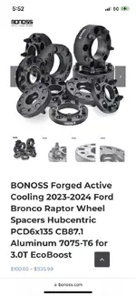

Anyone have experience with them ?
I’d like to keep OEM beadlock wheels but help with spacing for new bigger tires with better offset

Not on my Raptor yet, but considering 3/4" (19mm) spacers from Bora. With a positive offset of 34mm on our OEM wheels that will still leave a positive offset of 15mm. I would only install Bora as they are manufactured per order in Arizona (order/serial numbered). From my experience, they also have a tighter center hub to wheel (hub centric) fitment and I have confidence in their spacer lug bolts durability.
