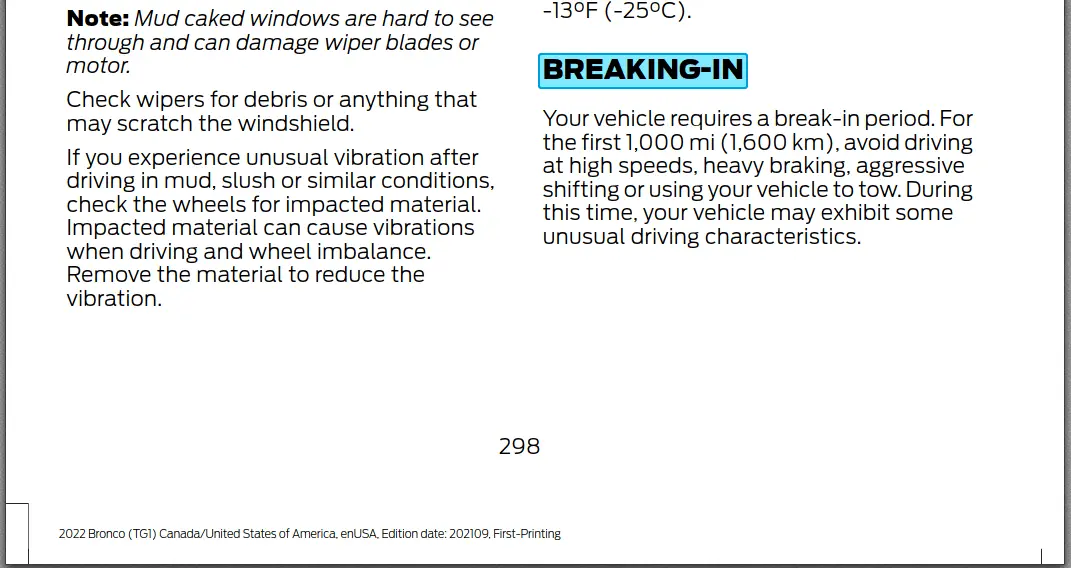

Does anybody know what if any is break in mileage, some talk of 1000 miles??
Taken from the 2022 Bronco owners manual:
A agree with Ford on the no towing or heavy loads on the engine the first 1000 miles, I've even heard higher mileage before towing.
I'm not sure if it's needed anymore, but I also vary the speed/engine RPM's for the first 1000 miles.
For the first 500 miles I take it a step further, once again may not make any difference with the engine but I feel better and I've never had a engine use oil after following these guidelines.
Short trips, constant on/off throttle, less that 30 minutes allowing engine to cool between trips. Gradually increasing max engine rpm over time (once engine has reached operating temp), approximate values below as a general guideline.

Thanks for this helpful explanation in great detail, i was entering incorrect subject :)
Honestly way back when i was young and foolish I would break them in the way I intended to drive them, never had one break amazingly!!
Also worth noting, during the first 500 miles, with on/off throttle and increased frequency in transmission shifting, I noticed the transmission temp climbing, when it reached 210 degrees I pulled over and let cool down, it was in the mid 50's with 25-35 winds, so it cooled quickly. I was not driving aggressive, but as mentioned above from the owners manual even the trans needs to break-in.
Its been rumored that the engines have been broken it at the factory, but you can't argue with the printed manual... 🤐
