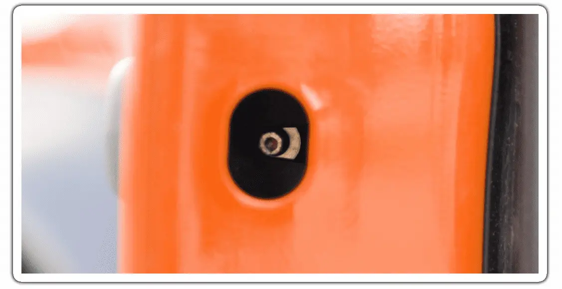

1. OPEN ANY DOOR AND IDENTIFY THE GROMMET SHOWN TO THE LEFT. REMOVE THIS GROMMET TO REVEAL A 5MM BOLT, SHOWN BELOW.

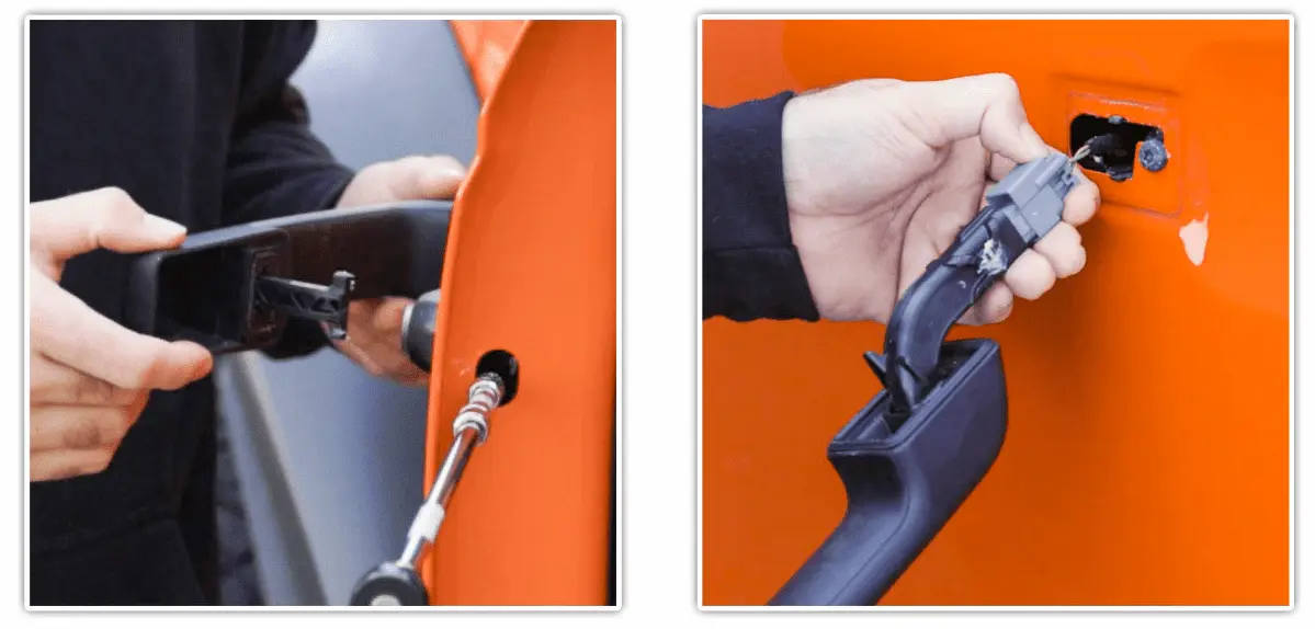

2. USING A 5MM SOCKET AND EXTENSION, START TO UNSCREW THE BOLT UNTIL YO U HEAR A SMALL CLICK. THIS CLICK MEANS THE BOLT IS FULLY UNTHREADED AND THE DOOR HANDLE IS LOOSE.
3. JUST LIKE YOU’RE OPENING THE DOOR, PULL THE HANDLE UNTIL IT POPS OUT OF PLACE. ONCE POPPED, YOU CAN EASILY REMOVE THE DOOR HANDLE FROM ITS GROOVE. IF APPLICABLE, UNCLIP THE HARNESS.
4. INSTALL THE NEW PAINTED DOOR HANDLE FOLLOWING THE SAME PROCESS. WHEN TIGHTENING, DO NOT OVER-TIGHTEN! A SIMPLE SNUG FIT WILL BE JUST FINE, AS IT IS THREADING INTO PLASTIC.
