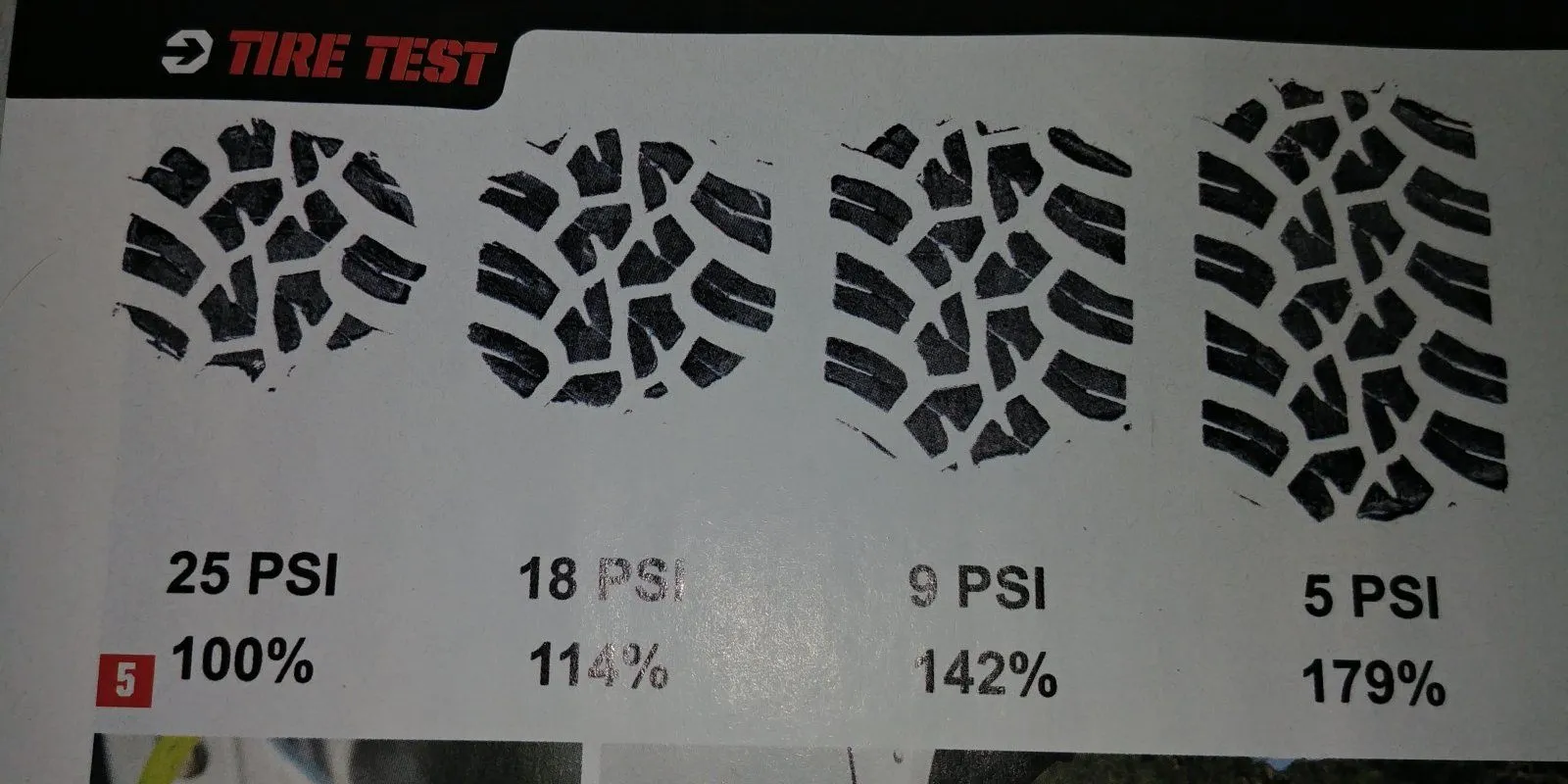

The R12 was at 32 psi as reported by the TPMS. I thought that was a bit high given I generally run 40 psi on payment, 20 psi on rock, and 15 psi in sand (depending on how the tire tracks look). Bri noted that BRO was trying to use a pressure for all of the terrain exposure for the day: [1] basecamp trail, [2] highway, [3] dirt road to Raptor Valley, [4] Baja course, [5] Ultra4 course, [6] rock crawl course. The off-road FOX live-valve setting gives a softer ride at higher pressures.
I've never driven [4] or [5] before so who am I to say what the tire pressure should be for that.
That is an interesting read. My friend who has run the Baja many times who I posted about his dad in the Off Road Hall of Fame runs his tires at full pressure and will only air down if he needs to get out of somewhere. Interesting. I posted on another forum I was going to ran basically at full pressure and people had a heart attack. Only one guy said if you are running 1, 2 and 3 grade trails there is no need to air down. When rock crawling it makes sense to air down but for desert high speed it seems not too much.
I like the idea of 32 psi, it has a nice ring to it. I found it interesting some where getting flats at 28 psi I believe. Interesting a guy was running a Chenowth car.
