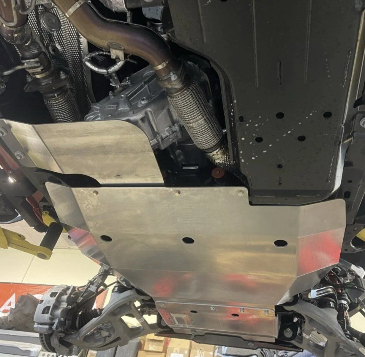

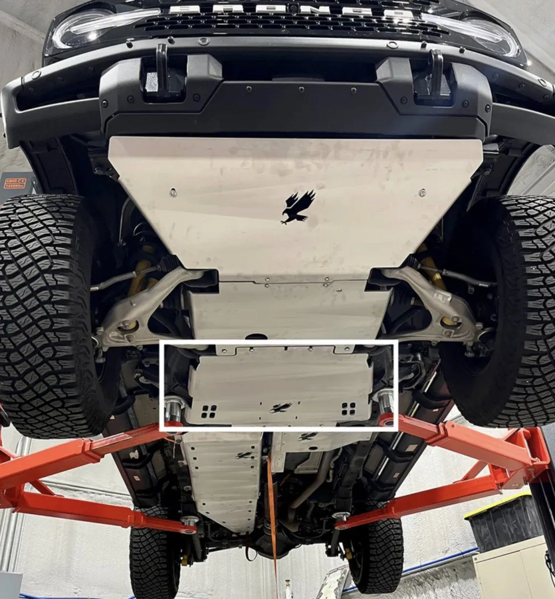

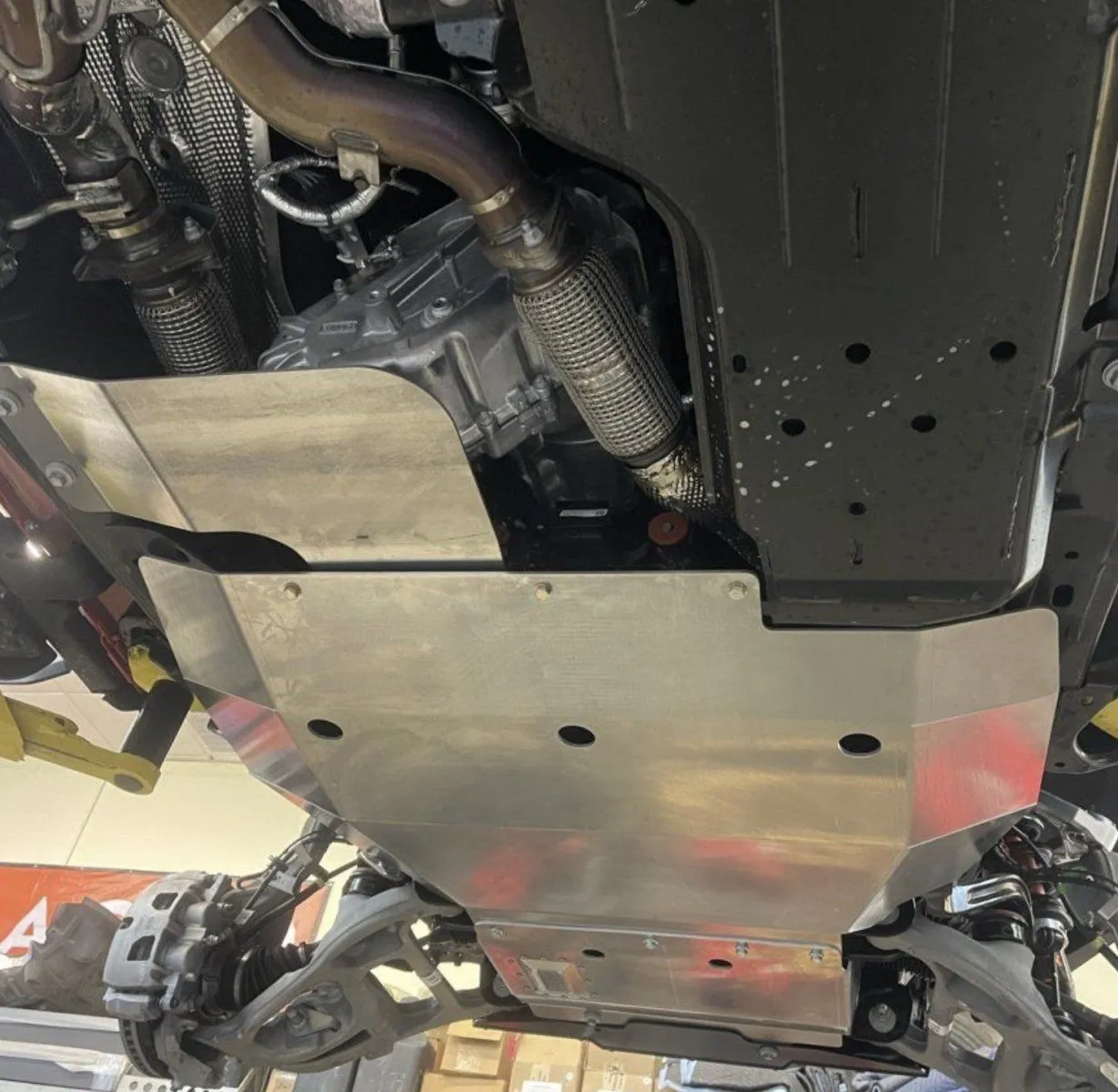

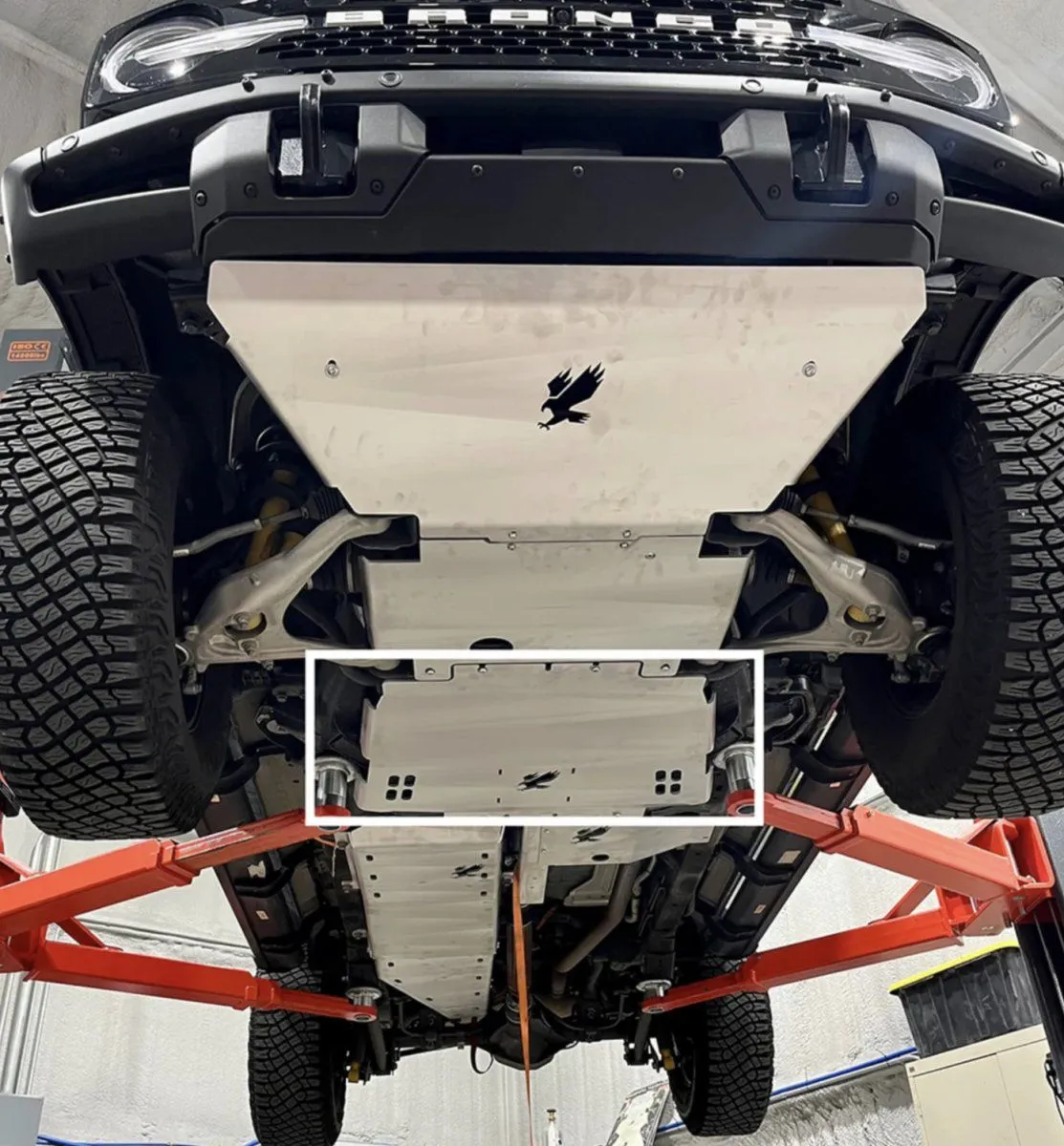

Depending on your region you may have heard about the high frequency of catalytic converter thefts due to the value of the precious metals used (Paladium, Platinum, Rhodium). Given how much clearance the BRaptor provides it’s been a concern of mine of how easy it might be to be targeted for theft. I find myself pretty paranoid of parking in public for any extended period of time.
And when you look underneath the vehicle it appears as though they’re in a fairly convenient location for access/removal. Am I missing something in terms of my concern? Are there any skid plate options that might at least hide them from view and thus deter a thief? Even if a bolt-on product is easy to remove, it still slows down the effort while hiding blocking visibility of where it sits. Would covering the cats create some overheating issues?
When I look at the FMI skidplates they don’t seem to cover the cats And not finding any other options that I know will fit the BRaptor much less ‘protect’ the cats. Talons Garage has some that help with this for the 2.7 but I think those are located slightly higher and less accessible.
Here’s a couple of images for reference:
FMI Skidplates:
Talons Garage (on a 2.7):

I don't think there is a significant concern with the catalytic converters being stolen off a Bronco Raptor, or at least much less likely. They are very difficult to see let alone get to with a Sawzall (reciprocating saw). What's shown in the pic above and below left is the exhaust flex pipe in the mid section, the Catalytic Converters (large diameter with silver/goldish color heat shielding wrap shown below) are in the engine compartment fastened directly to the Turbo's. The thieves are after the catalytic converters that are under the car (low hanging fruit) and can be quickly removed with a sawzall within few seconds.
I do agree the FMI transmission skid plate would make the theives task even more difficult, but as we know, almost nothing is impossible.
Pic below of the Bronco Raptor chassis showing exhaust starting with the Cats that bolt to the Turbo's.
Thanks for the clarity. I was confusing the flex pipe for the cats and now you’ve confirmed that I was missing something pretty straightforward.
You’re right, there’s no accessing the cats without some serious disassembly of other parts. And now that you show this I think I remember a video of the install of the downpipes which took some work to get everything out.
One less thing I need to worry about much less potentially purchase!
