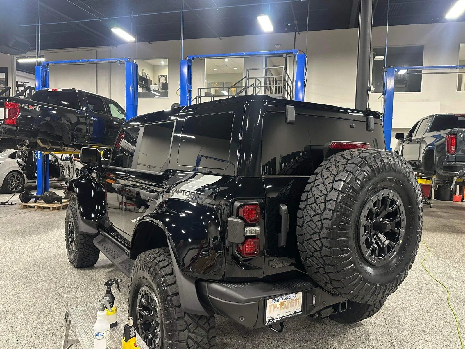

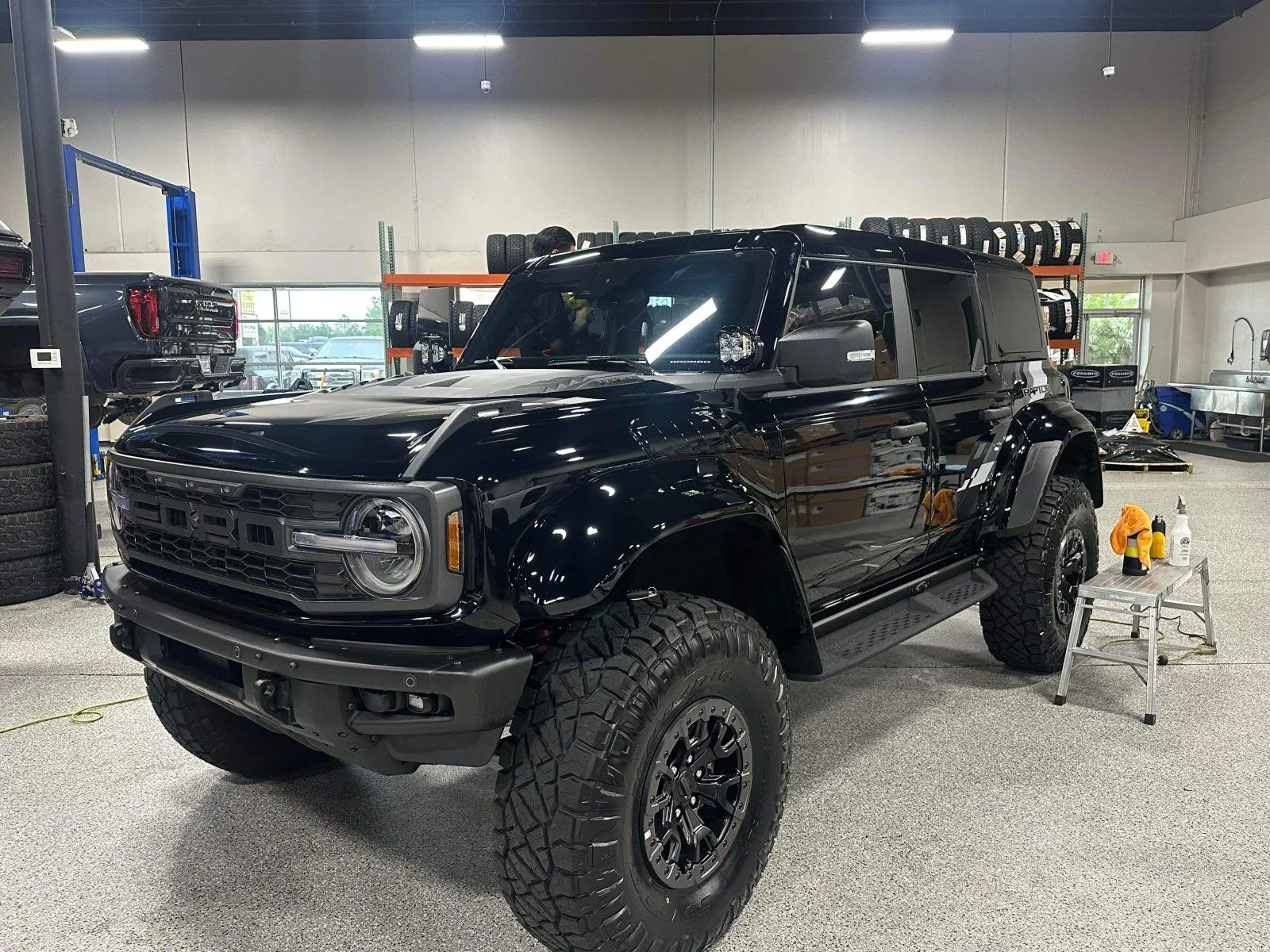

I went with 2" in front and 1" in the rear Foutz collars on Nitto Ridge Grappler in 38 on stock bead lock wheels. Not sure how the RGP are with sizing as I heard it is different that the Foutz collars.

Yes once I get it back. It is in for full PPF, ceramic, ceramic tint, windshield ceramic, exo shield, Fouz 2”-1”, 38’s, painted top/fenders and PPF on fenders, LP4 pillar lights, dashcam’s. Hope to get it back in the next couple days. It is a fully loaded black with graphics.

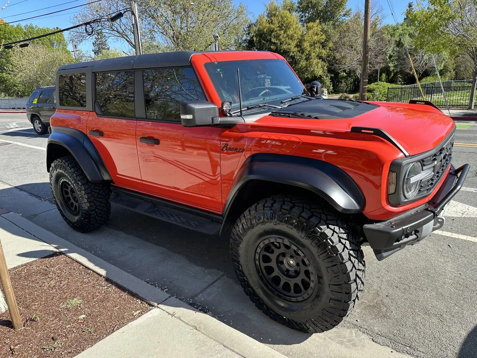

I think your proposal looks good! I don't think you'll have issues running 38's without any additional lift. I just put on some 17" 0 offset methods with 38" Nitto Ridge Grapplers. The wider offset wheels (vs stock) will give you a little extra space you need to run 38's. I will eventually lift mine 1.5", but it looks good without it too. Last comment - the difference between 0 and +6 offset is very small, I wouldn't let that sway your decision on wheel much.

Sorry for late reply on this one. Method NV305 in double black. Attached a quick pic, don’t mind my missing center caps lol.
Sorry for late reply on this one. Method NV305 in double black. Attached a quick pic, don’t mind my missing center caps lol.View attachment 7713

Should have it back mid day tomorrow and will get the height and specs.View attachment 7731View attachment 7733
Wow!! Def making me consider painted fenders. Looks great and those 38s fill the wheel wells nicely.
Please do provide the before/after heights with the Foutz collars when you have a chance. I’m ordering mine this weekend and was planning either 1” front/0” to level or might go 2”front/1” rear like yours. Thank you in advance and congrats on an awesome looking Braptor!
