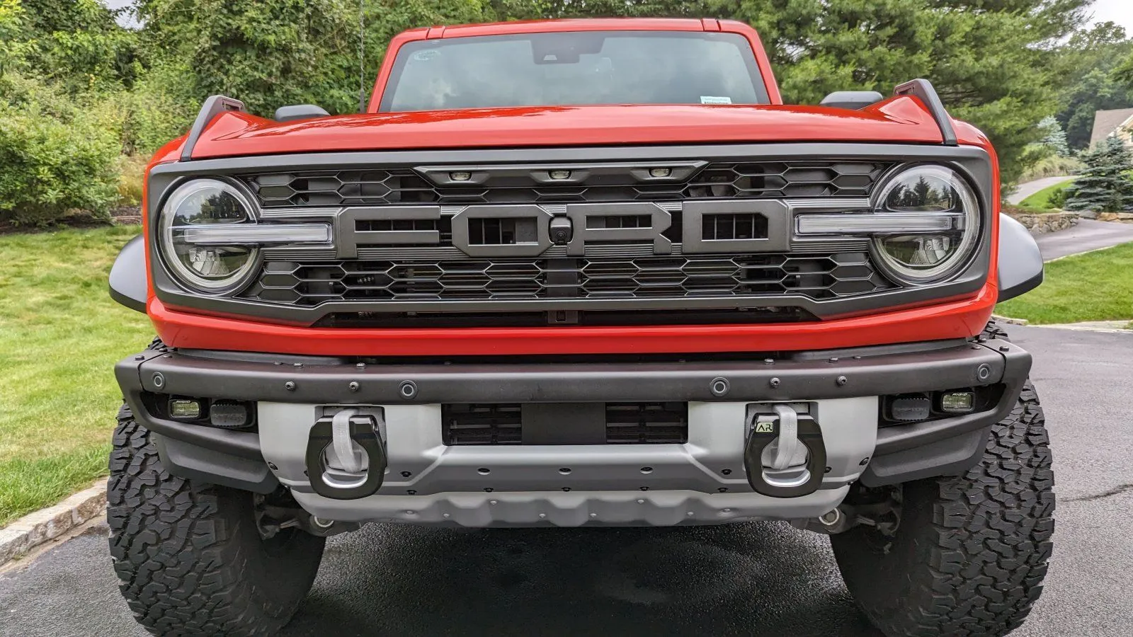

Several of our members here now have these front bumper Shackles (D-rings)
I spoke with Bubba Ropes. They believe with Chafe guards I should be fine. As well, the Raptor front clevis the edges are rounded so I should be fine..

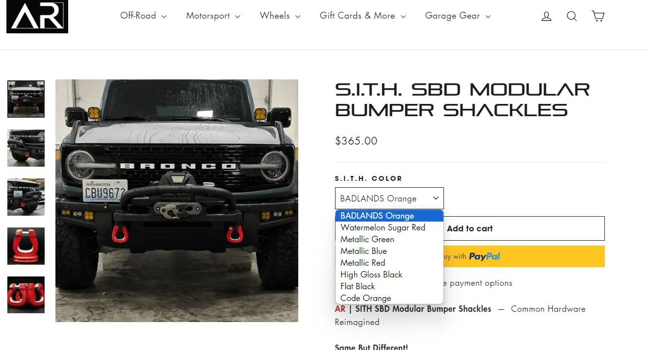

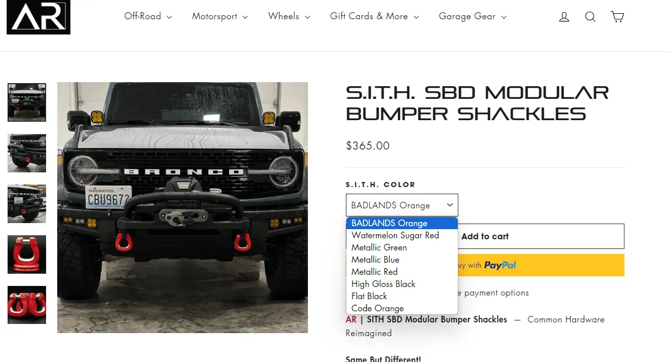

Are you looking at the SBD ones? Those are the smaller version. The original SITH are the ones I have and they are available in gloss and flat black. There's also a Bronco 6G coupon code if you want to get something more custom or have questions - reach out to Curtis (EIGHTLUG on 6G) and he will get you squared away.
No - even the smaller ones come in black - not sure where you were looking. But here's the website

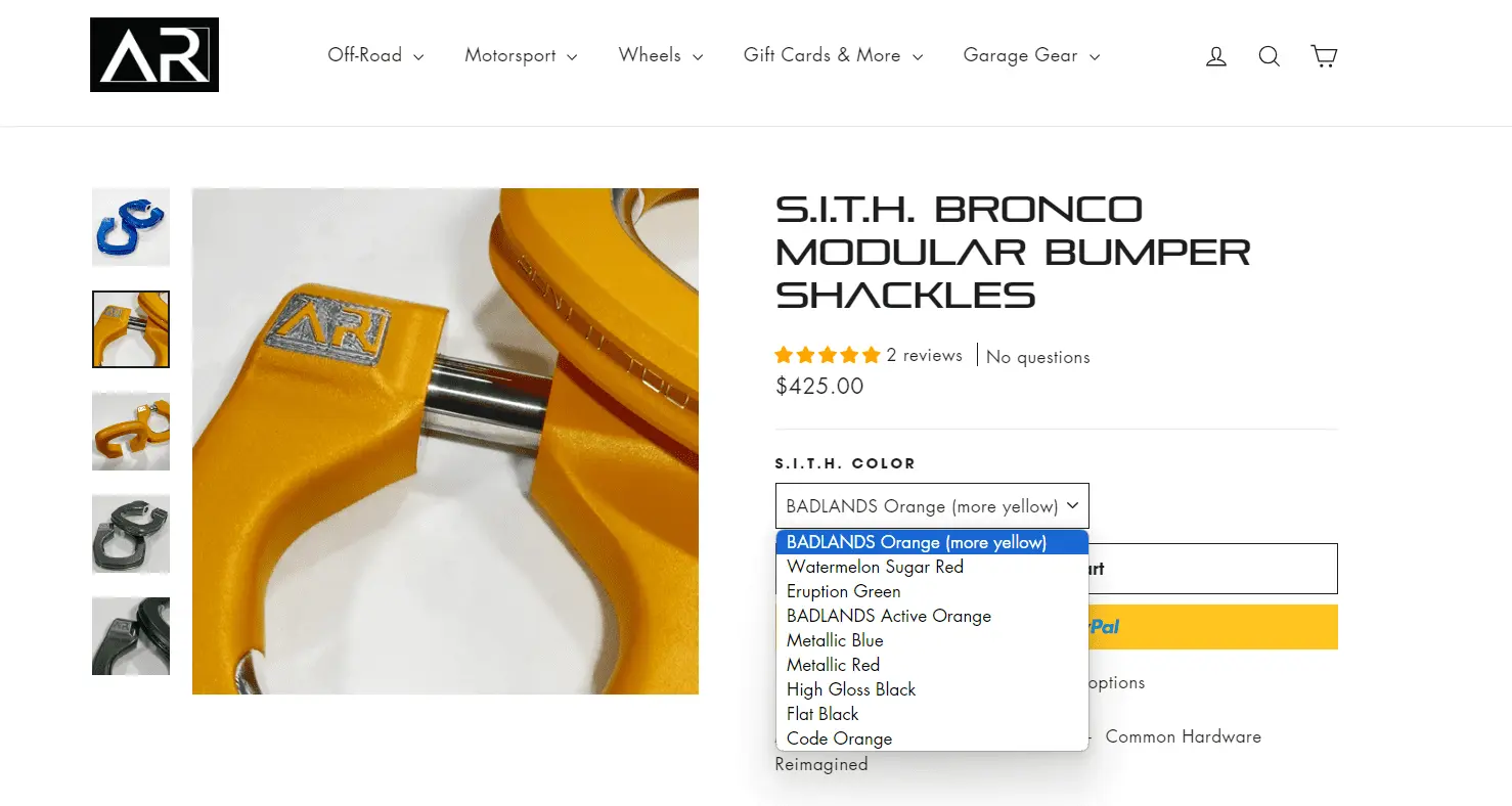

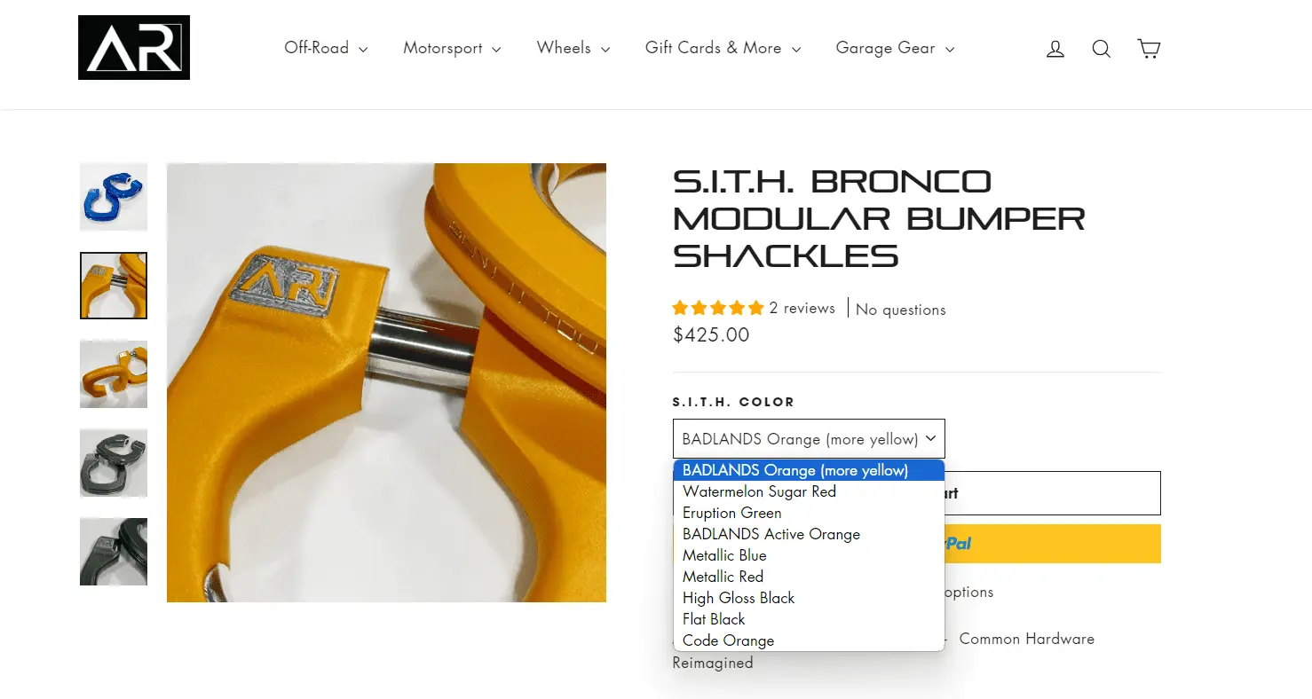

Great thanks, I was going to the hitch mounted D rings. The pictures drew me in and they do not come in black. Thanks, I looked a few times and every time I clicked on the hitch mount.
