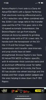

Found this recently
And according to the spicer website 11/32” tubes are same as 9mm

Seems like the Dana 50 in the raptor maybe same
Unless they have smaller that the Dana listed 35 spline rear axles
Also found out that the raptor has the 32 spline front CVs allready
