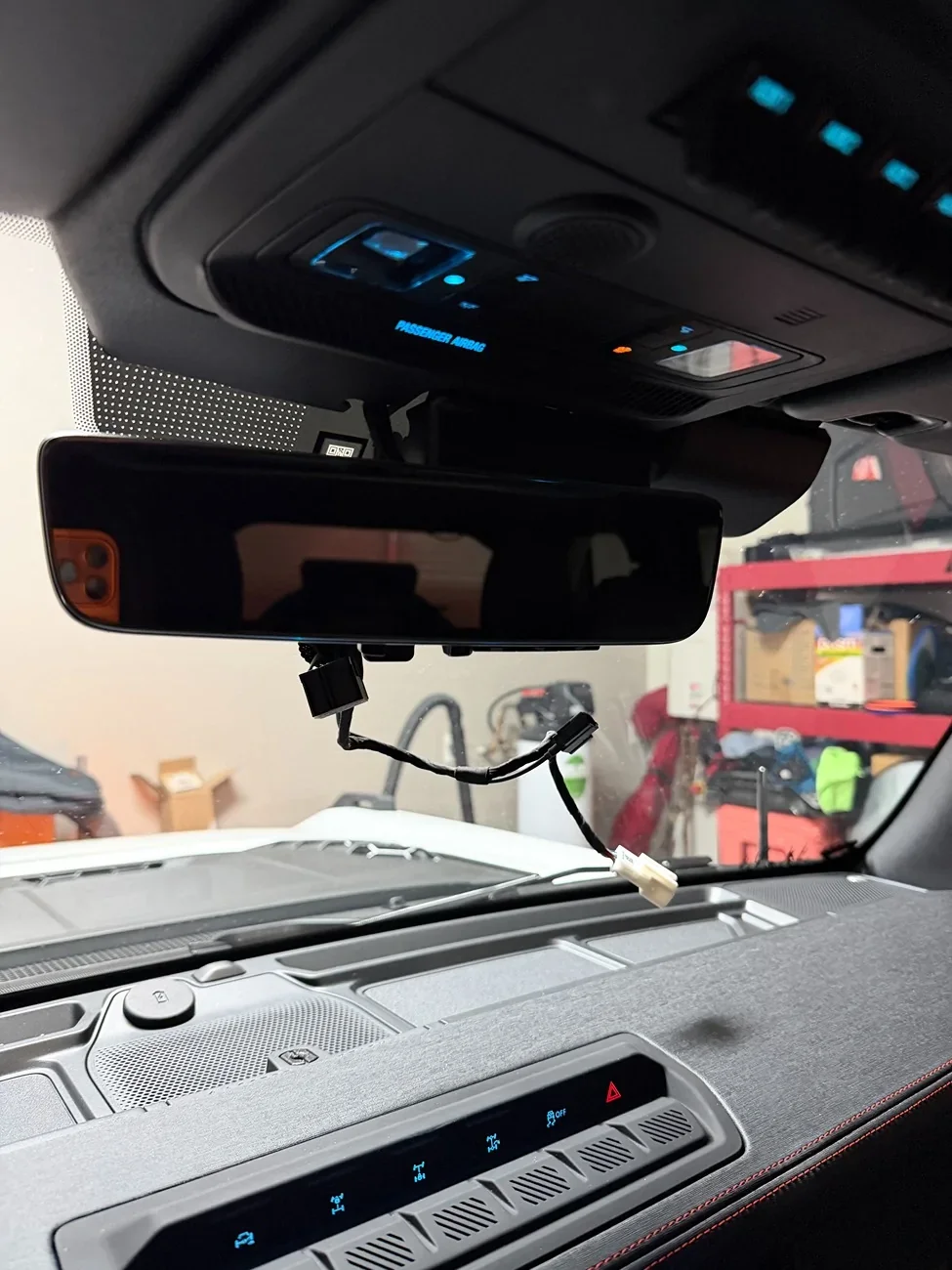

I did a trial fit of the new VOXX mirror and as far as mounting goes, it is a direct swap from the non-digital 2025 bronco mirror (which is also made by GENTEX). Do you just back out the screw, pull of the old mirror, slide on the new mirror. Exact same placement/size, etc. yay.

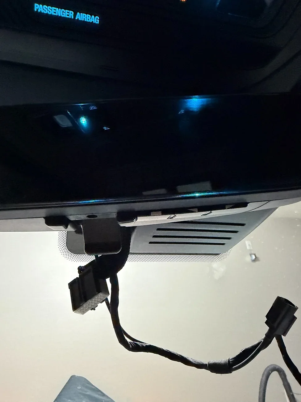

Next up is wiring. The factory non-digital has 3 wires running through a 16pin harness. The VOXX mirror (and likely the OEM Ford version) have a 12pin CE connector. Pins are all about the same size, so my first approach will be to pull the pins from the 16pin male connector coming from the roof and repin them into the 12pin male connector for the VOXX version. If that works, its will just plug in from what looks like the factory wiring. if that doesn't work, I will look for an adapter for the plugs... and lastly I could just splice in the wires.
For the camera... pretty simple, I just need to run the camera coax from the mirror area to the right rear corner, then through doors wiring mesh to the door itself and up to the 3rd brake light.

Here is the new mirror mounted up.
