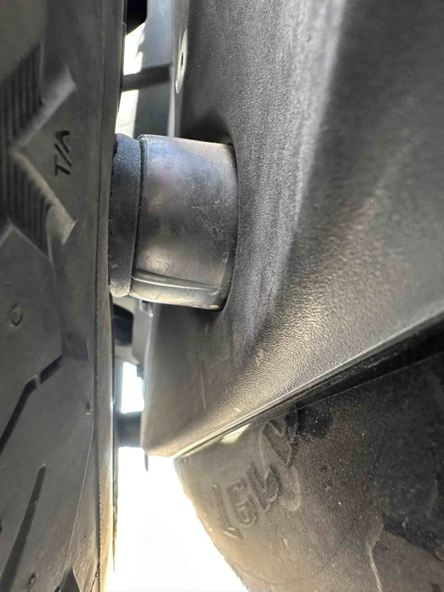

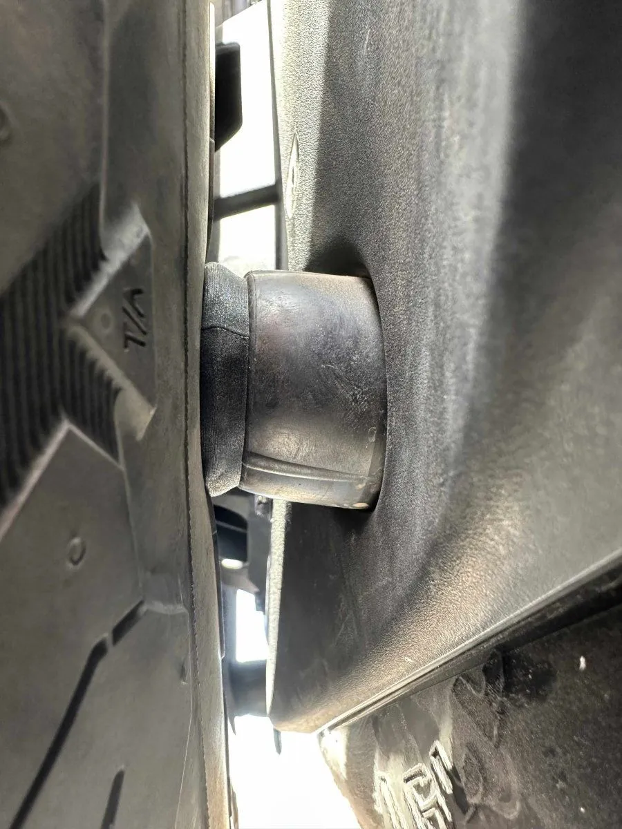

Since I put on RTR Evo 6 rims +18 off set it seems my spare tire carrier is rattling when I close the back door. I don't really care about this but I don't want it rattling a lot while off roading. I haven't even been ripping down gravel roads since I did the PPF on my doors. I am waiting till next week when I put on my RCI rock sliders. They may stop a few more rocks than the OEM steps since the are slightly longer and I have removed the front mud flaps......we shall see. Either way I don't care as this is the final addition to this area and I will live with how it all works and whatever flies up. So I am not sure if this will rattle off roading. I think it will.
I do not remember this rattling prior to the new rims. It may have.
I don't think the bottom stoppers make much of a difference, I may be wrong. I don't remember the gap with the top picture. I was looking for some kind of rubber stopper or something to add to these plastic ends to keep the spare tire bracket firm. Does anyone see this as an issue? Do others with OEM rims have a gap? Has anyone come up with a fix? I appreciate all feed back. Thanks

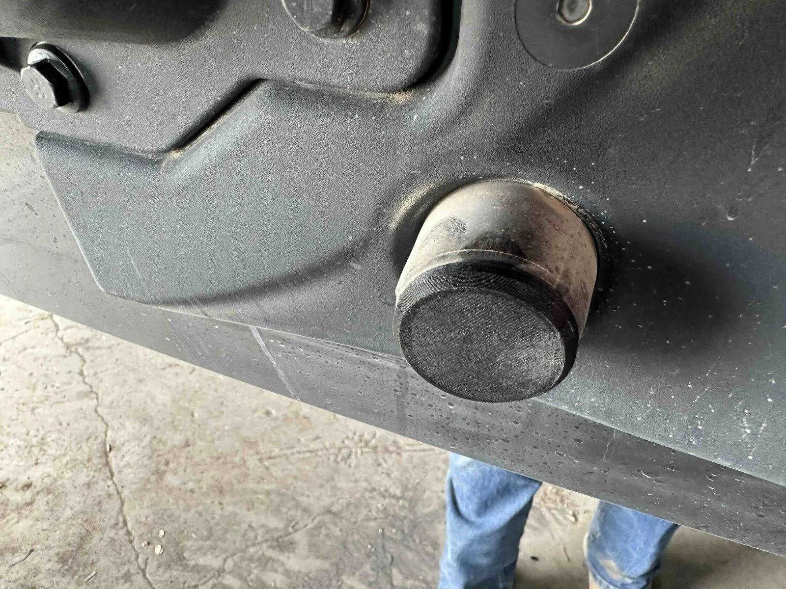

Well first I want to thank @JohnGalt for posting about the fix. Great fix. I had the parts in a few days. Doug sent me a couple of options since he hasn't done a +18 rim. Smaller and larger brackets and bumpers. He asked if I could give him feed back so he can add it to his list of rim sizes which of course I did.
I cut the larger (3/4 inch) of the two bottom bumpers to about a 1/4 inch with a hack saw. You can see the gap in my first post.
jpeg33-jpg.11545
These are the 1/2 inch bottom bumpers. The smaller of the two bumpers sent not cut like the first set. They fit well just a bit too tight for my liking. They are now back ups.
These are the bottom bumpers I cut to approximately a 1/4 inch from the 1st picture above. The fit is great.

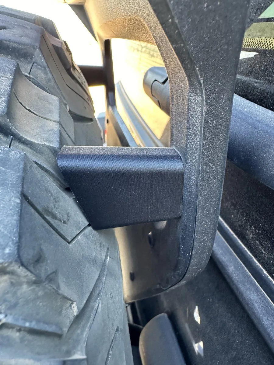

The larger of the two sizes he sent me fit perfectly for the top brackets. The 1/2 inch
So it all worked out well. The top brackets fit perfectly and I cut the lower ones to fit better. Doug is going to note these changes for his products and fix accordingly.
jpeg33-jpg.11545

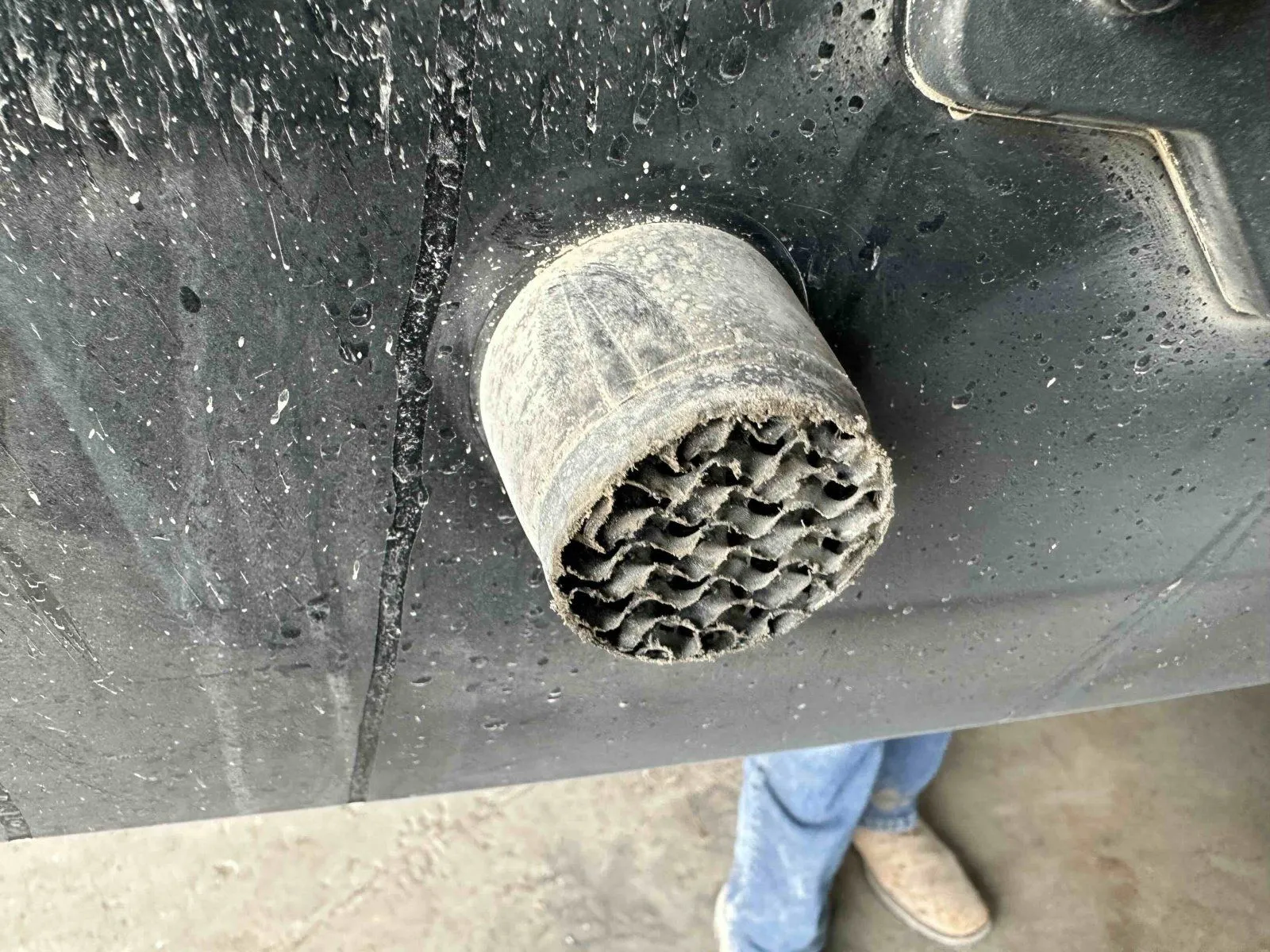

A quick update. In my posts before I cut the larger bumpers Doug sent me to fit with my off set of my new rims. I was perfectly happy with my modification. Doug sent replacement bumpers shortly after we discussed this issue. I thought he wanted the details for any future orders. Needless to say I was happy when I got the new correct size bumpers based on my modifications and discussions with him.
I have had them for quite awhile and just got around to putting them on when I did my chase lights.
Below my modification and below that the correct size bumpers Doug at Sinister Speed Shop sent to me.
They are a perfect fit.
