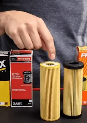

Just changed my oil @ 600 miles, picked up new cartridge at the dealership. When I drained oil and pulled cartridge out it was different than the new one. The original was much beefier with hard rubber ends with a small rod from end to end to enforce. Called dealership said on his computer it stated the replacement will "not match original" I almost cleaned old one since it seemed so much better but did install new one? Anyone else have same result??
Correct, the FL-2062-A as he is pointing to below is the correct filter, filter on the right is what came in our 3.0L but no longer available. Appears factory is using old stock.

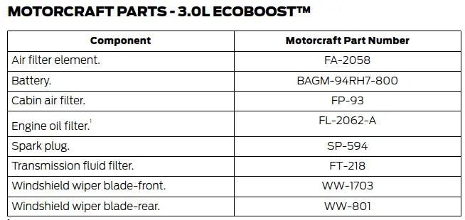

Below copied from our Owners manual:
Yes that’s the replacement filter I have installed that he’s pointing to
Also, the original filter had small stainless rod from end to end I'm thinking if you're slamming your Braptor down on a jump this rod could keep filter cartridge from collapsing. Why else would rod be there??
