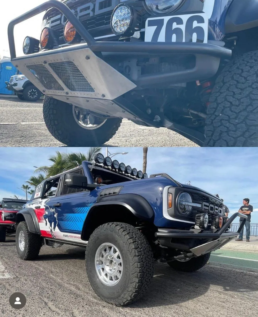

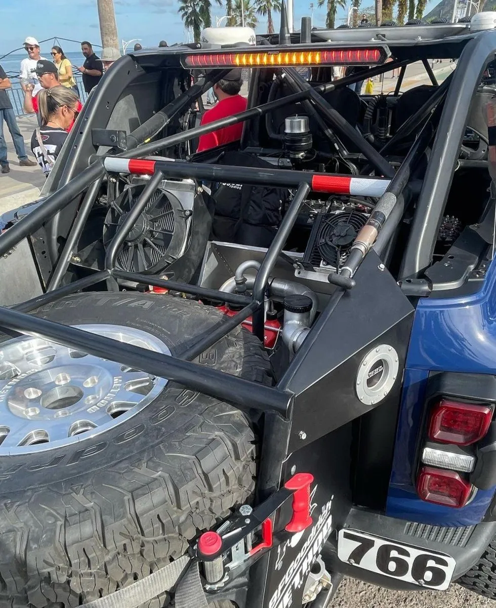

Here are the best pictures I have found so far of the Raptor R and the Bronco Raptor race cars. I'm surprised info and photos are so scarce.

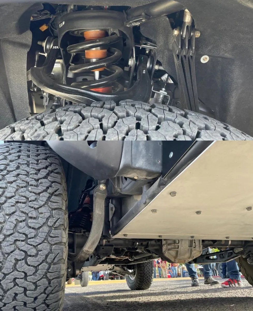

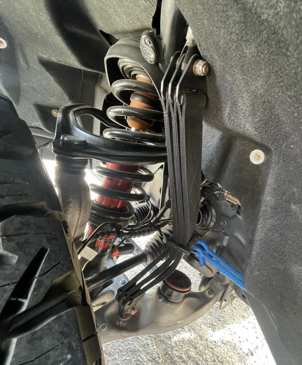

Here you go. Two things to note, the shock bodies are threaded and check out those travel limiting straps.
And no dust boots on the shocks to get bound up

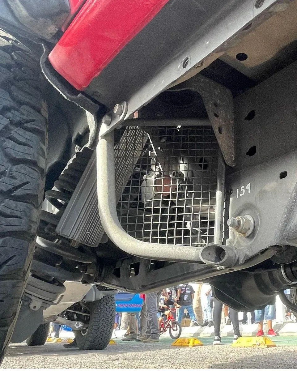

They also installed the wired grille guards for the rear active suspension sensors that I think should also be protected on all Bronco Raptors.

That looks like a fox racing shock remote bypass as well (Resembles the 3.0 fined reservoir)

it Also appears they relocated the shock control module some place else. It should be sitting in front of the cage and above the lower arm link bolt.
