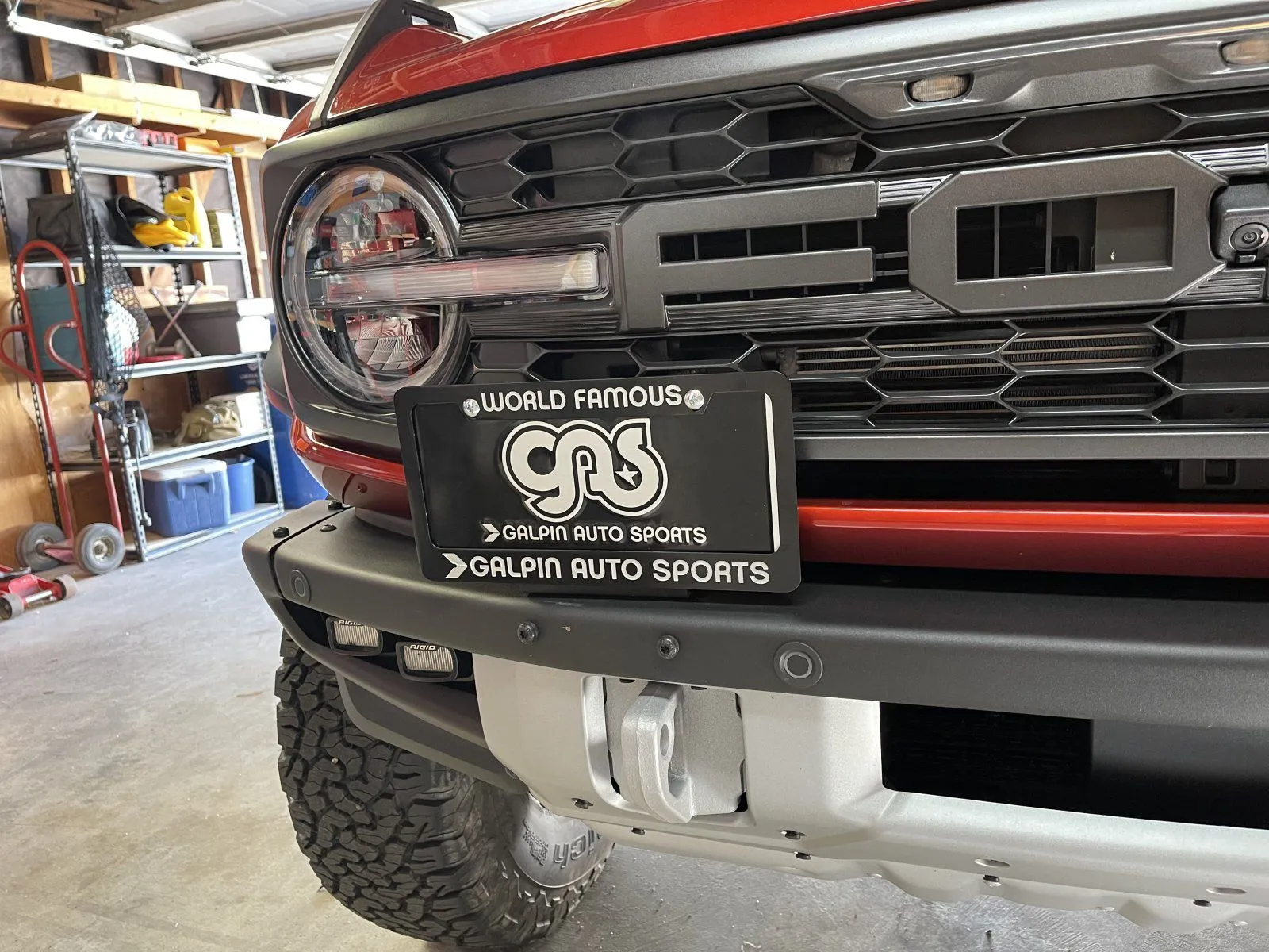

@Cupholders has installed a lower bumper mounted front license plate shown here in his sweet looking photo.

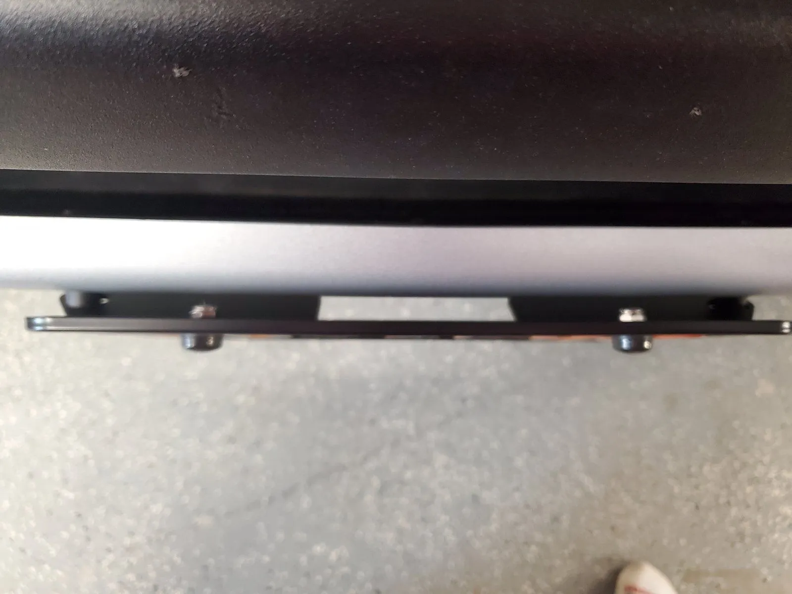

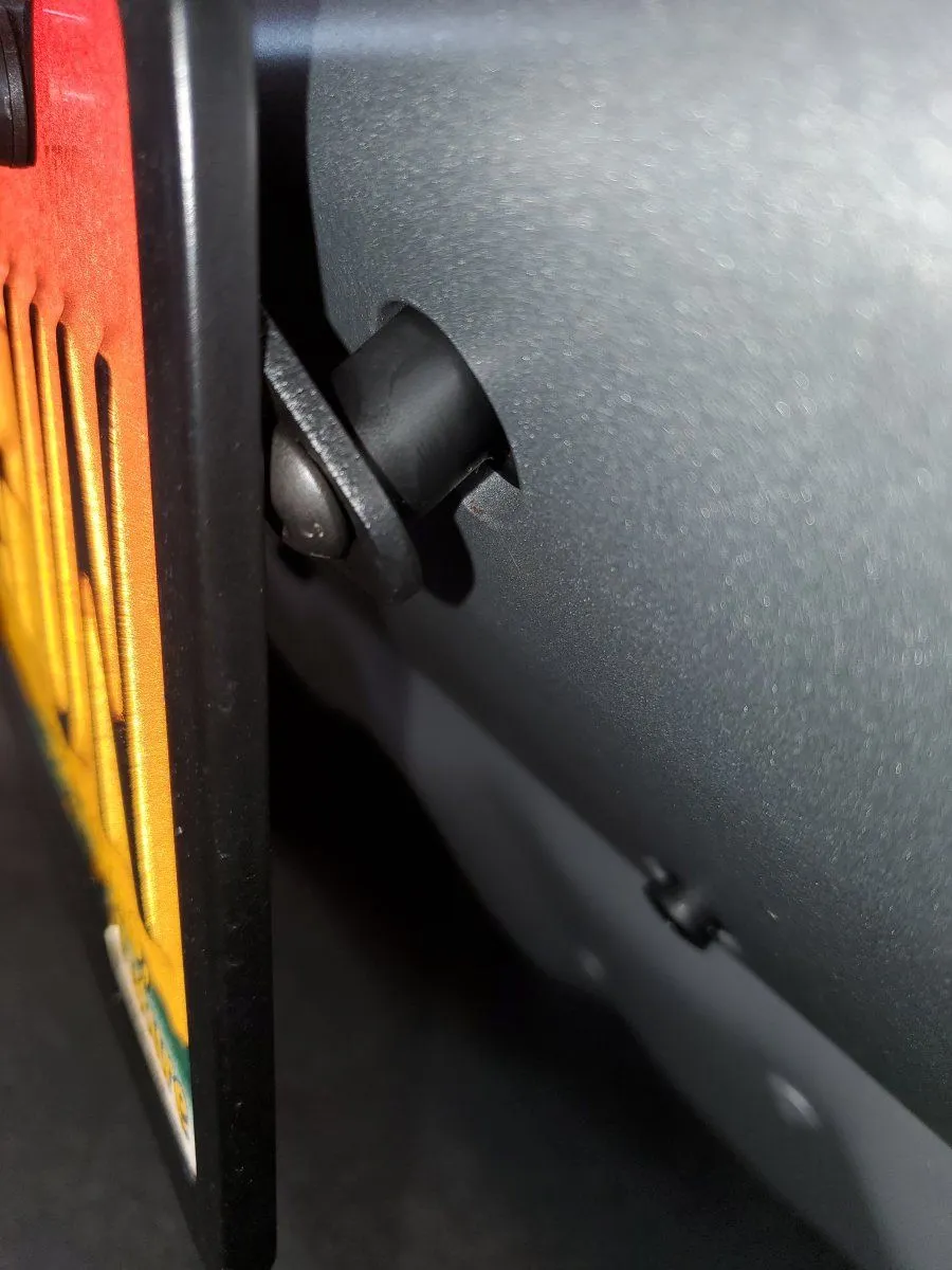

To help any of those that may need to run a front license plate I used the DV8 bracket which clearly states on their website "excludes: Bronco Raptor".
If you don't mind buying the following you can use it without a problem.
https://www.boltdepot.com/Product-Details.aspx?product=13785 Need 2
https://www.boltdepot.com/Product-Details.aspx?product=18972 Need 2
https://www.boltdepot.com/Product-Details.aspx?product=22030 Need 6
When all done it's a very strong bracket!
Hope this might help someone.
(Yes, I need to clean the shop floor haha!)

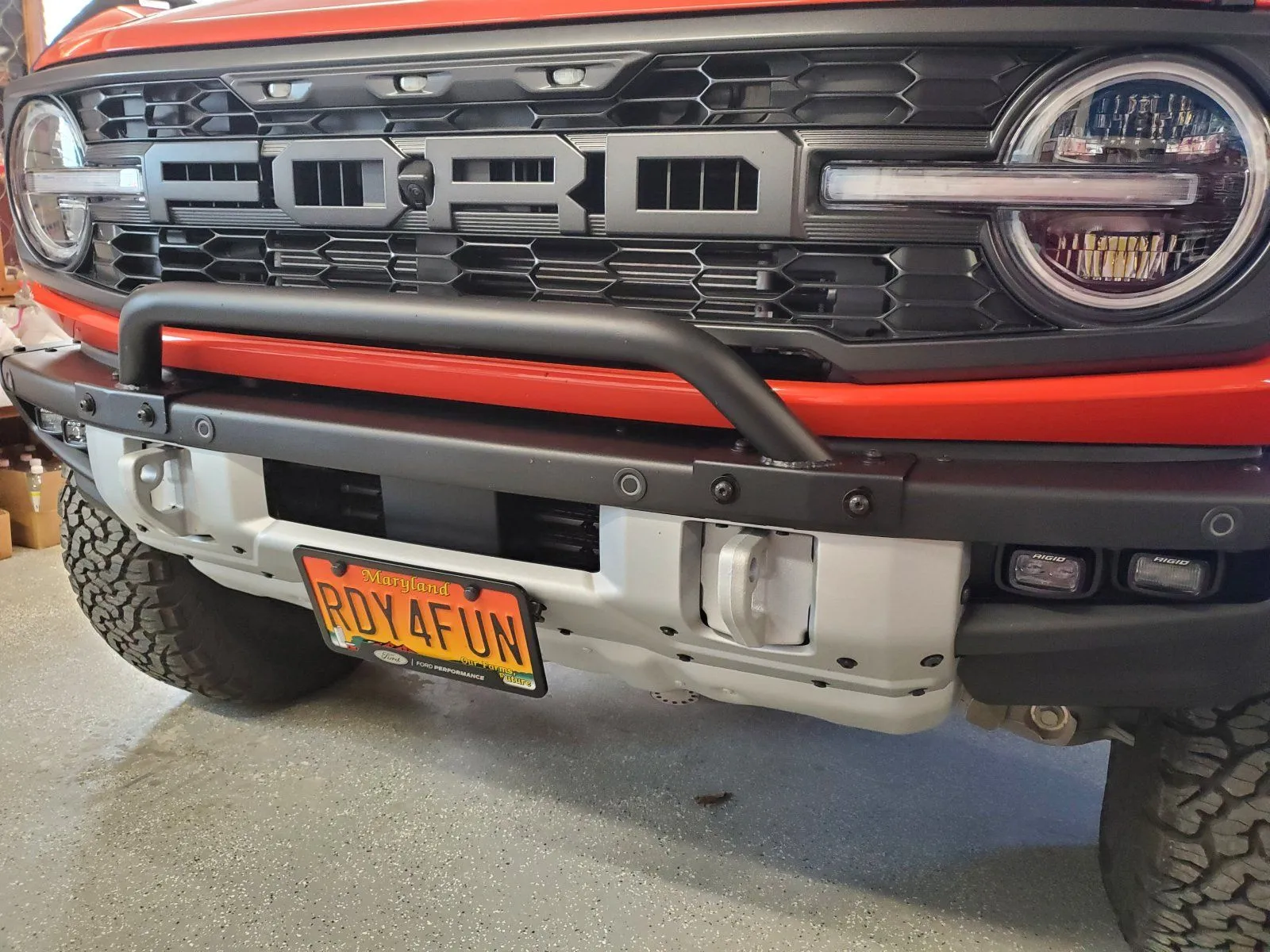

Very Well done! I really like the position with the top edge just below the silver intercooler inlet and the slope!

Why 6 washers?? Thank you!
Looks good. I just said screw it and let the plate line up with the natural slant of the skid plate and didn't slant it forward. I do like the spacer idea though. I have driven by enough police officers and they haven't said anything, but if they do I will definitely be using that idea. Still wish I didn't have to have one up front at all though.
If I remember correctly I used one on each side of the nylon spacer and then one for the attaching bolt per side. I realize the pictures don't show them this way but this is how I ended up in the final version.

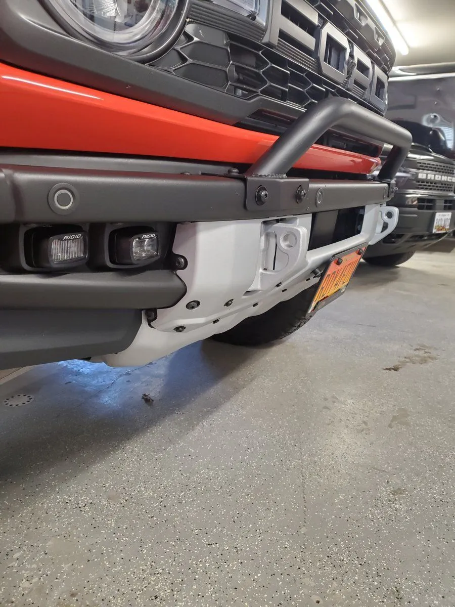

Another vote for the DV8 with similar spacers and longer bolts.
