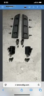

just to confirm a couple of things with you all that have done this.
You will need the two brackets for the top rail and the C-pillar pieces swapped out in order to make the switch to the soft top and that is all, correct?

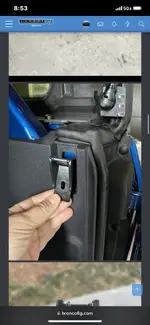

Latches on both sides of the swing gate to lock the rear into place. And the 6 bolts to bolt the top inside the cargo area, along with the plastic covers that are soft top specific to cover the 6 bolts. I actually shaved my covers so that they work for both hard and soft tops.

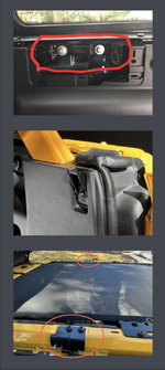

I saw in the guy's video above that there is a bracket (1:45 min mark) behind where the three bolts on the soft top bracket screw into?
Is that bracket already there regardless of soft or hard top from the factory? Or do I need to get that as well? TIA

No it’s not. It’s an alignment bracket that helps the top drop into place

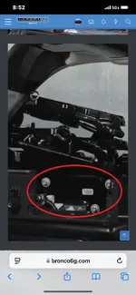

Another question for you. What size are the (3 silver) bolts for the interior mounting brackets?
All from memory as mine are currently installed and difficult to access due to a Tuffy Storage Trunk being installed, I believe they are the same size as all the bolts used for the hardware on the roll bar. Here’s another pic I found of some of the parts you need installed on a Bronco.

ok i was thinking they might be 15mm.
All the others appear to be Torx and bolts that match the Bronco tool kit so I think I should be good.
