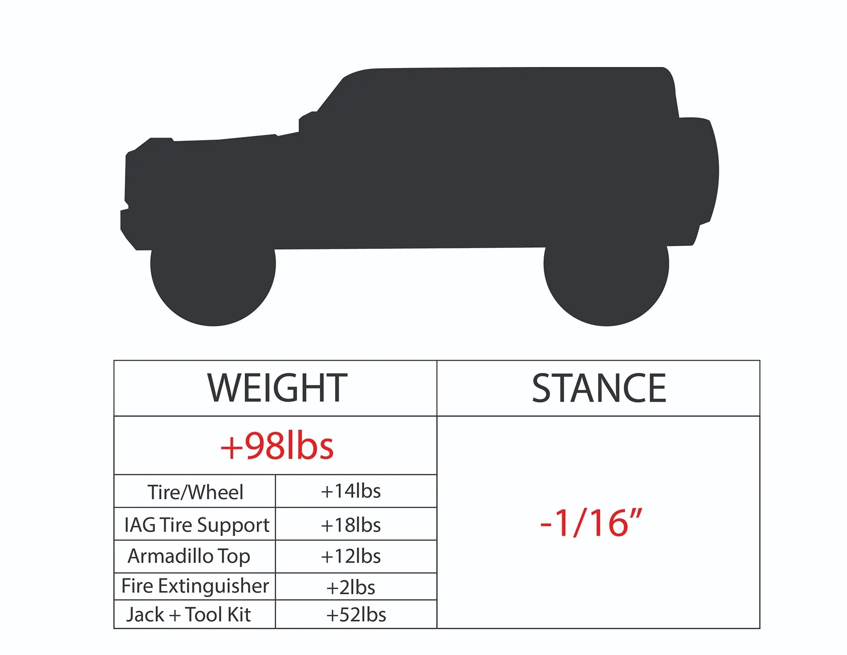

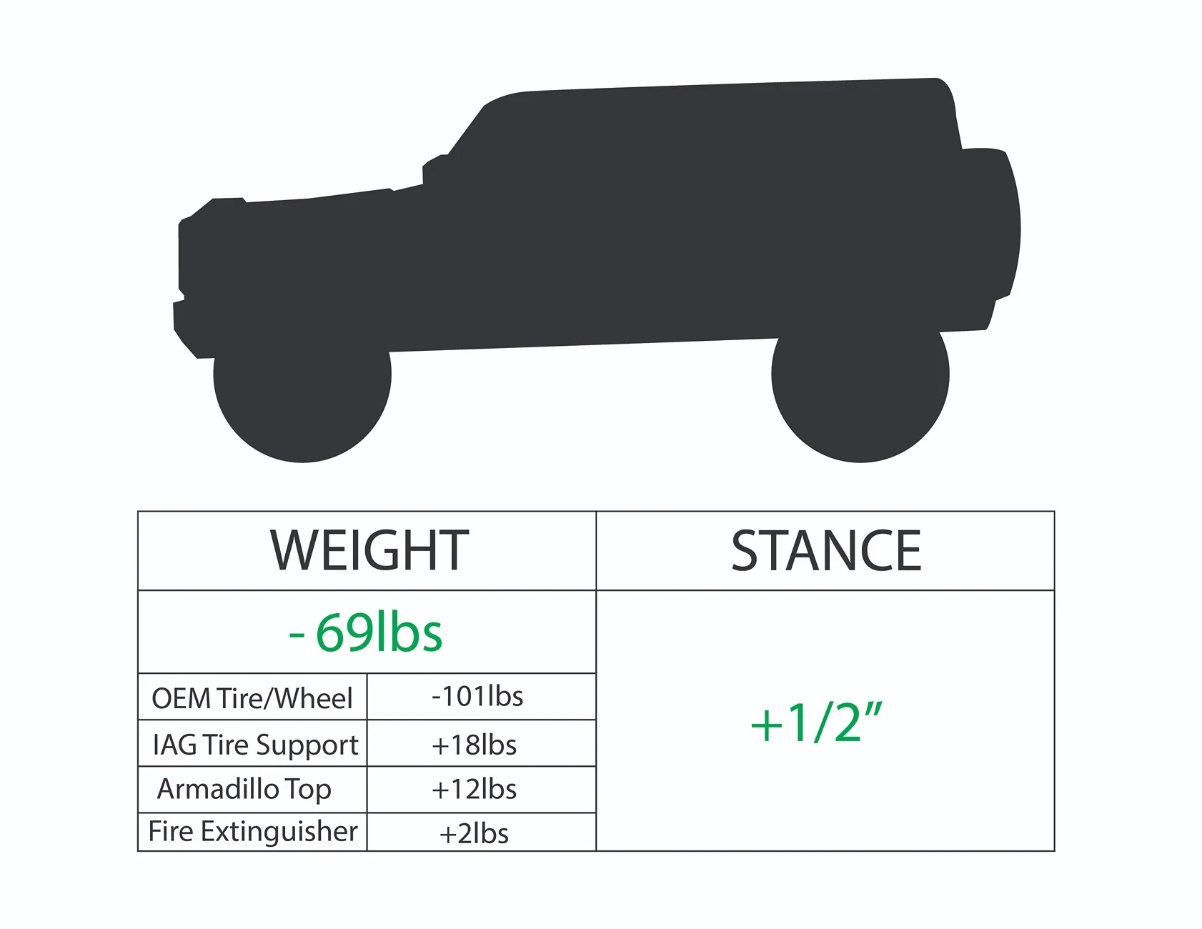

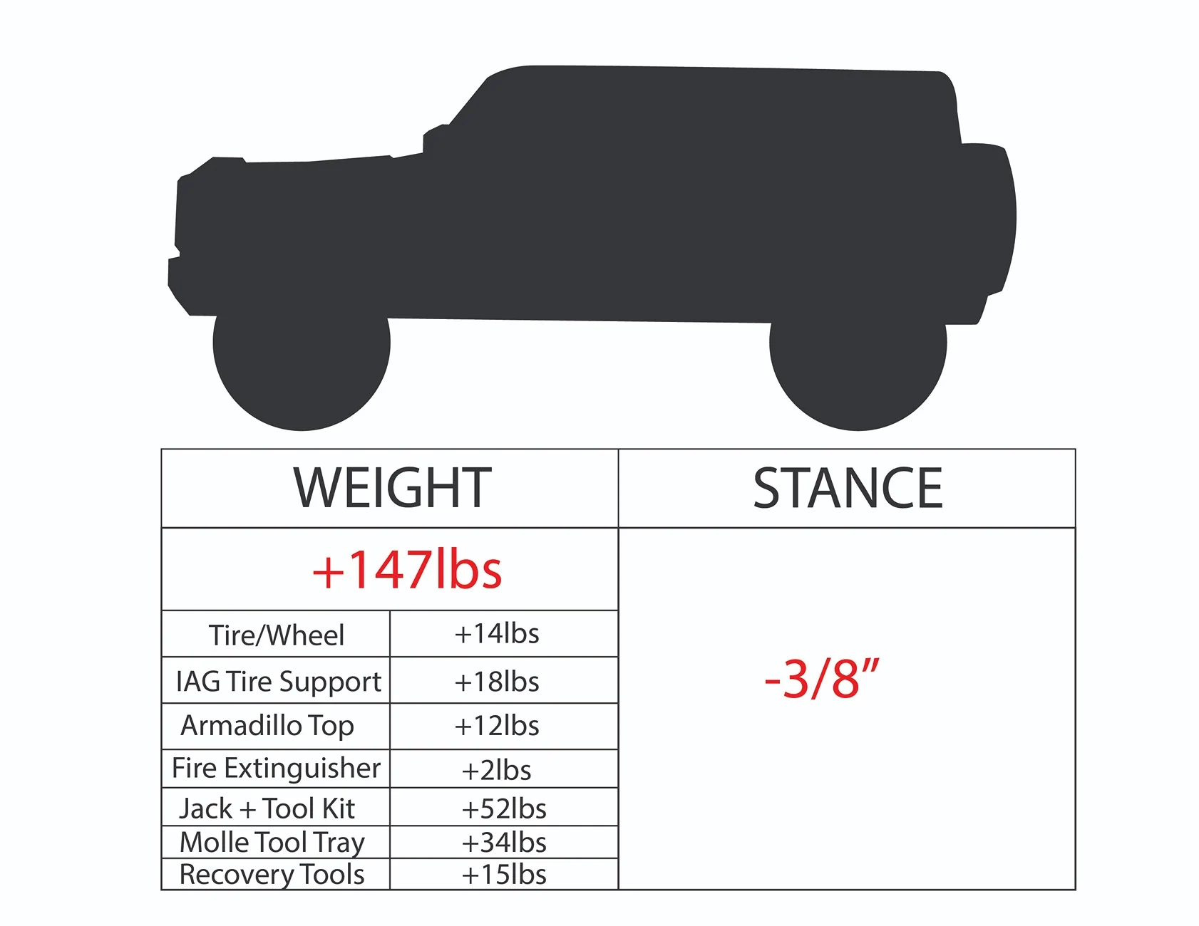

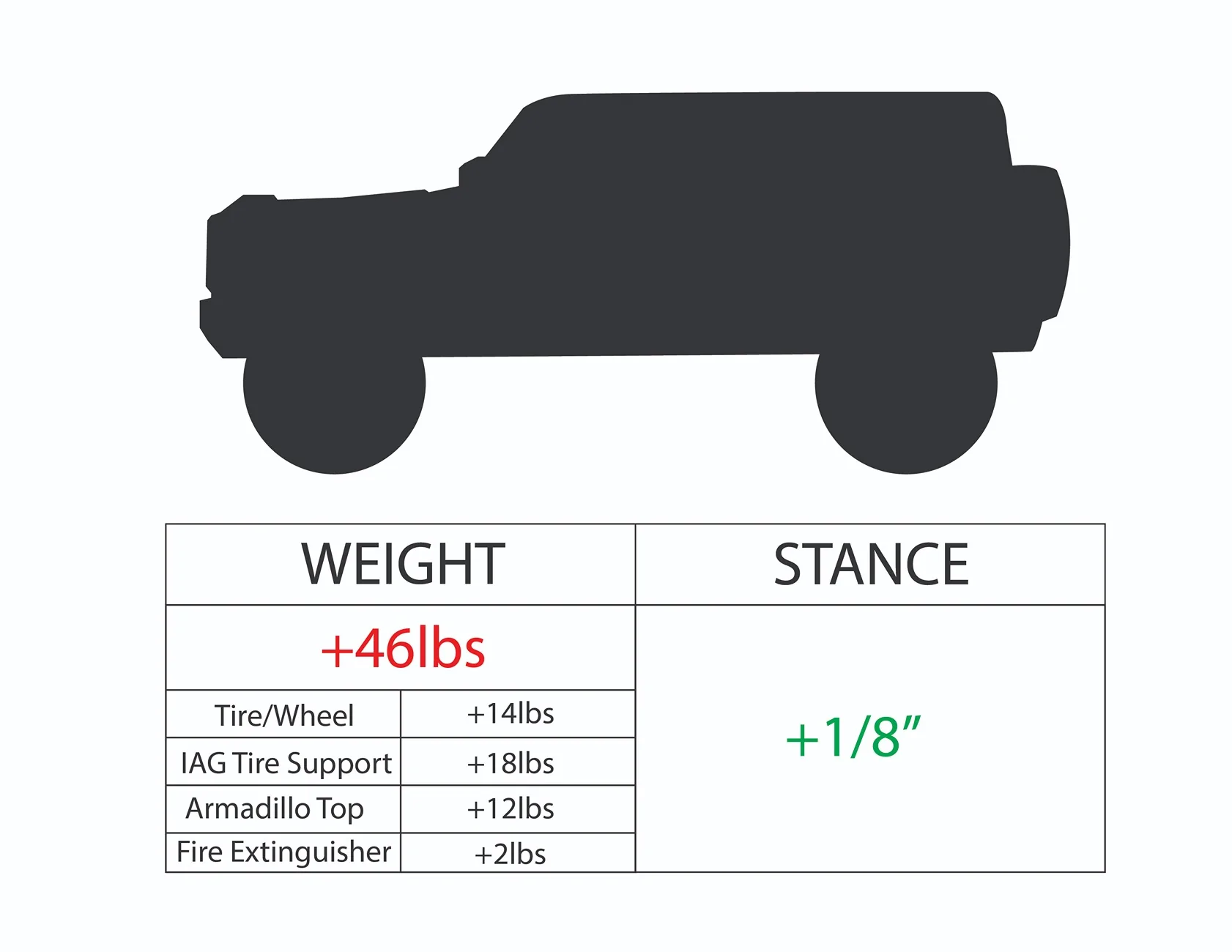

No, I didn't use a laser level. I used a marker and some wood, we're cutting with a butter knife here and not a scalpel. But it gets the point across. The video below is the measuring I did. The graphics are the results. Every 50lbs moves the back end down about .20"
