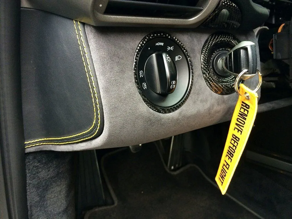

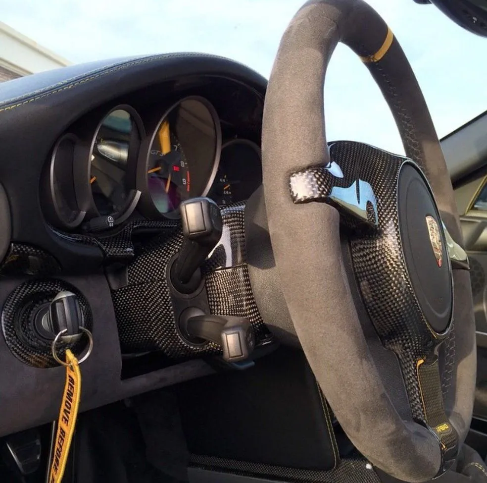

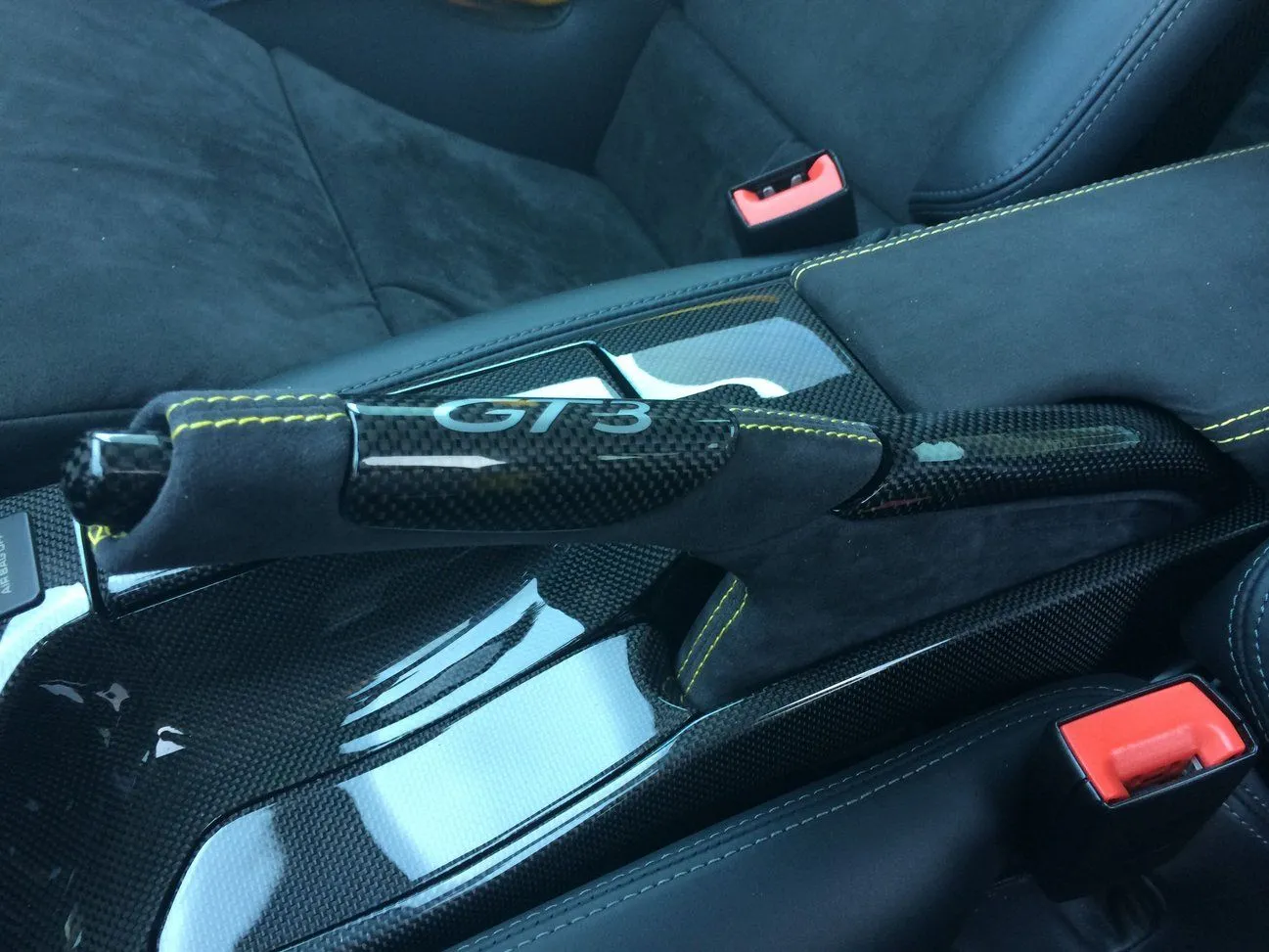

My custom interior
I had Rogelio's Upholstery in Los Angeles do the work. Ask for Roger and tell him Tye sent you.
I'll chime in and say I'm all about the stitching and mgv - dash, doors etc... would love to learn how you sourced that

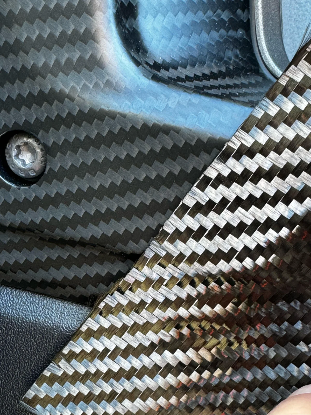

Ford is using a flat pressed carbon weave. These OEM parts are made out of a mould under very high pressure, which made the weave structure flat and lost the typical deep carbon view. Most aftermarket companies who work with Carbon Fiber do not have this kind of tooling and are not using molds, they are hand laying which is why the 3D structure effect is retained.
With that said, the closest match you can get to this is Hexcel HexForce Carbon Fiber Fabric 2×2 Twill 3k 5.8oz/197gsm Style 284. I had DB Carbon in Germany do the work and sent them a dash and the weave.
