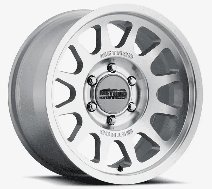

OK, after more research, I may go with Method's Bead Grip 703s (0mm offset) and Nitto Ridge Grapplers (37X12.5R17LT). The Nitto Terra Grappler G3s look good, but aren't available in a size for the Bronco Raptor.
Good choice on wheels, however I would recommend looking at their +25mm offset, less stress on front end components and steering system, better on road driving dynamics, and much less likely to knock of a fender flair upon full compression. Method produces that wheel in a +25 in the black & bronze finish, but not in the machined aluminum. I would contact Method asking if it's a misprint, or if possible to order. The machined finish is one of my favorites, would look great on your VB.
Thank you. I just read that the stock wheels are something like +14mm offset and I was wondering if 0mm offset would be a problem. This confirmed it. I certainly don't want my tires to poke out more.
But as you mentioned, I am only looking for machined silver or white wheels. I reached out to my dealer to see what I they can get, but haven't heard back in a couple of days. I will do it some more research and potentially reach out to Method next week.

Like you found, I can only find black or bronze in + offsets from Method in Bead Grip.
These (https://www.methodracewheels.com/co...roducts/707-bahia-blue?variant=39783959363645) blue wheels are nice too, but only come in 0mm offset.
It seems like there is a real shortage of Bead Grip or Icon Rebound Pro, etc wheels in anything but Bronze/Black/Grey.
I guess that I should just start looking at Beadlock wheels again.
