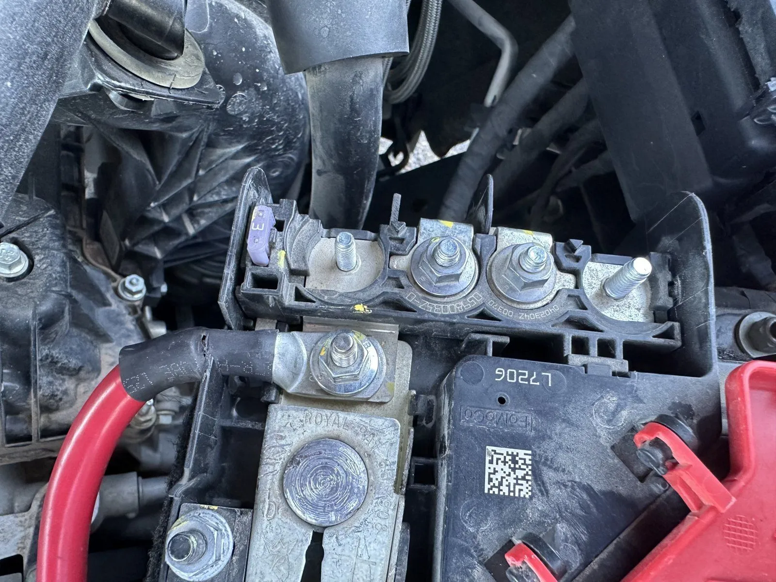

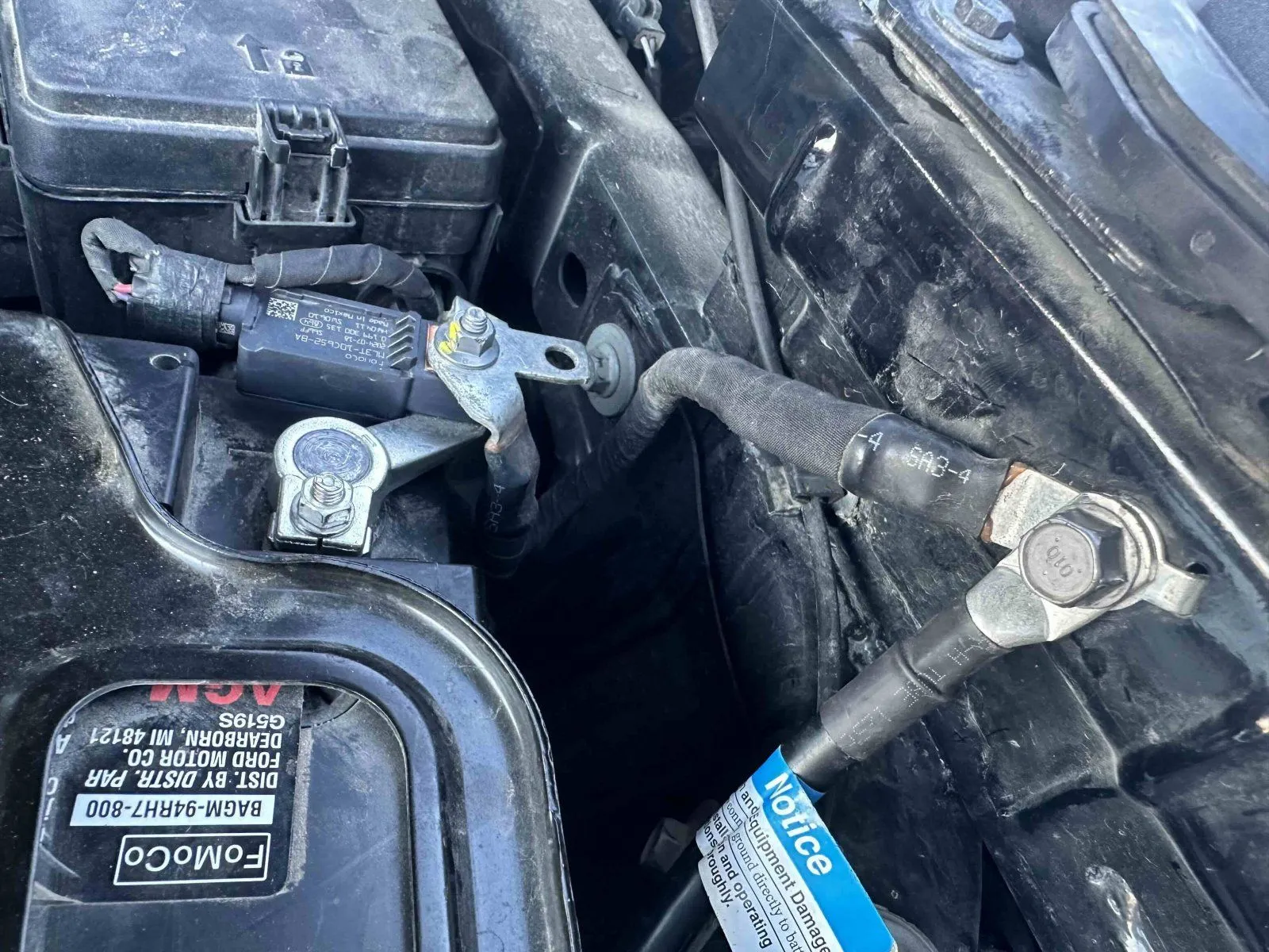

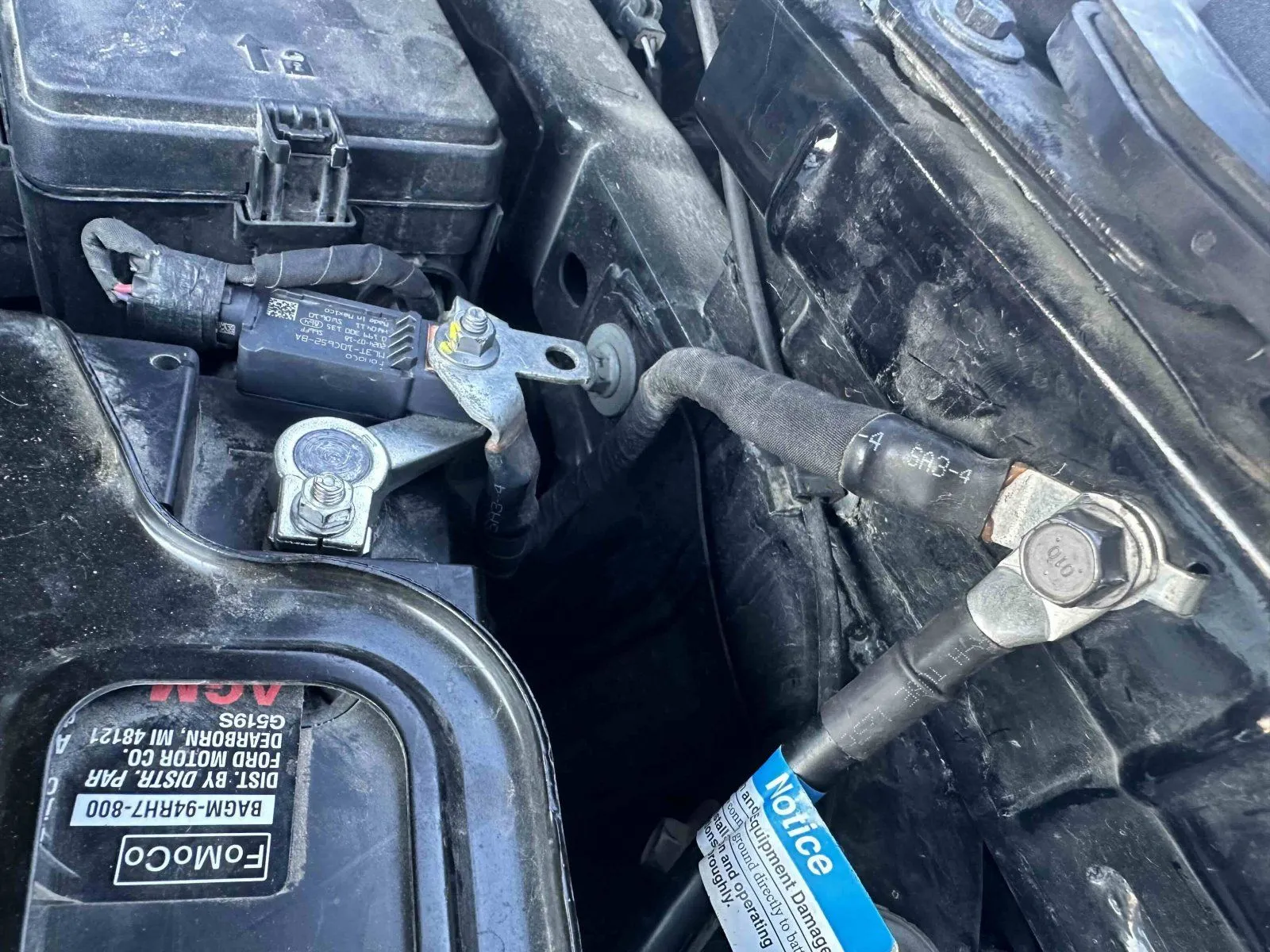

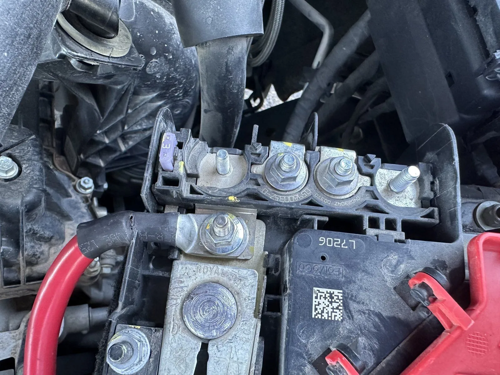

Well this is the skinny.
It seems the way I hooked up the winch started all the issues.
Pic 1 showing the negative now grounded to vehicle. Before I had it to the nut on the negative with that small black thing. Since the positive was attached in a similar fashion we went with this connector. That small black thing is a sensor of some kind for the alternator and something else. Nothing should be put on it. My wiring to it probably didn't do anything.
2nd pic shows how winch should be hooked up directly to the battery. I had it on on of the four bolts in picture. I thought seeing the Bronco is accessory ready, they made it easy to attach accessories. We had to cut the plastic to get the positive connected there. Usually the plastic is to the top and you can't attach anything like this wire to it. Cut down say and inch. Seeing you couldn't easily attach there made the four bolts even more viable.
3rd pic shows the extra attachment points to the positive. When you take that off there is a three hundred amp fuse on there. And on top off that there is a tiny 3 amp fuse. They don't know what that is or that there was a three hundred amp fuse underneath.
The battery can take 800 amps. My winch totally can draw 440 amps. They would have probably hooked up to that location as well because it seems easy. Warns instructions which they sent the dealer and I had give you warnings about the wiring. Where to run it and such but nothing about putting the leads directly to the battery posts. The instructions are pretty poor. Warn told them go direct. So it seems if the alternator kicked in while I was stretching the winch line it blew that hidden fuse and thus all the issues. It seems the alternator was not the issue.
I watched the voltage on the two hour drive home. It went to 12v and then the alternator kicked on and then 13v and sometimes 14v and repeated the cycle.

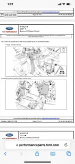

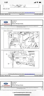

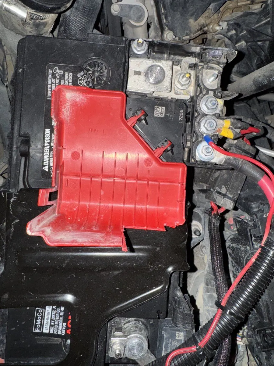

Really makes no sense. I installed the factory winch and attached are Fords Wiring instructions. And the wires are preterminated at those connection points. There is no extra wire to run to any other location.
Interesting. I wired it to the third connector to the right. There is an empty spot where you put it. Then two bolts with wires attached, then an empty spot. I wired it to the second bolt seeing we didn't have a bolt so we put it on top of the existing wire.
Also it would be interesting to know the draw of your winch. From memory I believe there are 300 amp fuses to each of those four connectors. From memory the fuse that blew was the one I connected to.
Yeah, I had to pay for the new part, the "the four connector " with the fuses on the back side we attached to and three hours labor.
If standing at the drivers headlight, looking down at the battery, I connected to the far right terminal. The Factory Winch came with the hardware to screw into that open slot. I also grounded it on the open terminal just prior to the sensor going into the battery in accordance with Fords instructions. Again, Ford provided hardware for that connection as well.
Based on where you are standing looking down on the battery. I put it on the 2nd terminal from the left on top of another wire since we didn't have a bolt to fit.

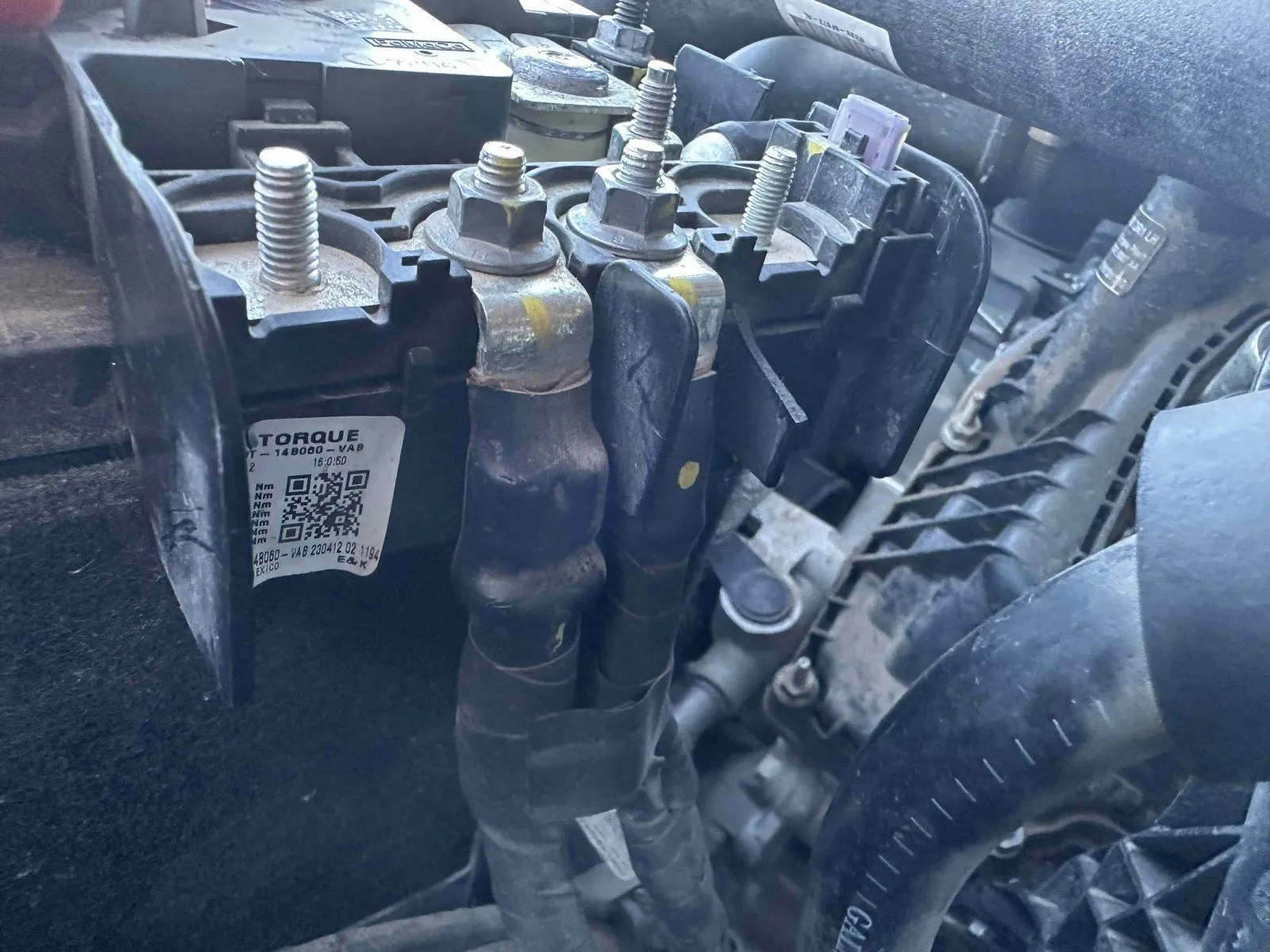

I wired my Warn 12S on far right of that bus. I probably have 30-40 pulls including tensioning, logs, boulders, myself on too many occasions, many other Broncos, a few Subies, trucks, etc…… no problems….so far.
I wired my Warn 12S on far right of that bus. I probably have 30-40 pulls including tensioning, logs, boulders, myself on too many occasions, many other Broncos, a few Subies, trucks, etc…… no problems….so far. View attachment 14601
If it created all these problems it seems because I wired it over the other wires already on there. Strange how I blew that fuse. I saw the blown fuse. Or it was something else. Maybe the only fuses were on the two centre bolts and not the two outside. I should call them and ask, if they still have the part. I remember seeing the blown fuse and there was definitely another fuse beside it but not sure if there were fuses on the two end bolts.
My wiring also connected to the OEM winch wiring suggest point. the installation is on Oct last year, up to date I dont see any issues.
