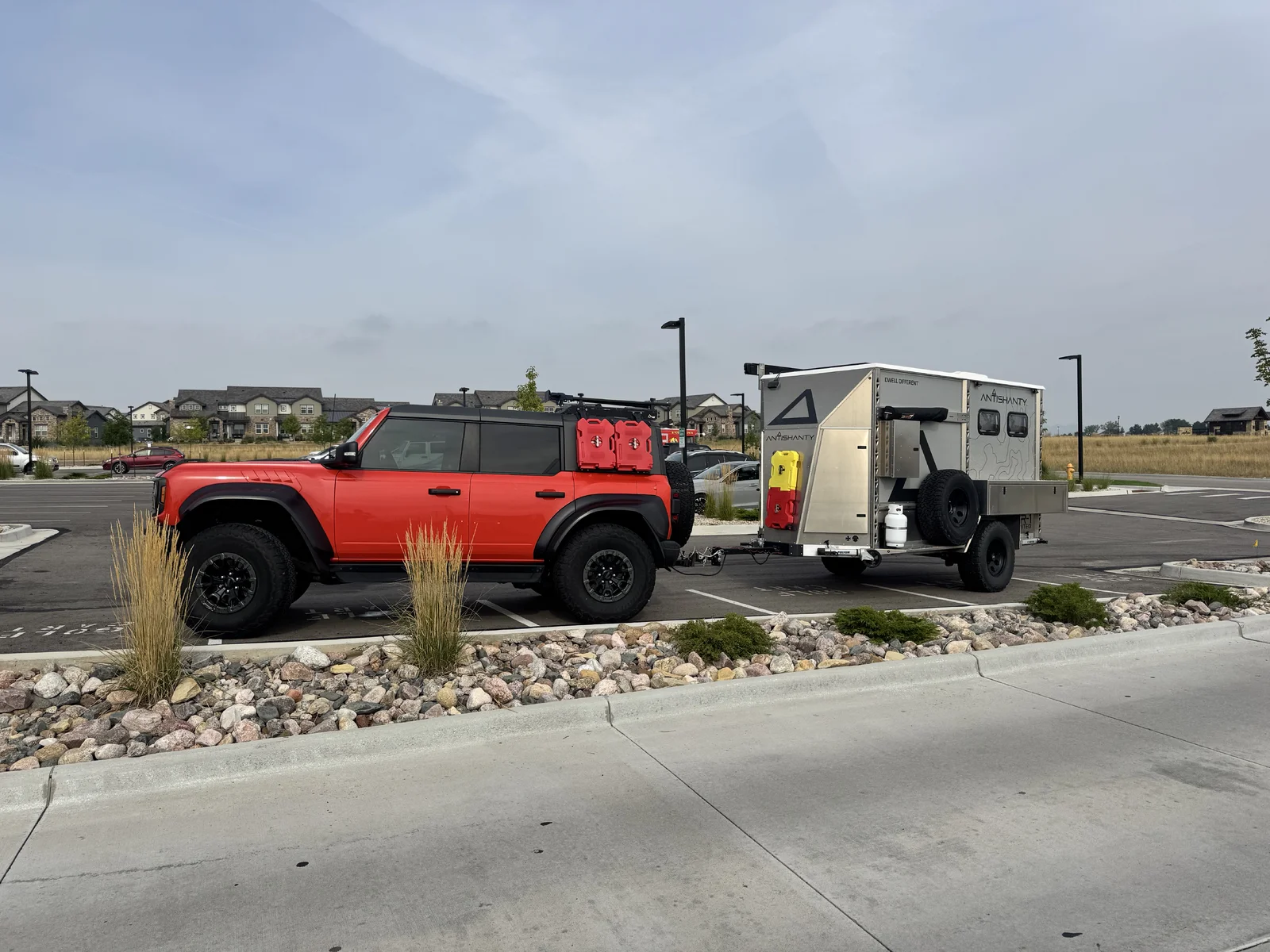

So how is the pulling with the e-click installed? I got an Antishanty RR-1 (very sweet trailer) but the sag is pretty extreme even though all the weight specs are within range. This pic was when I picked it up -empty and with only one 5kw battery in the front garage, but with 40 gal of full Jerry cans at the back. Now have added another 5kw EcoFlow battery and a few minor (maybe 40 lbs) things forward of the axle - with most weight adds over the axle or aft of it. Looking for a solution to stiffen up while towing without significantly killing the off-road wheeling performance. Eventually plan to match the wheels to the Braptor’s to eliminate a spare from one of the vehicles. Any updated help or experience?

I spoke with Hammer Built. We discussed the possibility of the coils being overwhelmed on the Raptor while towing. Sure the e Click would stiffen up the suspension but it would not overcome the coil being overloaded. That being said being able to stiffen up the suspension should help regardless.

I wonder if using a smaller tire/wheels on your trailer help a lot because it would lower the trailer (especially the tongue) and therefore allow a drop hitch on the back of your Braptor which should allow the trailer to be connected a lot closer (because the spare tire is no longer blocking your hitch point) and therefore significantly reducing tongue weight?
Maybe, but then you lose clearance, and some of the trails I overland on are pretty rocky. As I said, I am hoping someone builds an airbag system for the Bronco. I am actually looking at fabricating one using a lightweight universal setup. The airbags don't have to do much at all.
Understood. I'm patiently waiting for someone to develop a airbag setup as well because although mine is only about an inch of droop, id prefer none.
