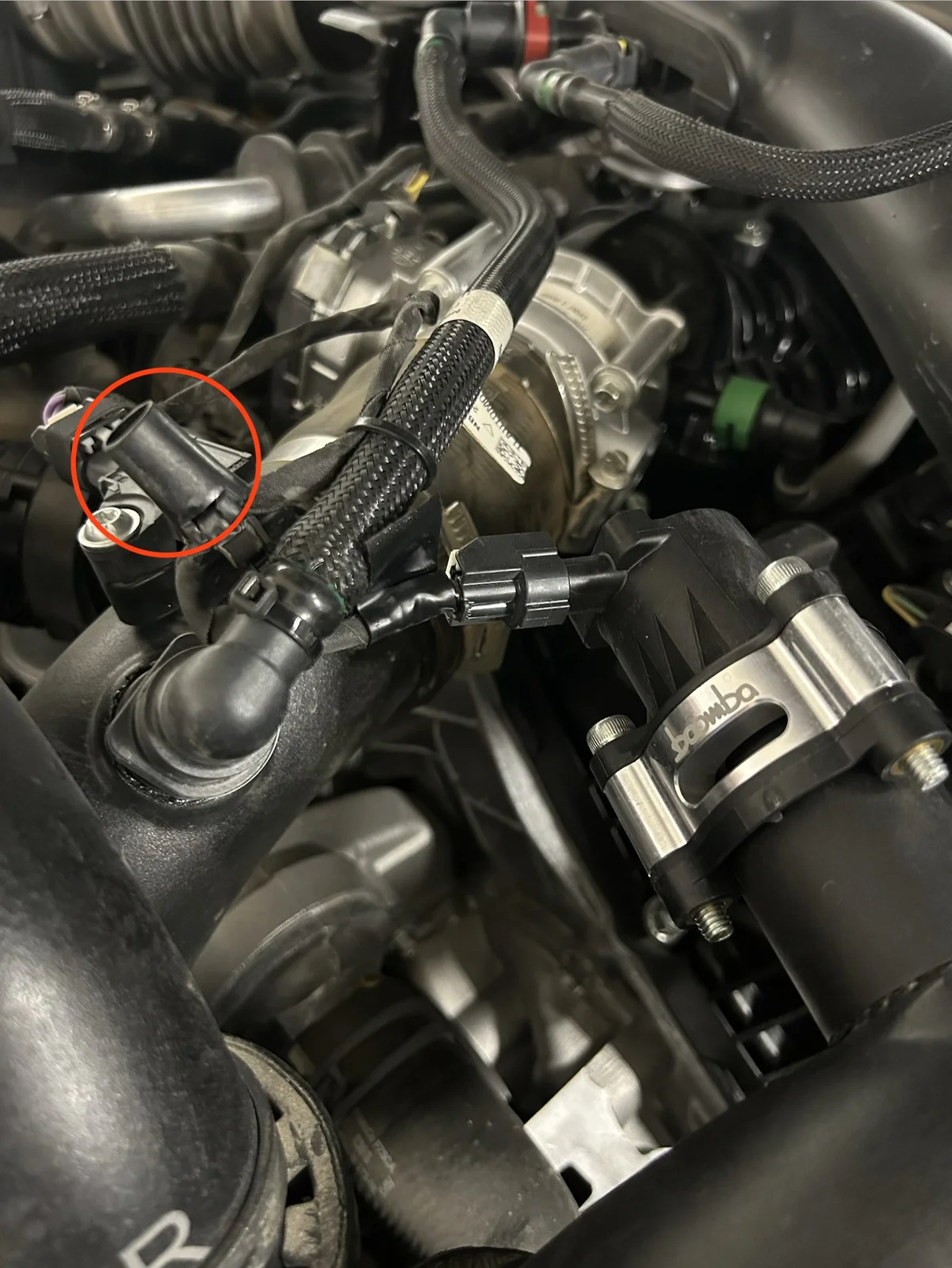

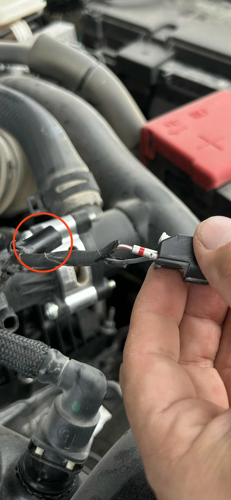

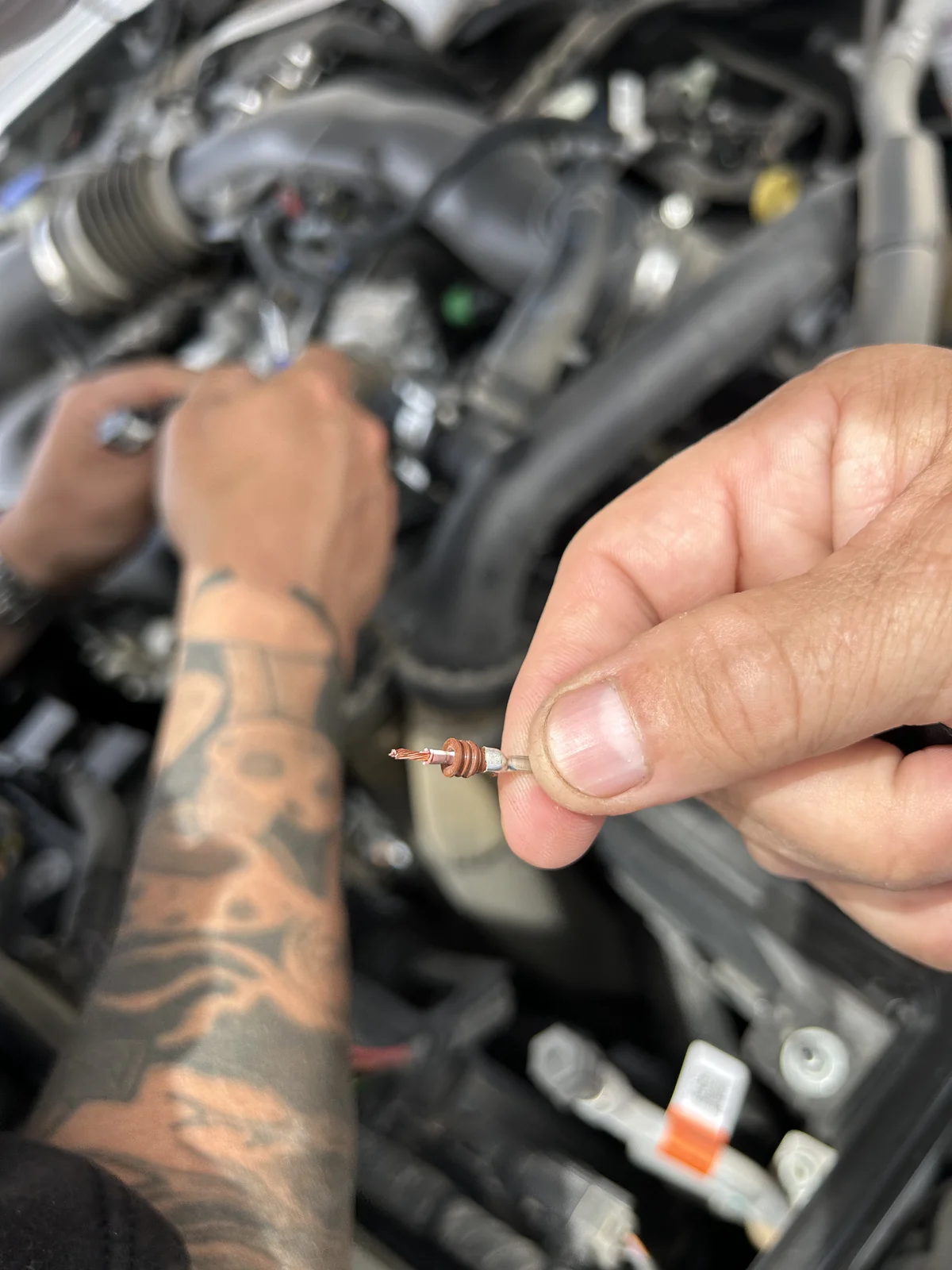

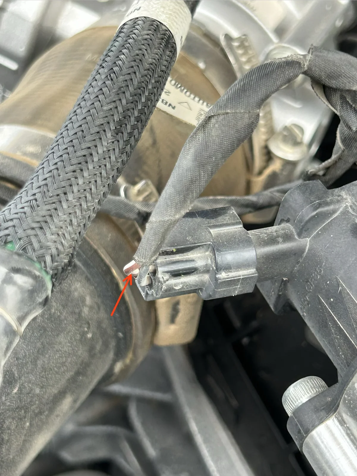

Just an fyi. While off roading last week I got a check engine light. Bronco ran fine, but the light never turned off. On the way home , I stopped by a local Vatozone and got it scanned. Blow off valve fault. Opened the hood and looked at the plug and all looked normal. Looked a little deeper and noticed one wire was severed right where it goes into the connector. The parking lot fix was to buy those tiny connector crimps, pull the pin, strip the wire(barely had any) and crimp the wires. Then put the pin back into the connector and plug it in. All is good again. I do have a Boomba spacer, as I like the whoosh sound. When I installed that, the oem connector wire support (circled in red) is not used anymore. I failed to zip tie those tiny wires to something for support and over time, the wire, due to vibrations, broke. Now it is zip tied properly. Just a little information, if needed.
