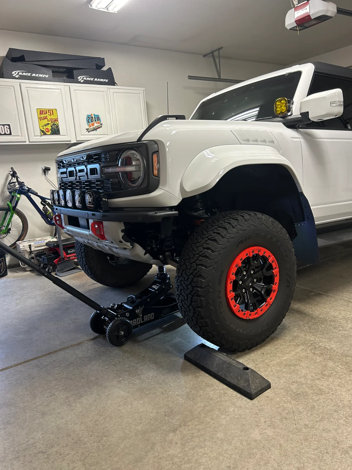

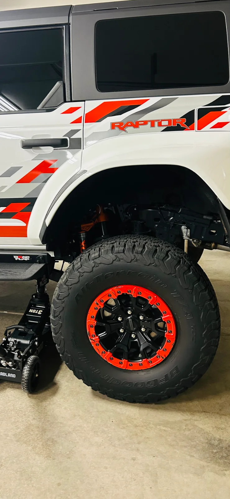

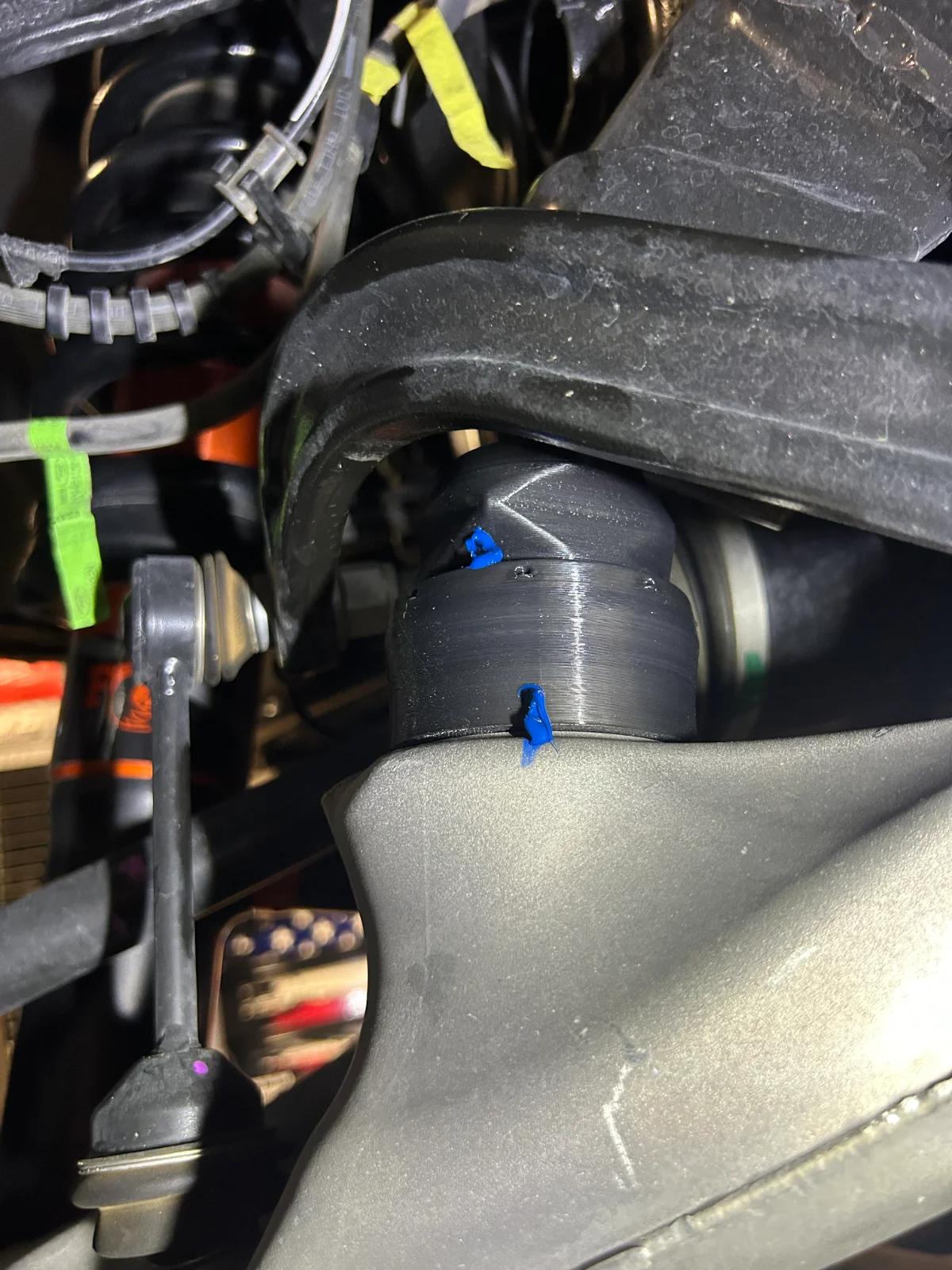

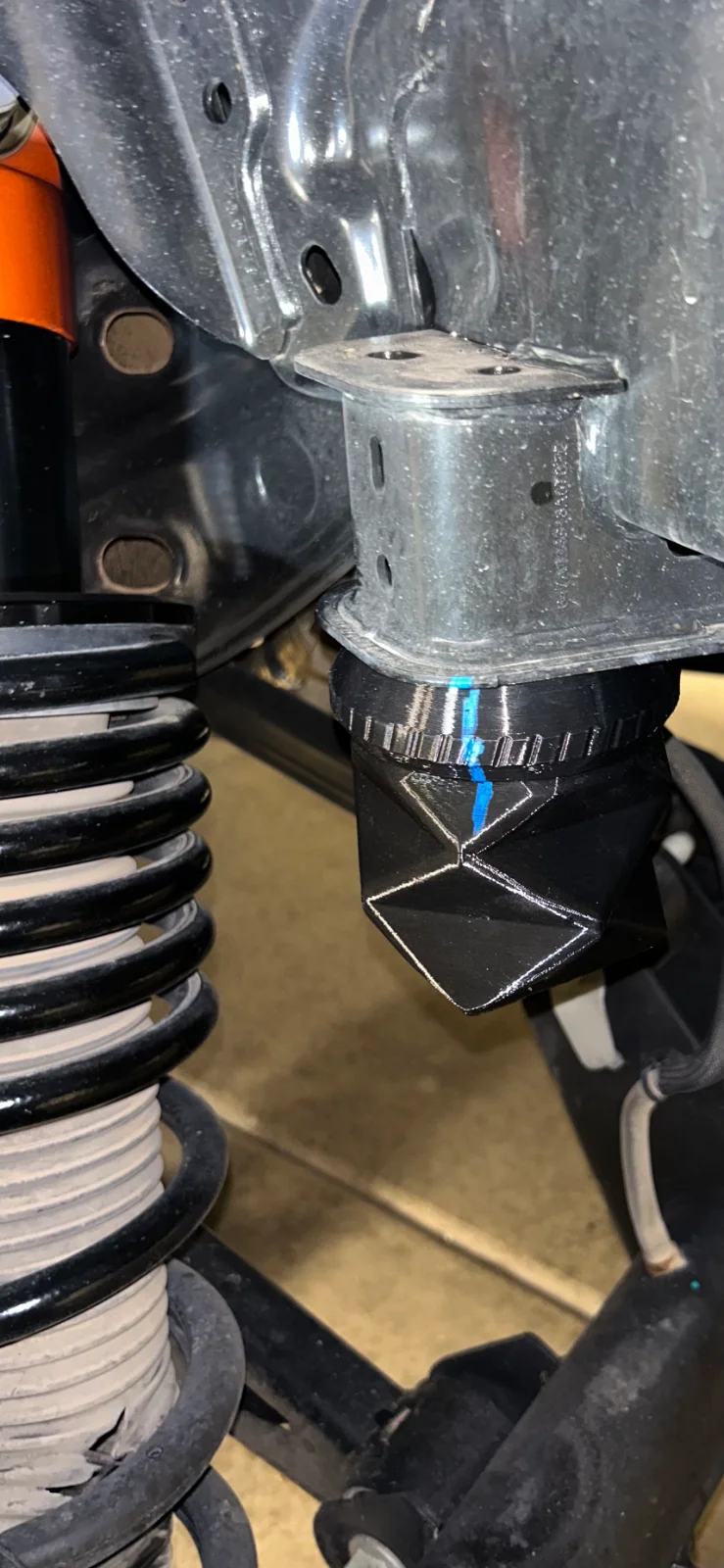

Purchased and installed the 3D printed bumps front and rear. I am familiar with aftermarket bumps like these, so I figured I give them a try since I didn’t want true hydro bumps. These are a lot more cost effective and hopefully more noticeable bump resistance than oem. They have been designed to have 5 times more. Install is simple and should take anyone less than an hour, taking your time. They appear to be of quality material and well made.
Fronts take a 15mm socket and rears a 14mm socket. My Milwaukee ratchet made quick work for removal. I used a torque stripe/paint pen to periodically check to see if they come loose, as they are a spin on mounting system.
