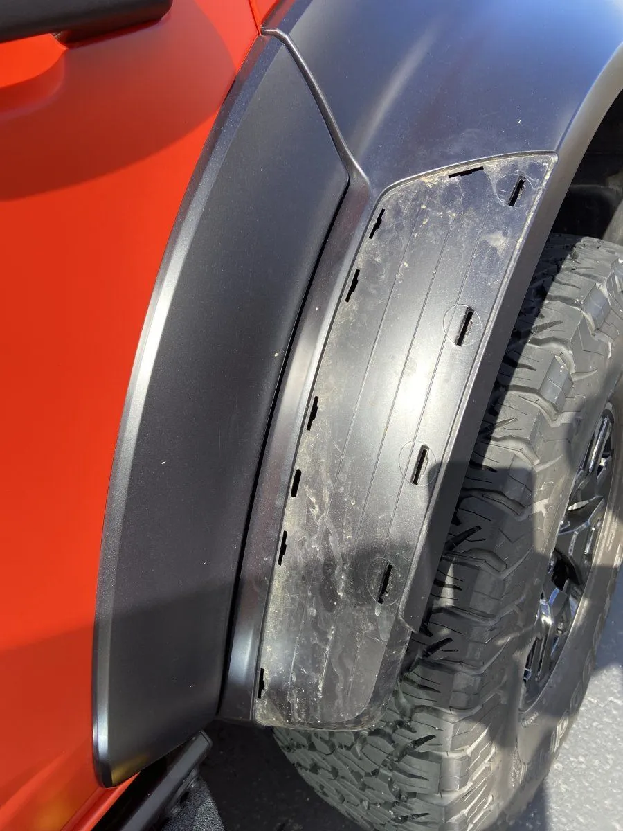

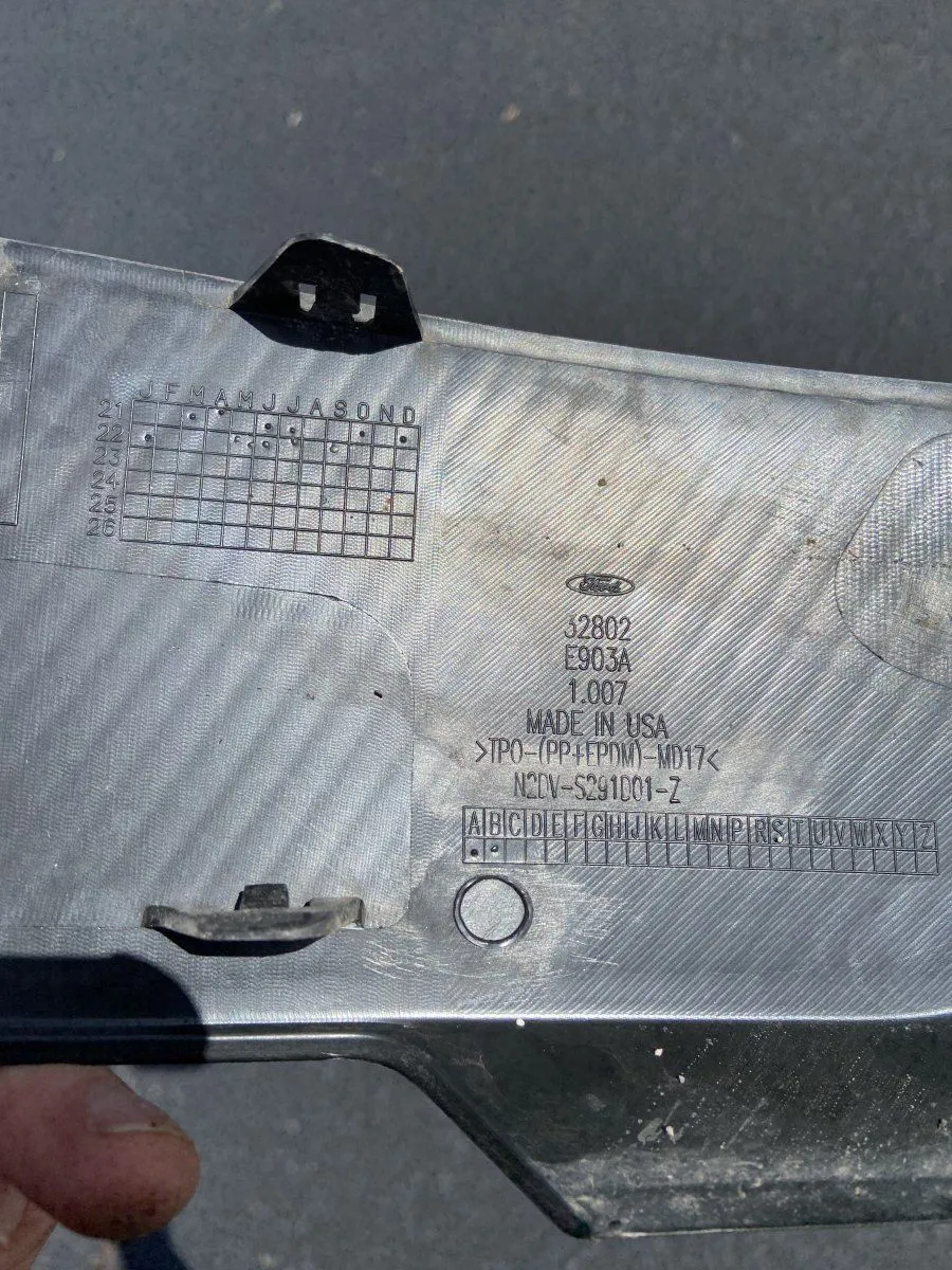

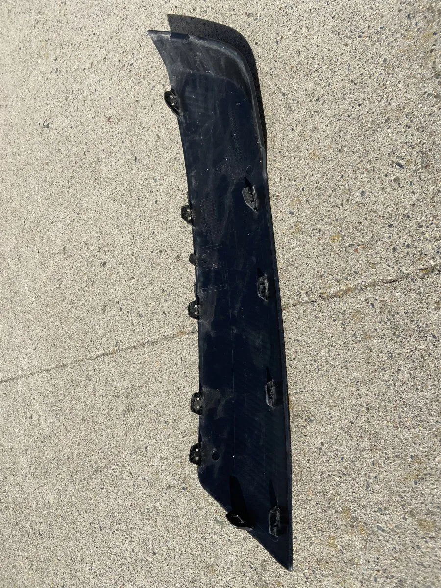

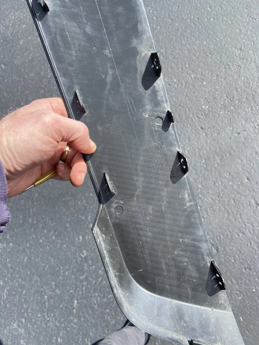

Don’t think I’ve seen a thread on this yet. I got a wild hair and pulled the accessory ready panel off to help answer a question on 6g. I always like to see pictures under what I’m trying to remove first, so hopefully others may appreciate the post.
I pulled firmly on upper outside edge to get first clip going then worked my way down around inside edge as these clips are easier to access. The clips are molded as part of the panel. the panel clips popped out pretty easy except the last one on the outside edge. The plastic on these panels is pretty soft and pliable, co the clip got a little twisted in removal process. I was able slip a short small screwdriver under the panel to release the clip. Try not to twist the panel as it gets loose, that might avoid that issue.
popped back on easily and looks good as new.

View attachment 6625View attachment 6626View attachment 6627View attachment 6628View attachment 6629
