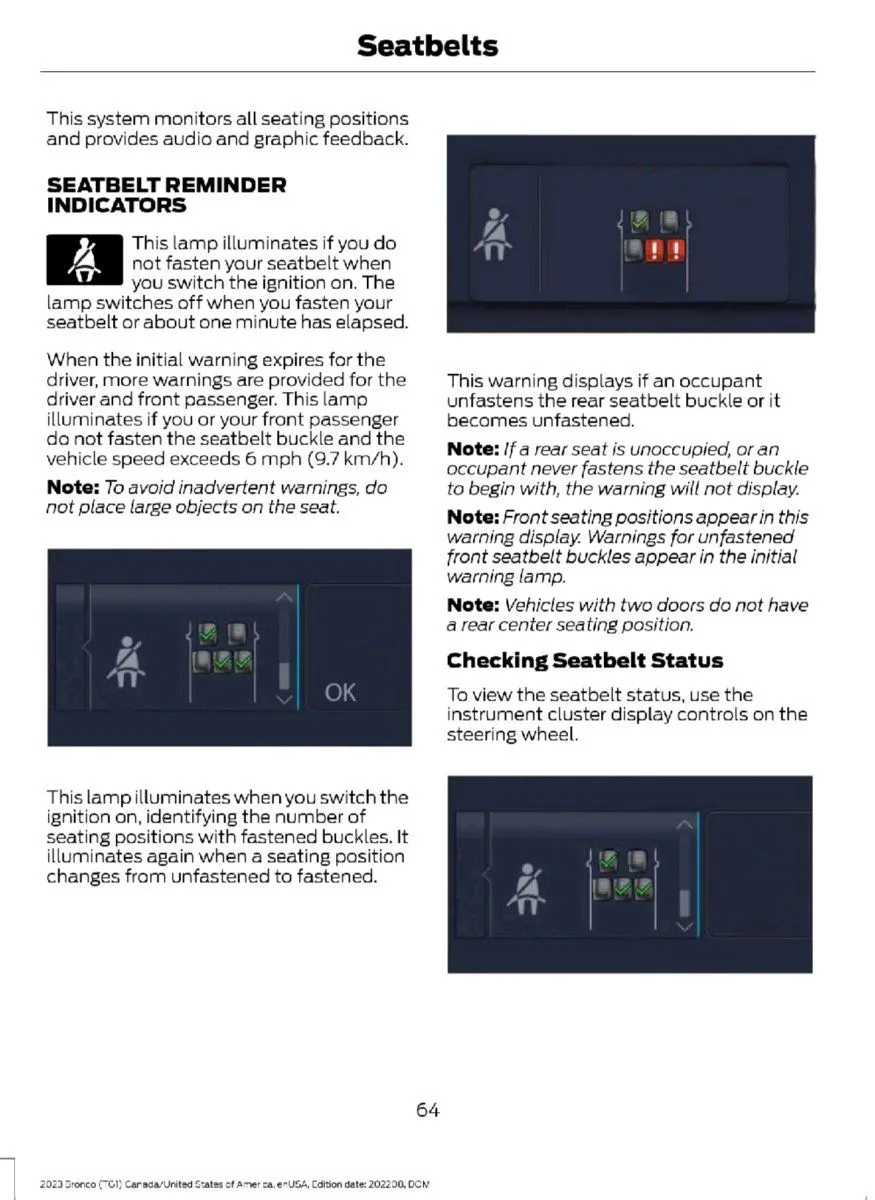

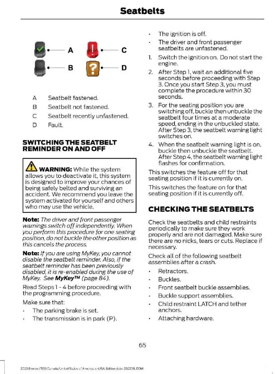

This is the only only other thing I know to try. This is taken directly from your 2023 FORD BRONCO Owner's Manual. The second photo gives you instructions on disabling belt warnings.
View attachment 10424View attachment 10425
So this is what I did in mine, but if I remember correctly it just makes it so the chime doesn’t go off if someone takes off the seatbelt, which it did do in my car. But it won’t stop that screen from coming up.
