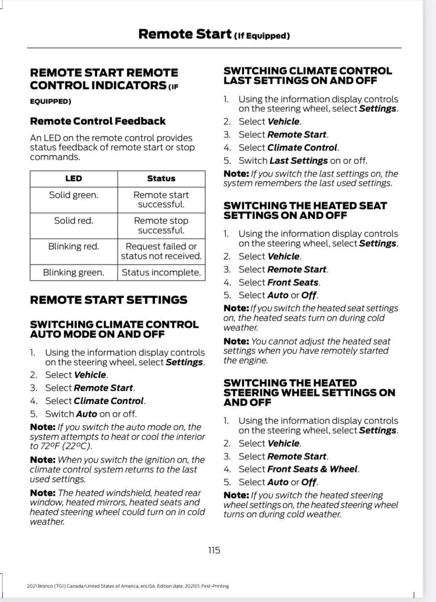

The remote start can adjust to the outside temperature (hot out, cool inside & vice versa). It is a cool feature, no pun intended. 😆 Hopefully this helps as it is “hidden” in the menus…

Appreciate this as well - I've tried the "auto" settings as well as the "last settings" for climate control, but regardless it doesn't trigger the heated seats, steering wheel nor window defrost... so must be a sensor or similar. TBD!
