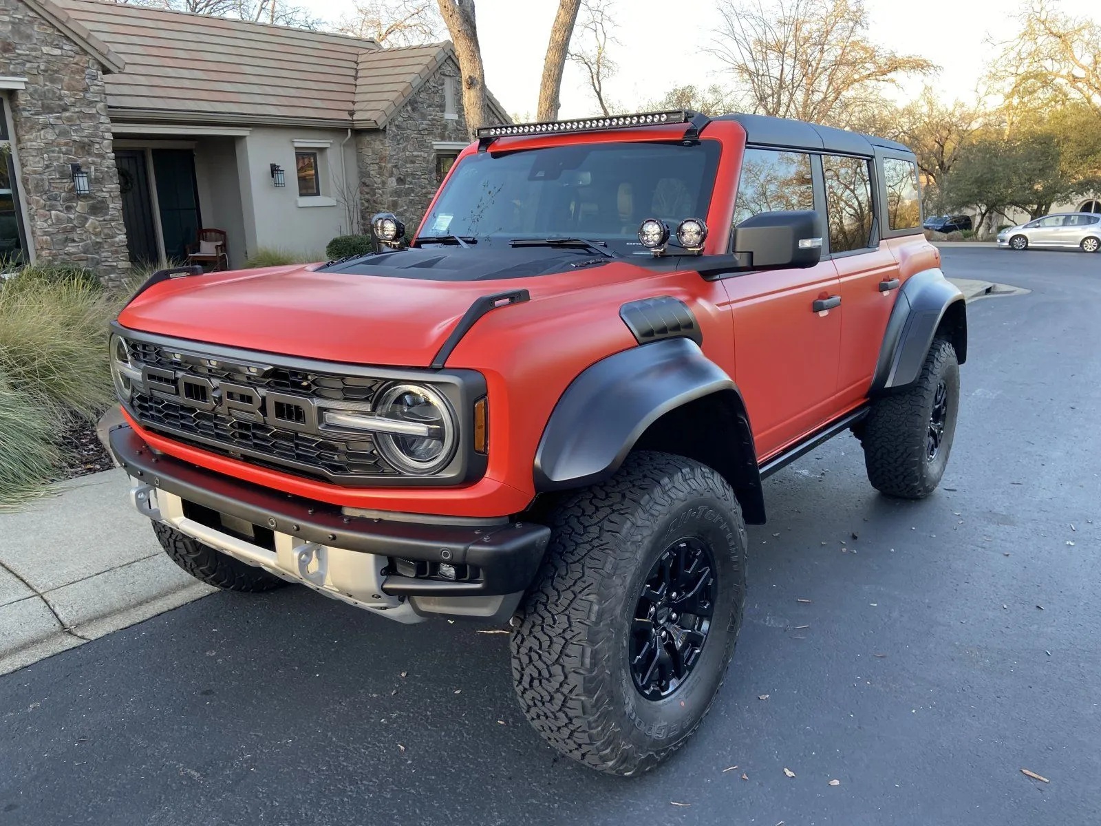

As I make my around my truck, I’ve found a couple of pet peeves (short upfitter wiring, inaccessible end cap bolts, and inconvenient for me parking brake switch) but Overall Ford nailed it on the Raptor. The side steps are a good example.
it took me less than 5 minutes by myself to gather tools, remove the steps and store them. Impact driver, Torx bit, and remove 6 bolts on each side. After removing all bolts the boards continue to hang securely on two pins. Slide the boards back half an inch or so and then pull out to free them. Very easy one man operation.
Very nice that Ford thought this through from perspective of one person removal. This will come in handy as I’m leaving for a trail and rember at the last minute I left my steps on. 5 minutes and I’m on the road.
looks nice without the steps too

I am glad to hear that the one person removal advertised actually works as stated. Three questions: What is an impact driver? Does the Raptor come with the required tools to remove the steps? And how is it getting in and out while the steps are off? Obviously it will be a stretch because of the height, but just wondering what your experience has been like. Lastly, beautiful mods to the paint!

I noticed your fender gills/vents are black not body color looks good, is that something you did yourself?
Not me, my stealth ppf installer did it with black vinyl. the Vents pop right off easily though, but getting it wrapped properly over the gills looks like a challenge to me (especially with no experience or proper tools).
But cheap to get a little vinyl and easy to remove if it doesn’t look as good as desired.

I want to do the same, but didn't know of those things "pop" off...my plan is to plasti dip as it's easier to cover odd shapes like the vent covers....looks great on yours! I have CO as well.....
I would recommend the black PPF wrap as John had done. A PPF installer won't have any problem wrapping them and it will be much easier to remove and restore back to original at a later date.
