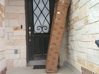

Pretty sure it's the bull bar sitting on my front porch, LOL. Fed Ex is just horrible these days. Was supposed to be delivered yesterday and today's notice said between 2 and 4pm. They showed up at 9:30am.
At least it’s not folded in half!
But it does look like it was shipped by Air Drop! 🫣
Fortunately highly unlikely broke and I expect JCR packed it expecting the worst.
Just got back from my window tint appointment. Looks like UPS had to tape it back up so I'm not expecting there's ANY hardware or loose components inside the box. Won't get a chance to open it for a few more hours.
Despite the box being in poor shape, the bar appears to be fine. JCR also taped the fasteners to the bar so they weren't just floating around inside the box. Good on them. Will try to get it installed tomorrow if I have time.
