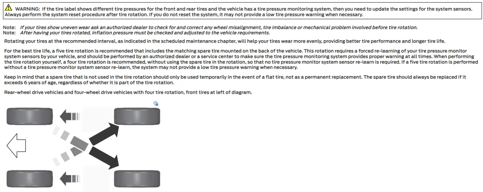

Here's the recommendation from the Owners Manual (online). My dumb question is whether the spare already has a TPMS sensor installed? The manual mentions resetting the system but no instructions on how to accomplish this. I suspect it's a full system reset (which resets all personal settings) but hoping it's not that broad.
The spare had a TPMS installed on mine. Also connects automatically once the spare is swapped in.
Correct, tpms in all 5 tires. I swapped my original spare with one of the other 4 after having roadforce balance checked and found the spare to be perfect. Once I drove a few miles it auto learned. Maybe someday the system will also read the spare tpms.
